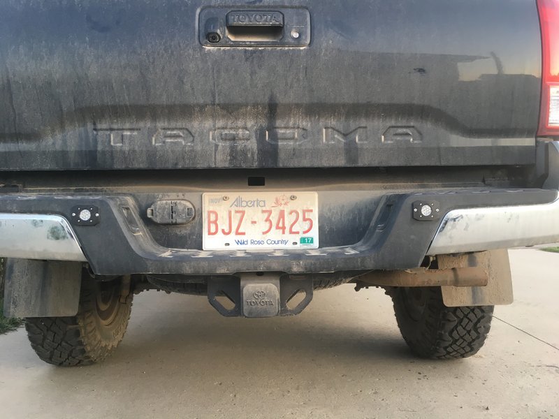

    I have them on both sides.
    Install was easy. The location I chose no metal was trimmed or removed and you can still access license plate bulbs.

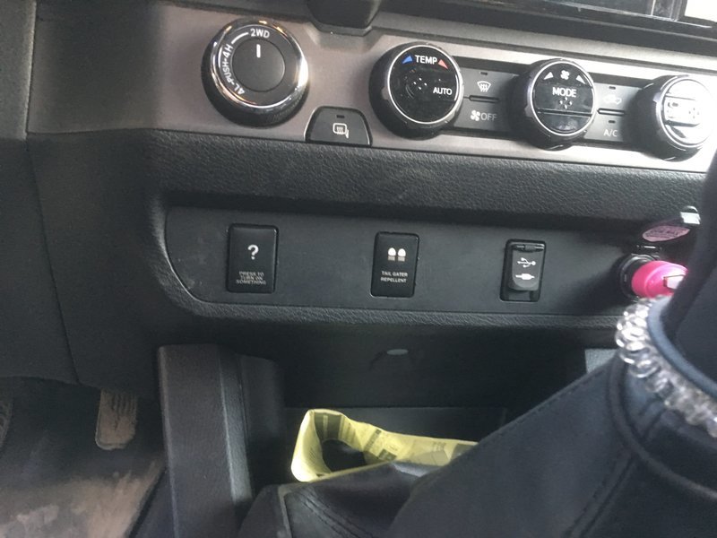

    I wired to a separate FJ switch
    Read my post #15 and #20

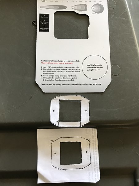

    Any of y'all had any experience putting flush mount pods in the rear bumper of a 12-15 model? I like the idea of them but the fact that it's a steel bumper has me scared to cut into it.

    how big of a hole did you drill? looks like 1"?

    25 Tundra TRD pro
    I cut out a 1.4" square. The install calls for a 1.75" hole saw.

  17. May 5, 2017 at 7:51 AM

    Here's the template I made.
    Here's the pic where I got the 1.4"x1.4" cutout.
    Finally got these installed. Went with the diffused version, very happy with the end result.
