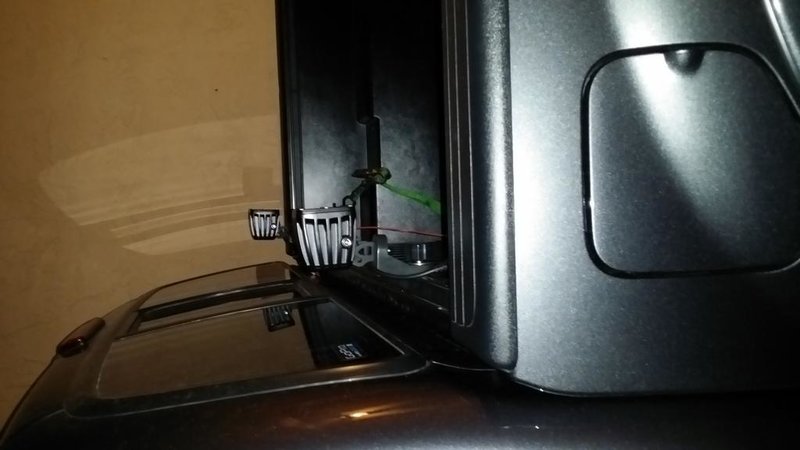

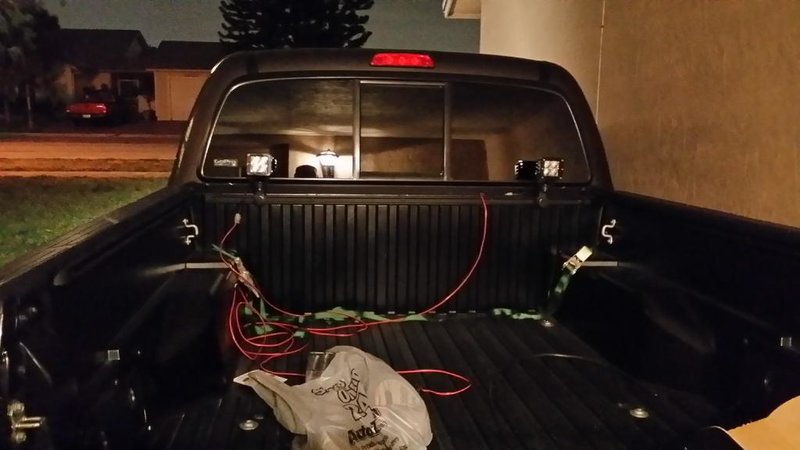

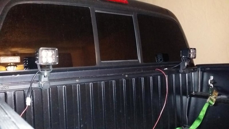

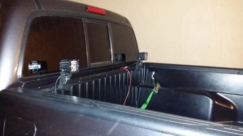

    here are the pics to show where I am mounting them

    Rigid makes a 1 meter extension (40197) but, you could go to an auto parts store and pick up some 14 gauge wire and make it as long as you want.

    I'd recommend that. Wires cheap. Wires wire.

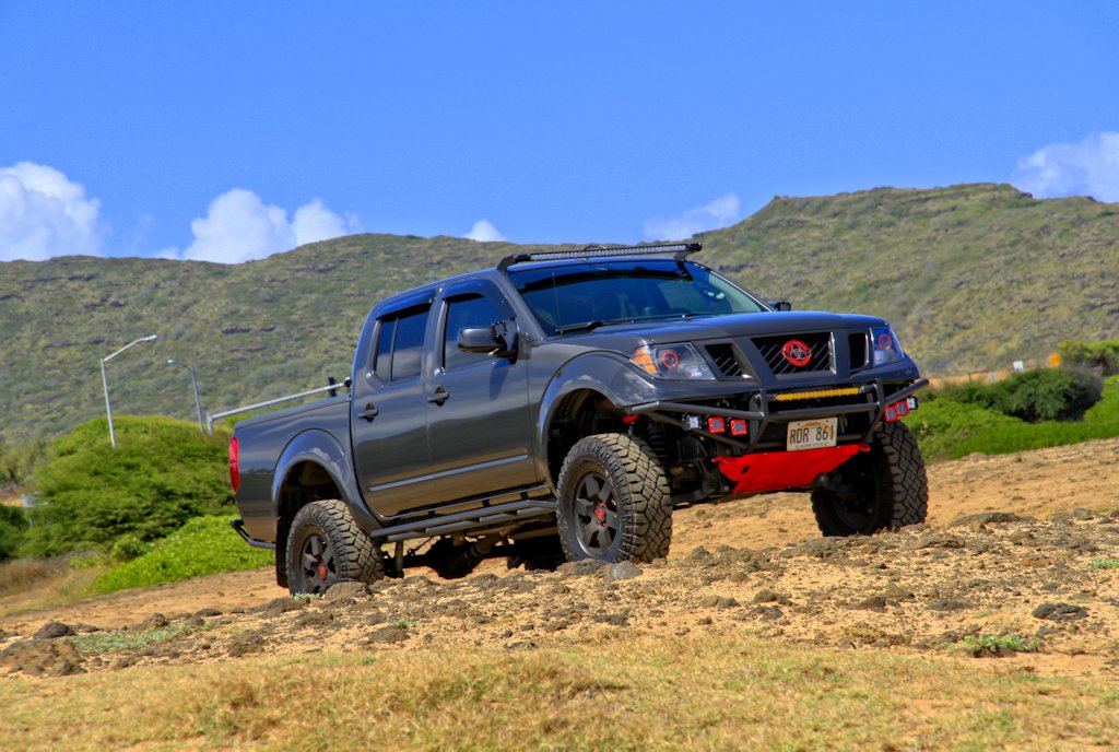

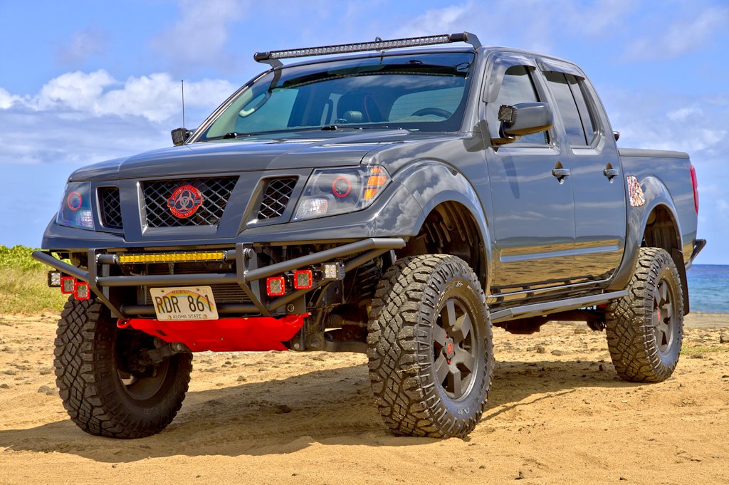

    These are mostly up to date. I moved the hyperspots from the mirrors to the bumper, and stole the diffused Dually's from my bed for the mirrors. So now it's 8 on the bumper, and 2 on the mirrors. Plus the 20" and 40" SR's. Getting ready for upgrade the 20" SR for an SR2! Then I'm going to swap the diffused Dually's in the rear for some Diffused SR's pretty soon.
    Last count before I swapped 6 regular Dually spots for hyperspots I was at 67,xxx raw lumens including the retrofits.

    xmods, you running a bigger alternator?

    Nope, that's the beauty of LED's. Idle at 14.2v (~625 rpm) with a slight modification to the stock alternator control circuit, and only drops to 13.8v with all of the lights on! And as soon as it is above ~1,000rpm its back to full power. Way back when I had Halognes it would drop down to 11.8v when all of them were on, and the HIDs would go to 12.4v. Only LED's from here on out lol
