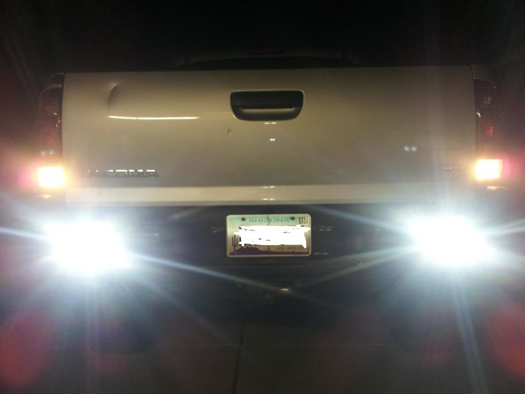

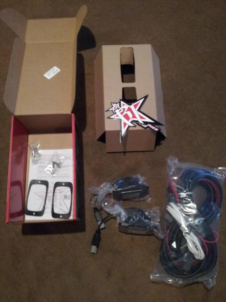

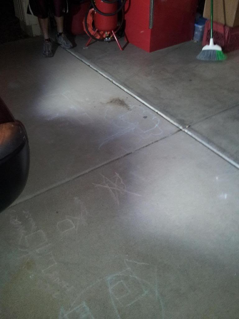

    The last time I was wheeling in the dark I really could have used more light when backing up. So I wanted a clean, low profile solution, and this was the best option that I came across: http://www.rigidindustries.com/SR-M-Flush-Mt-Back-Up-Light-Kit-Diffused-p/98001.htm
    I didn't install the wiring harness and switch, and instead just tapped into the factory reverse light wiring. The biggest issue during install was the paper template Rigid provides for cutting out the opening for these lights isn't sized correctly (too small), and so if you use it you'll end up having to do a bunch of extra cutting and trimming to get the lights to fit. So instead use one of the rubber gaskets that's included with the kit for your template instead "thumbsup"
    It's definitely pricey for what it is and does, but it does work really well. I'll make sure to post some more pictures of the finished product in the daylight tomorrow.

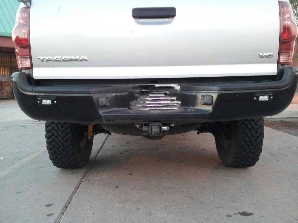

    Do you have a pic of them off and just installed?

    Damn that's clean.

    Looks great OP

    Is that a factor 55 hitchlink i see?

    No its a cheapo. I've got a pro link on the winch though ;-)
