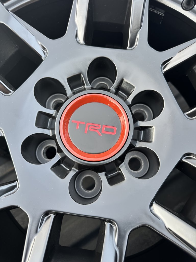

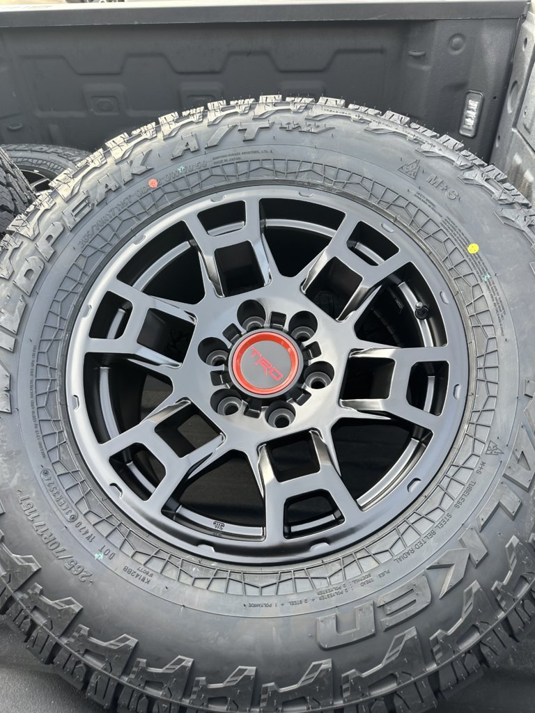

    Thanks everyone for your advice! Just picked these guys up yesterday.
