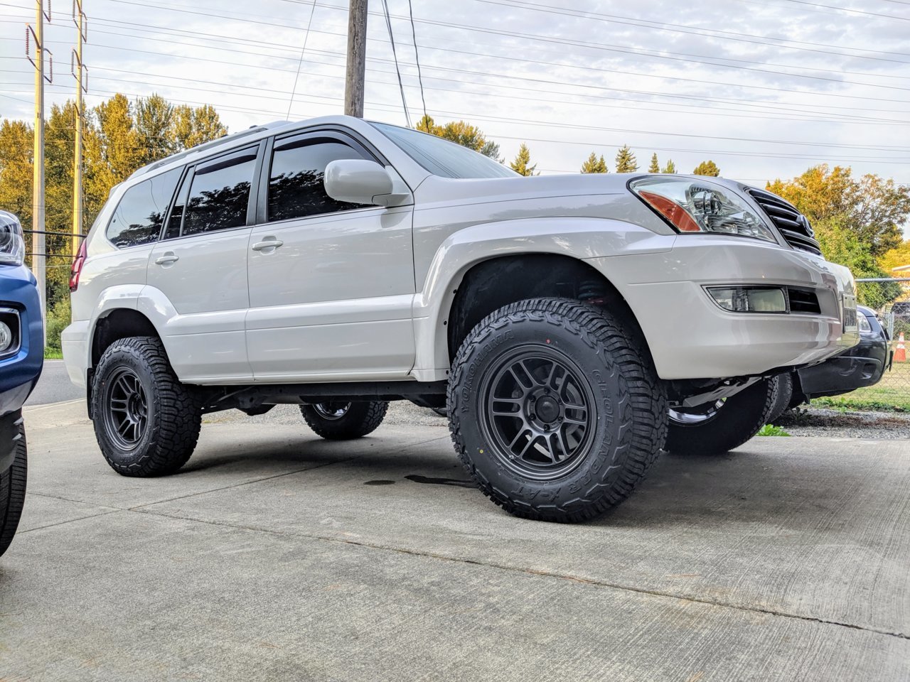

    275/70/18 on 18x9 wheel. These tires are only spec'd up to an 8.5" wheel per the manufacturer. I wouldn't hesitate to go a half inch over spec.
