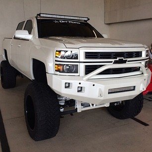

    -25 offset wow! that's a really beefy stance my friend! :rolleyes: all kidding aside you should have no issues with 265's clearing the UCA's and cab mount...With my set up...17x9 with -12 offset 285/70/17's with 3"lift I had to remove the front flaps...Minimal rubbing in reverse at full lock which I took care of by pushing back the front liner and securing them...no cmc or trimming required...
