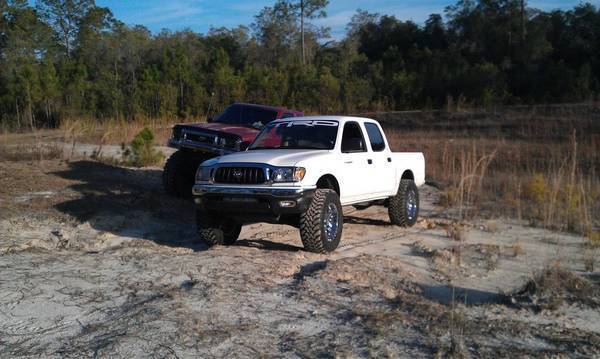

    Hey guys, looking to buy some 33 12.5's for my truck and i'm thinking i need to go up in size from my stock rims. do you guys recommend i stick with 15's or go up and also how wide should i go in rims?
    …. just got off a quick call with 4wheel parts and they guy told me I can't run 15's because they won't clear the brake calibers and i can't even run steel 16's without a spacer and i would have to run aluminum. how true is that? I thought a lot of people were running these.
    rim advice (black) for a white 03 extra cab? don't like over the top. i was going to go with pro comp 97's with the holes.

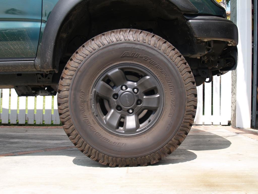

    '99 Tacoma, 33 x 12.50's on stock rims. 2.5 inch spacer lift. I used 1.5 inch wheel spacers all around but they probably would have fit just fine without them. Just wanted to have plenty of clearance for snow chains if needed. Daily driven and no issues with this setup after 10 months of being lifted.
    I think the narrow rim thing with 12.50's is a bunch of BS made up to sell more rims, probably by 4 wheel parts. I got the same story when buying tires for my FJ40 years ago. I just bought the tires and took them to Les Schwab to be mounted as they would not do it.
    On that I run 35 x 12.50's on old school Toyota 7 inch rims. Wheeled the crap out of them at low PSI many times and have had no bead issues at all in the last 10 years. If anything I have found it keeps a tighter bead at low pressures than with wider rims plus it seems to keep dirt and crap out of the bead area better. Good luck! :cool:

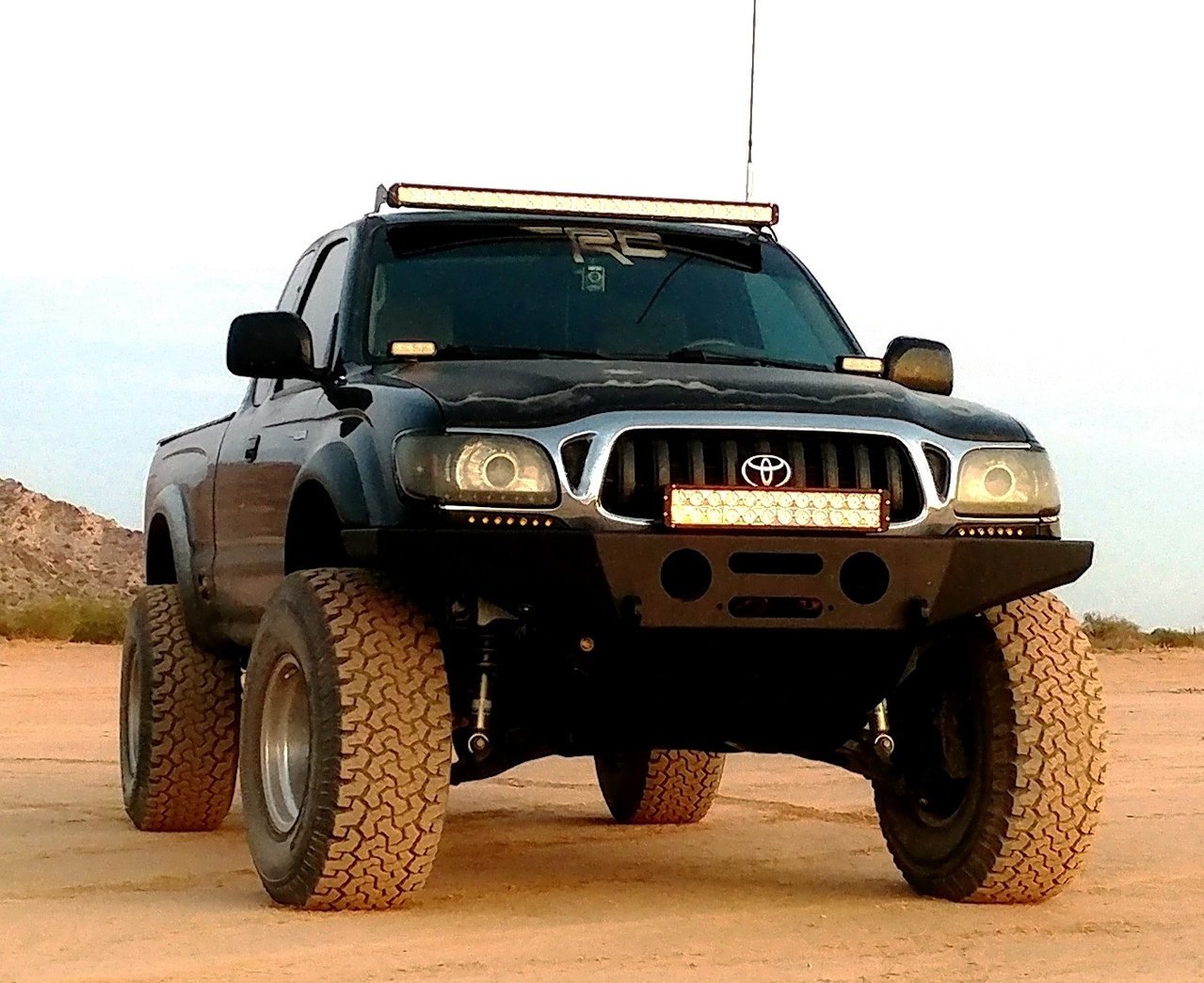

    4x4parts dont know shit. When I tried ordering my Billy's from them, they said they were never made for my truck :jerkoff:
    15 inch steal wheels. 33x12.5 and never looking back :rolleyes:
    well, sometimes i think i should have gone 15x10, but thats only sometimes...lol

    What is the back spacing on your steel wheels?

    That was 3.5 iirc. I am now running 15x10s. Check my build for more pics
