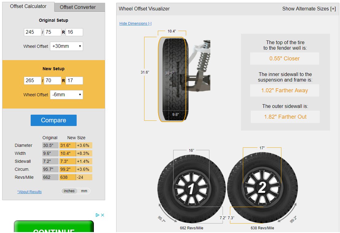

    Yea. Not so much the width as it is the backspace on the wheel. I’d suggest at least 4” or a negative offset

    So this is the offset calculator that I found and it actually looks perfect! As you can see, the negative offset on the wheels I want brings it away from the suspension just over an inch. This will allow for more clearance for the larger tires.
    Thanks for the help guys. If yall see anything wrong with this setup, let me know before I pull the trigger and buy them!

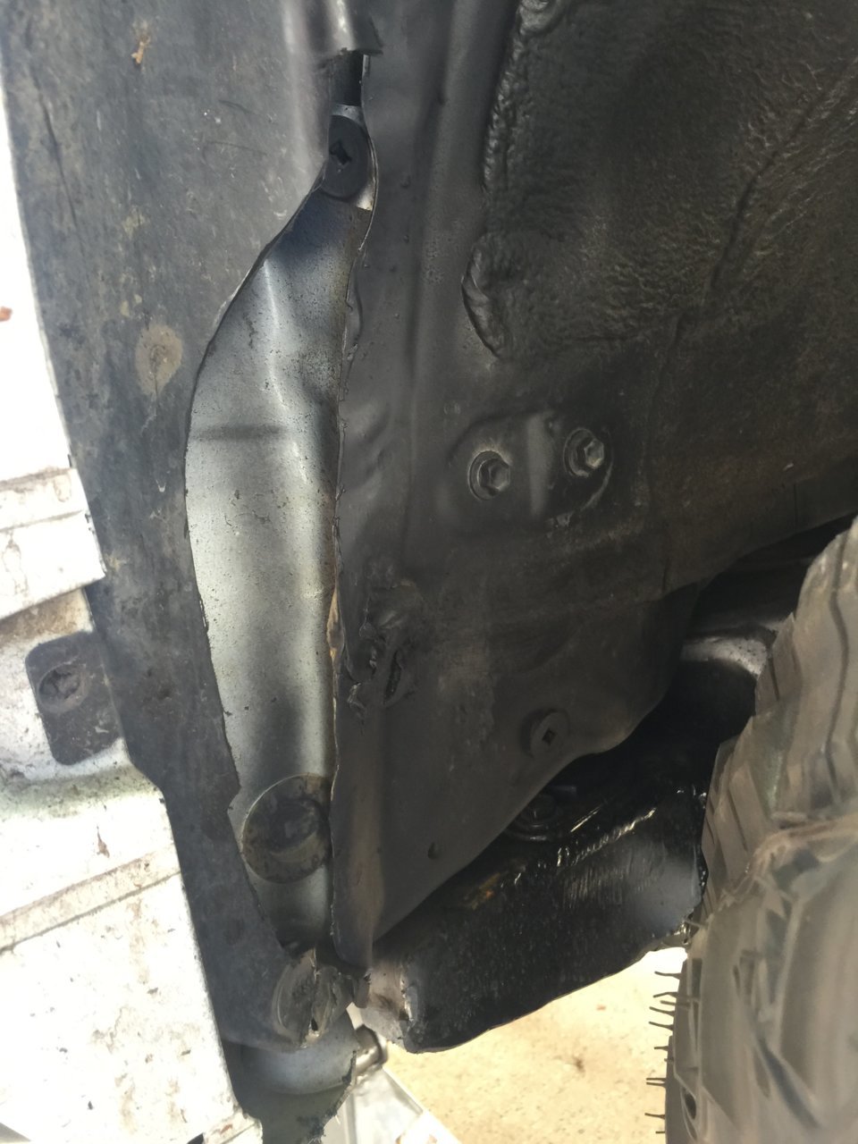

    If you do have to trim the fender liners, it can be done easily with a razor blade in a few minutes.

    Plastic trimmed and pinch weld beat in
