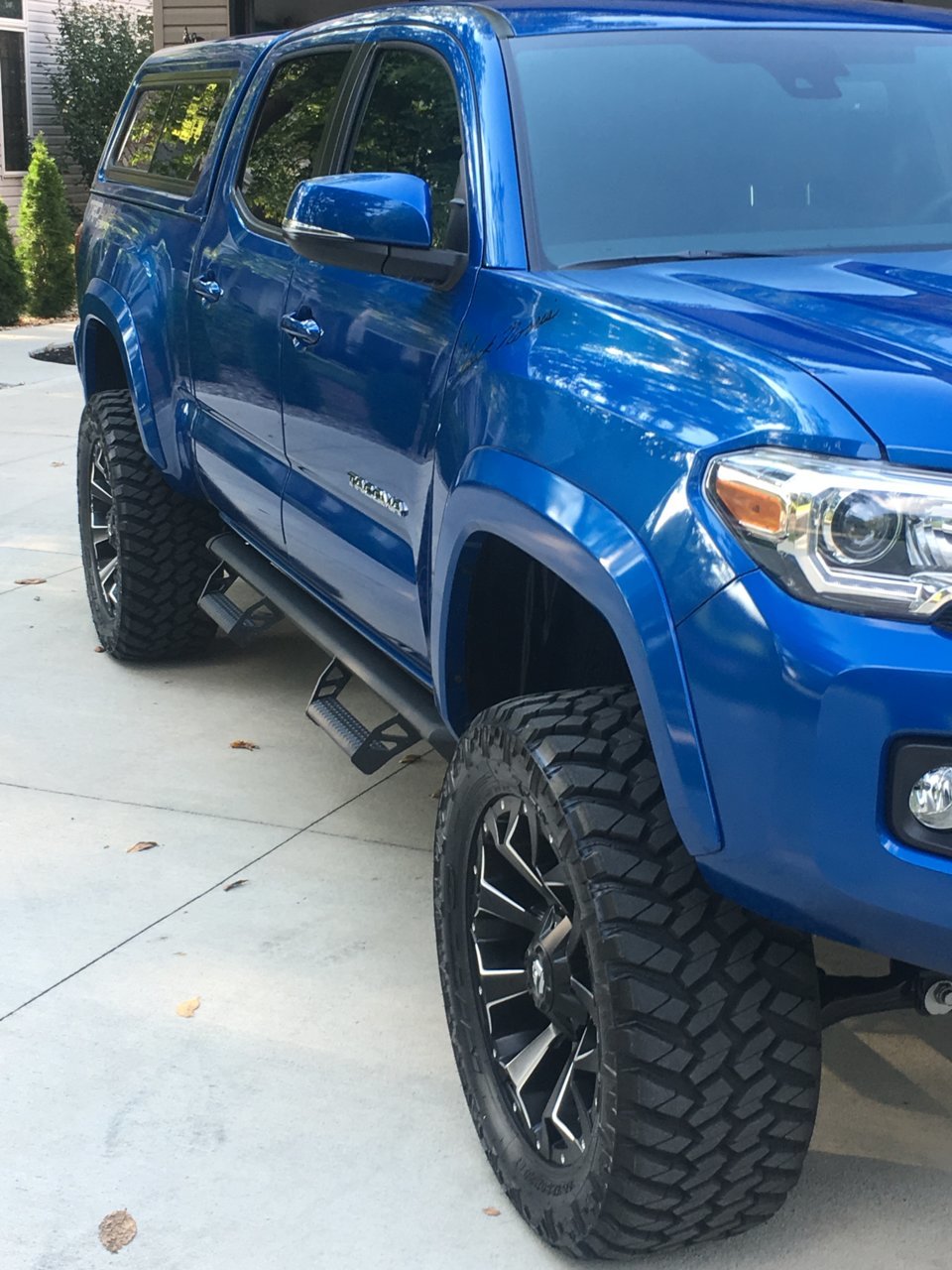

    I ran a 20 x 9 with 33” tires. +01mm offset. 4” lift. Looked great. Ran great.

    20 x 9 +01 offset
