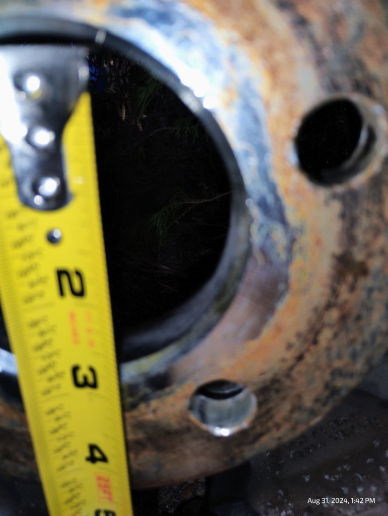

  6. Aug 31, 2024 at 5:22 PM
    HIdden 1
    HIdden 1 [OP] Well-Known Member
    Dec 9, 2023
    #439174
    78
    Thanks!
    Yep I'm gonna need those rings...

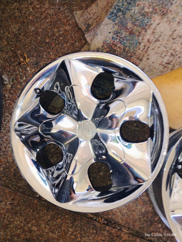

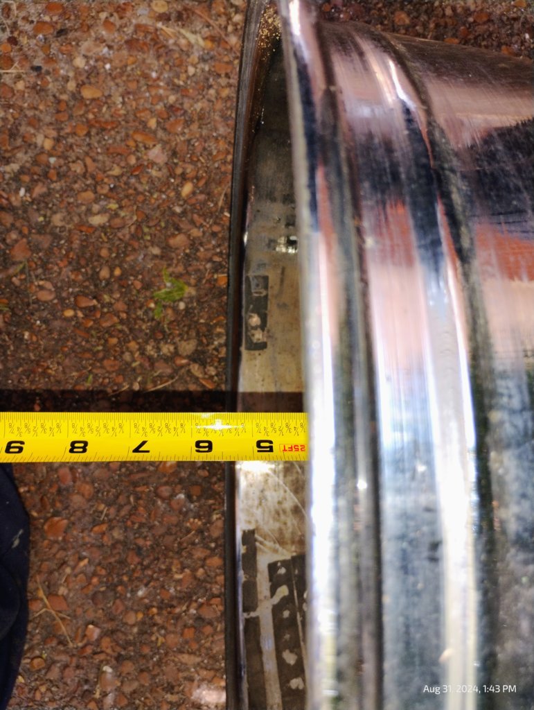

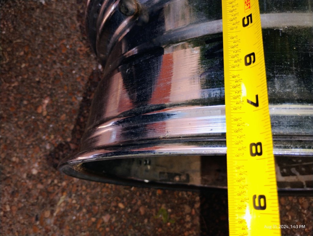

    Sure is tough to measure by tape..These came off a Nissan but not sure what year.
    How do I determine what rings to buy
    Is it ok if the 5 holes are a tad bigger thought they are exactly the same on size?
    An what about offset an lug type nuts?
    How do I determine size on rings I think they were off a Altima 06 ..
    See pics
    Again,thanks .

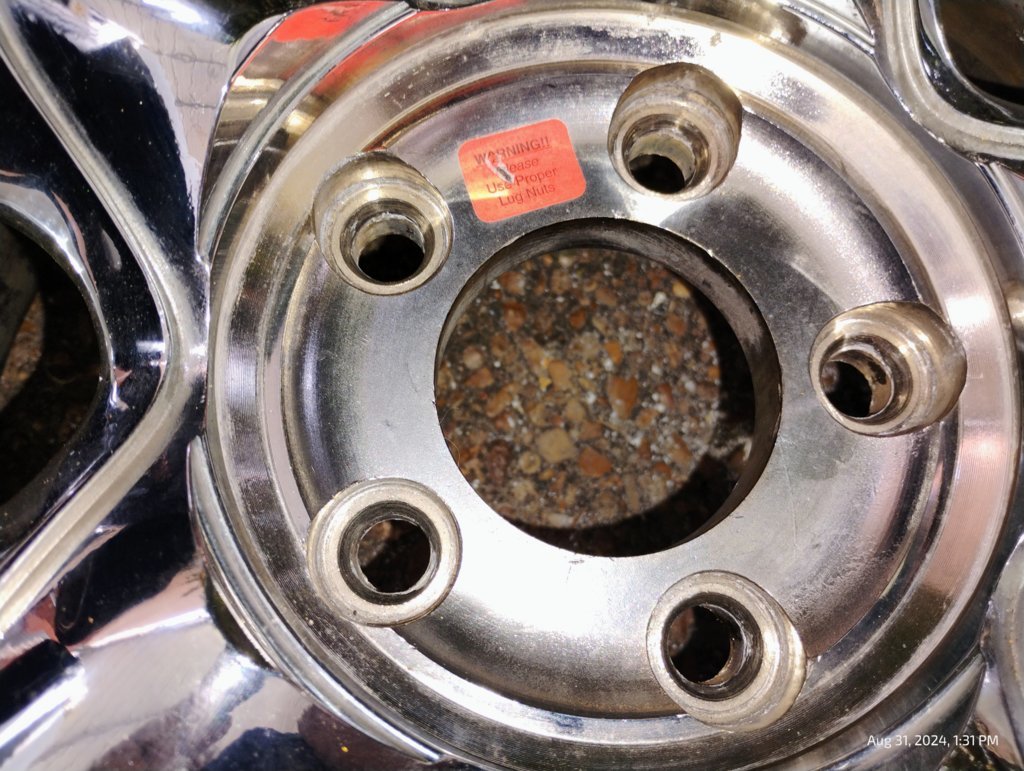

    78

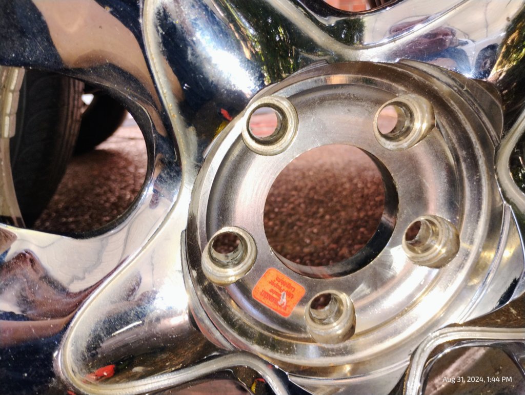

    Here are a few pics from inside ..Are these similar to what I'll need in pic?.

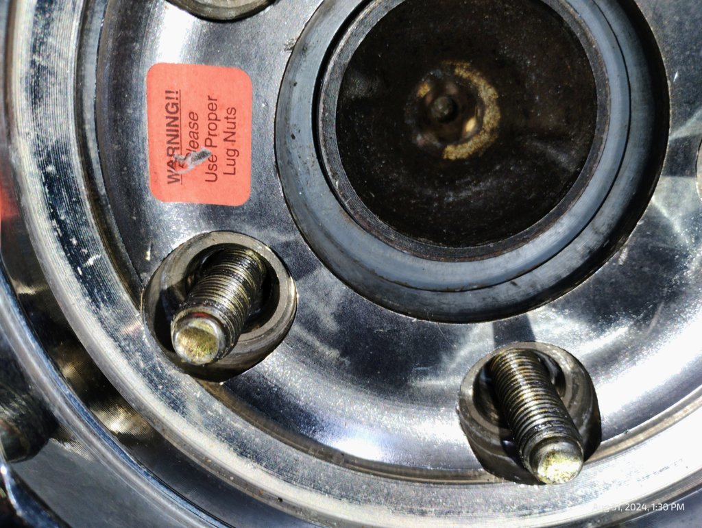

  8. Sep 1, 2024 at 3:10 PM
    HIdden 1
    Dec 9, 2023
    #439174
    78
    Would this be what I'd need .?
    I see taco is 60.1mm an Nissan Altima is 67.1?
    What's the offset of taco ..offset on Nissan is 45mm?
    WHEEL CONNECT Hub Centric Rings, 67.1 to 60.1 Set of 4, Aluminium Alloy Hubrings 60.1 to 67.1, O.D:67.1mm I.D 60.1mm. A
  9. Sep 2, 2024 at 11:30 AM
    gstodd
    gstodd Well-Known Member
    Jan 17, 2023
    #415649
    357
    2005 2wd base 5-lug
    If those are stock Altima wheels then yes those are the rings you'll want. Especially if the lug holes are slightly larger. I can't tell in the pictures what the lug seats look like but you want to make sure you use lug nuts that are designed for the type of lug seat you have. They almost look like mag lug seats but I can't tell for sure. AS for offset the stock steel wheels have a 34mm offset so depending on the new wheel width they may be sunk in further that the stock one. You also might possibly need spacers to clear at full lock. I need to run a set on mine since I have 20x8.5 wheels with a +48 offset.

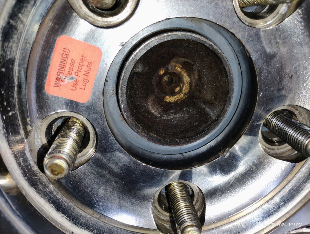

  10. Sep 3, 2024 at 7:54 AM
    HIdden 1
    Dec 9, 2023
    #439174
    78
    What do the spacers look like?
    So there's no issue or danger in running on these with that offset # that far off from the taco old offset? 34 to 45
    Here's another pic .
    Would I need those type lug with that flat taper like Honda's use a lot?
  11. Sep 3, 2024 at 10:28 AM
    gstodd
    Jan 17, 2023
    #415649
    357
    2005 2wd base 5-lug
    That may be correct lug nut but I can't tell from the pictures. Check this quick reference link on the main types of lug seats. I suspect it is the last one but the mating surface isn't clear enough to see in the pictures with the reflections.
    https://www.drivenproducts.com/blogs/wheel-and-wheel-accessory-terminology/seating-style
    AS far as running these wheels, no there is no danger in running them with that offset. The only issue you might run into is the tire rubbing the inside of the wheel well at full lock but with the width of the wheels I don't know if that will even happen. Mine do but my wheels look to be an inch wider and I'm running 255 tires on them.

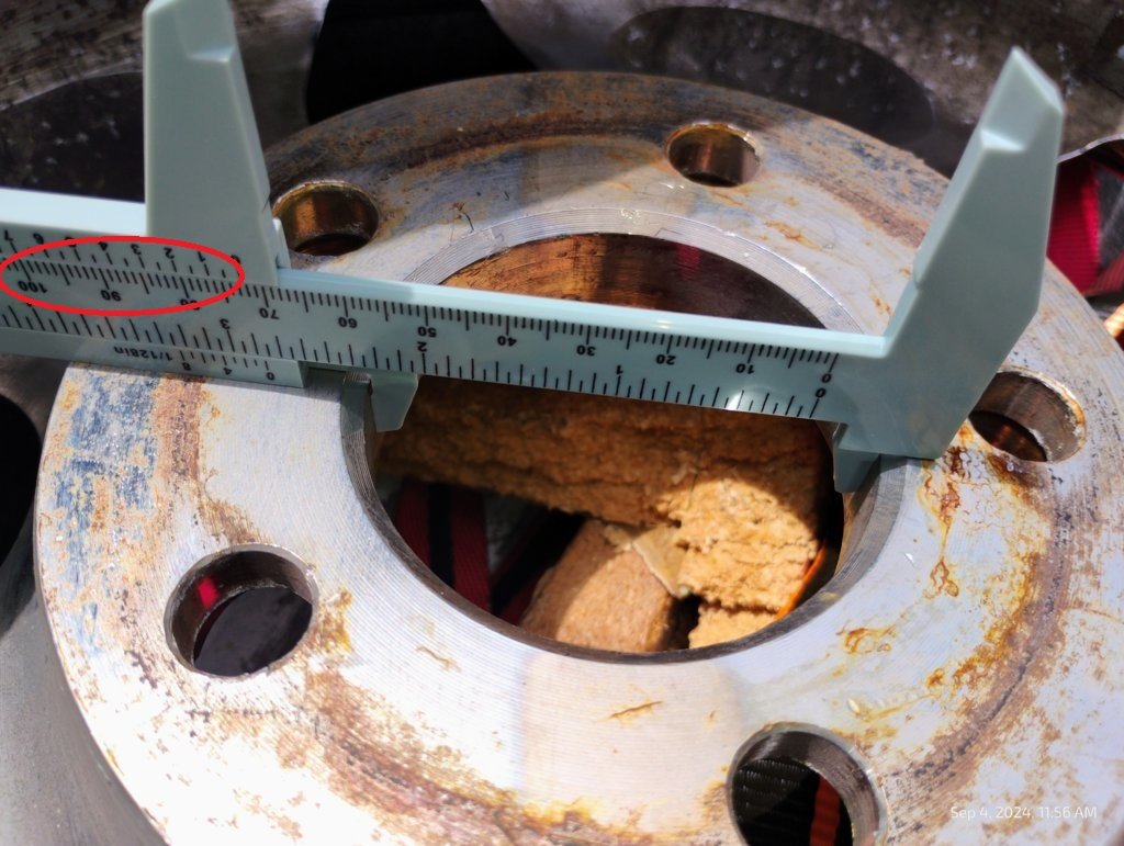

  12. Sep 4, 2024 at 11:07 AM
    HIdden 1
    Dec 9, 2023
    #439174
    78

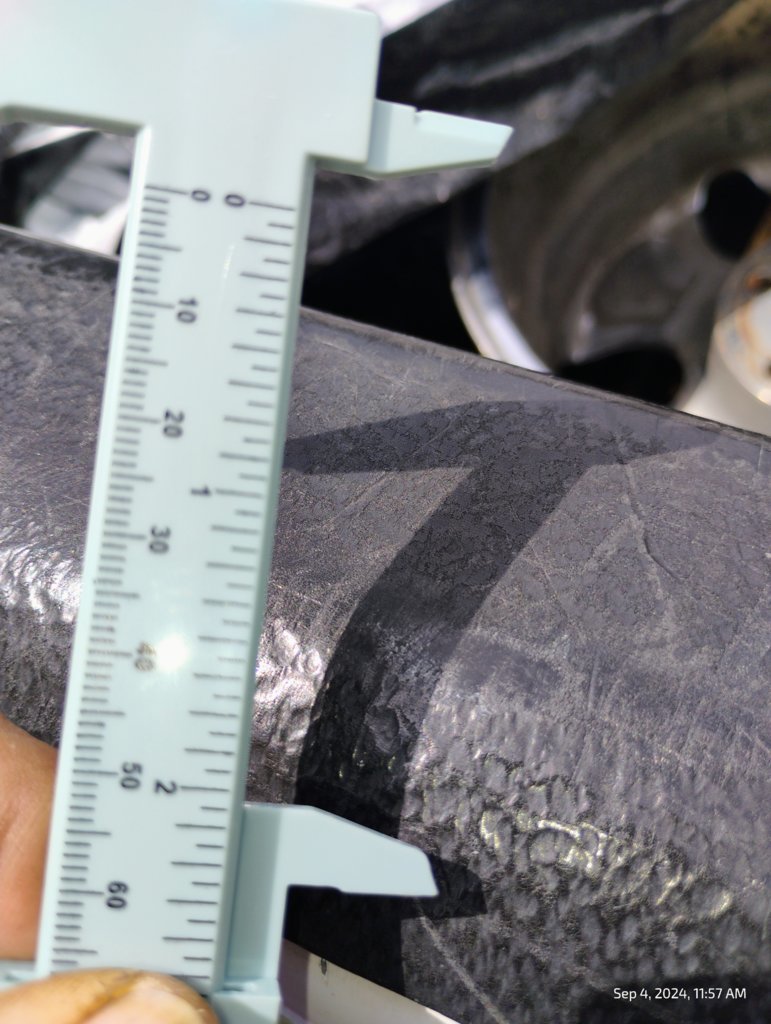

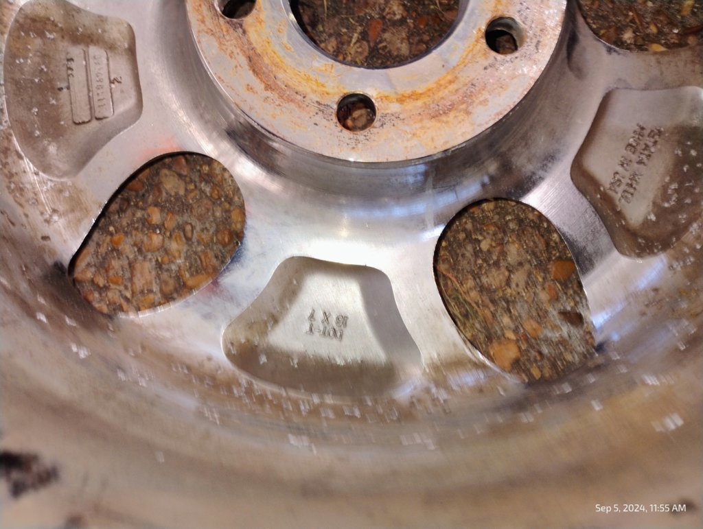

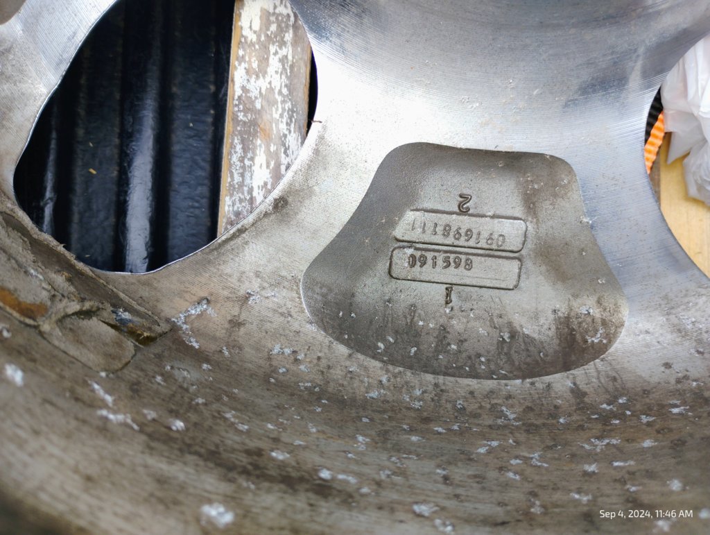

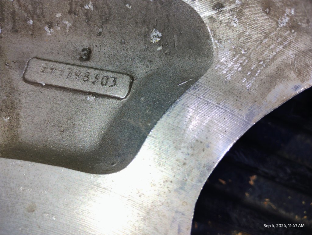

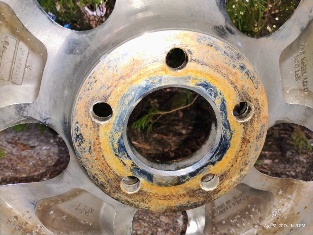

    found out these are NOT FACTORY Nissan rims...I found on the ground from ground to inside of bore it's 3 inches ..but no tire on it
    An found this on caliper..what is that in mm?
    I saw these # on the inside too but not sure how to track it ..
    Maybe a different offset?
  13. Sep 4, 2024 at 11:34 AM
    gstodd
    Jan 17, 2023
    #415649
    357
    2005 2wd base 5-lug
    Being aftermarket wheels I'd take bets on it being 70.1mm, that's sort of a standard for many companies. You can read it right off the caliper, it's 70.? Whichever number, in the circled section, lines up with a mark on the gauge is the ? after the decimal point.
    The stampings all seem production related, no specs in them.

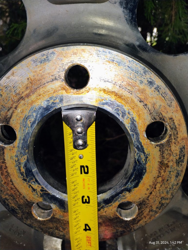

    It's very close to the 60.1 on hub pic ..going by the online chart an here.
    Looks to be 2.366" on Toyota bore .
    Looks so close on hub .
    Sorry I haven't used this tool in years ..would that digital one they have in oreileys be best way to get it?

  15. Sep 4, 2024 at 11:58 AM
    gstodd
    Jan 17, 2023
    #415649
    357
    2005 2wd base 5-lug
    It can't be 57, 58mm or 2.28". All of those numbers are less than 60.1 so the wheel wouldn't physically fit over the hub. That gap between the hub and the center bore of the wheel sure looks like it's right around 1/4". Looking at the calipers it actually looks like the inner bore of the wheel is 72.?, almost 73mm.
    You're not reading the calipers correctly. Here's a video that shows how to read it the correct way. It'll help make more sense of it.
    https://www.youtube.com/watch?v=8X5ONpM5GJw

    If I do the math correctly an look again at the measurements exactly it looks like I'd need to get rings that go from 60.1 to 68...found these online.
    I need to remeasure on other reading .for offset.

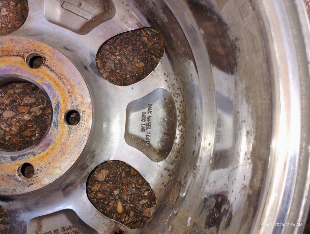

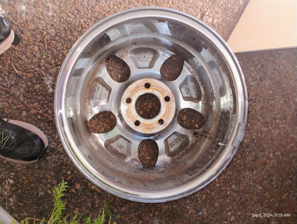

  19. Sep 5, 2024 at 12:07 PM
    #19
    HIdden 1
    Dec 9, 2023
    #439174
    78
    Here is some better pics .If the Toyota rim is on the ground with outside facing down an NO TIRE ,like mine, how many inches or mm from ground to inside of bore is it.. ?
    Found another marking inside rim also .
    Says what looks like DETATA WHLLL -OR MAYBE WHEEL
    With made in USA..
    An DoT 16x7..Does that mean it's 7 inches wide?
  20. Sep 5, 2024 at 12:30 PM
    #20
    gstodd
    Jan 17, 2023
    #415649
    357
    2005 2wd base 5-lug
    The last picture says the wheel is a 16 x 7.
    No idea what the mounting surface to the ground would be for the stock Toyota wheel. I do know the stock 5-lug steelies have an offset of +34. Here's an easy to follow video for measuring wheel offset so you can figure out what the new wheel offset is.
