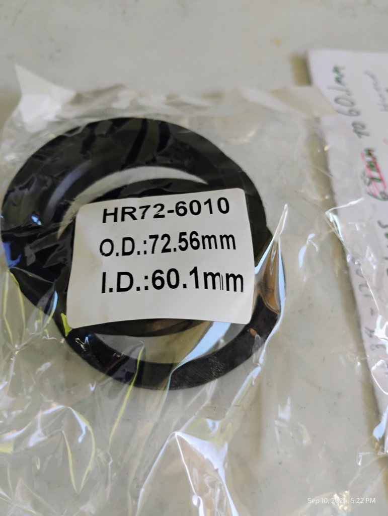

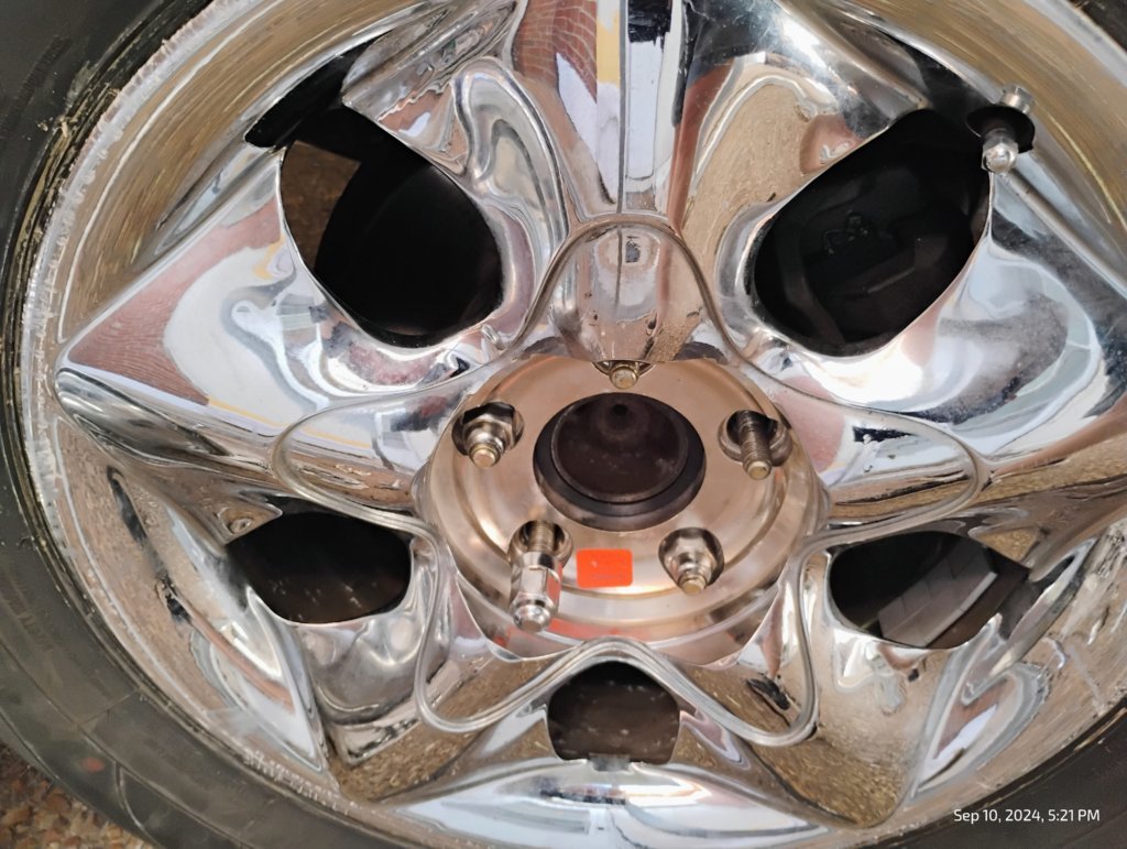

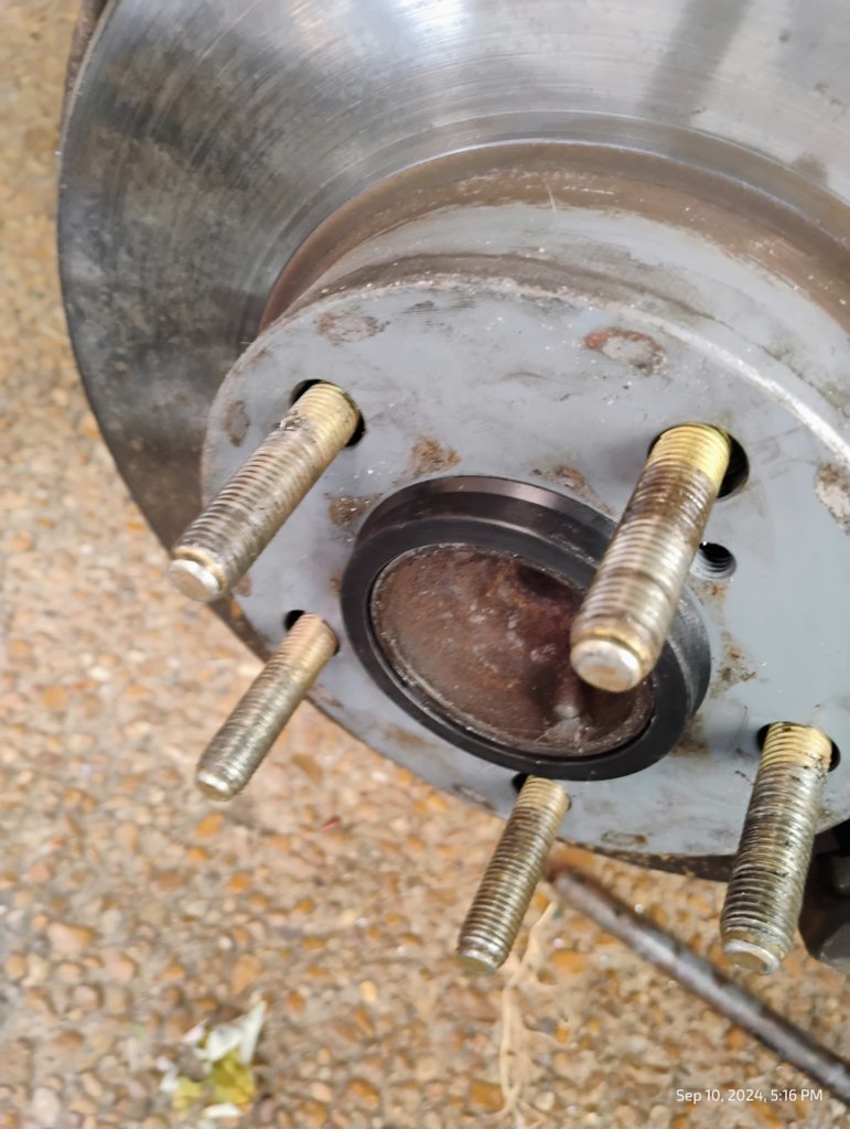

    Great news! Went to a tire specialty shop I know that sells custom wheels an they did the EXACT measuring an yes it fits snug with spacer ...Toyota offset measure 25 ..they measured it with their tools at 15-25 offset
    I need to decide weather to use long acorn type or another type on lugs..old short acorn.wont work..an they will be covered by the cap ....
    Should I look at anything else ? Besides how it does turning
    See pics..measures 72.56 on plastic hub ring,..Does it go on 1st then the rim as in last pic ?

    Yep, that's exactly how it goes on.

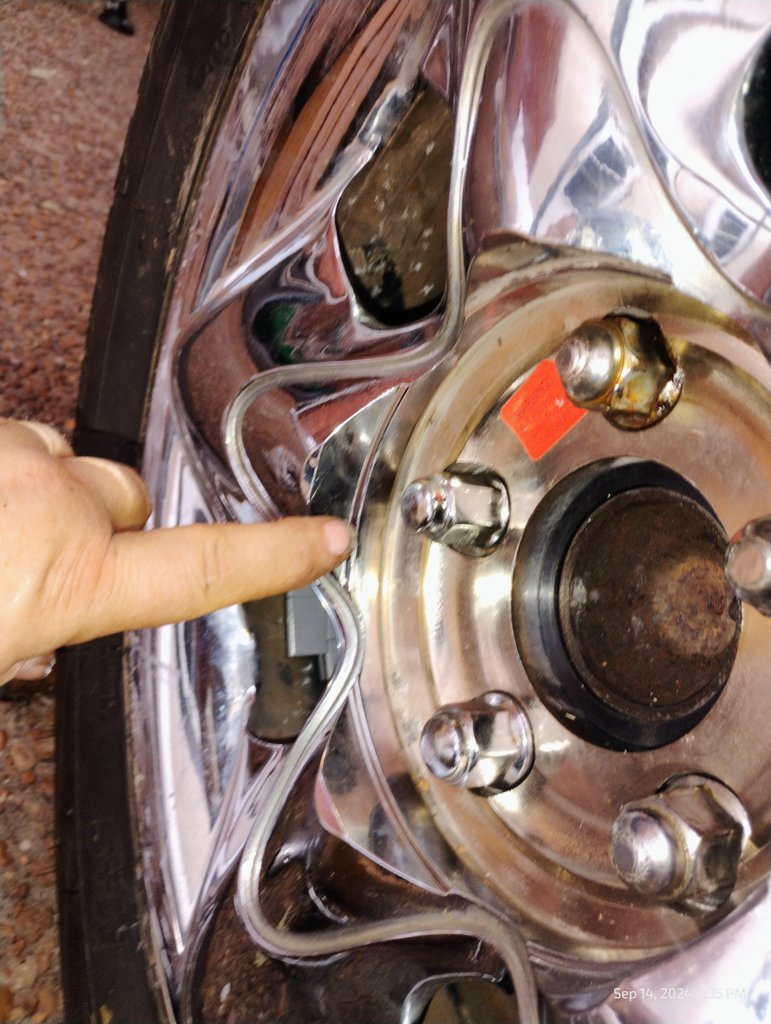

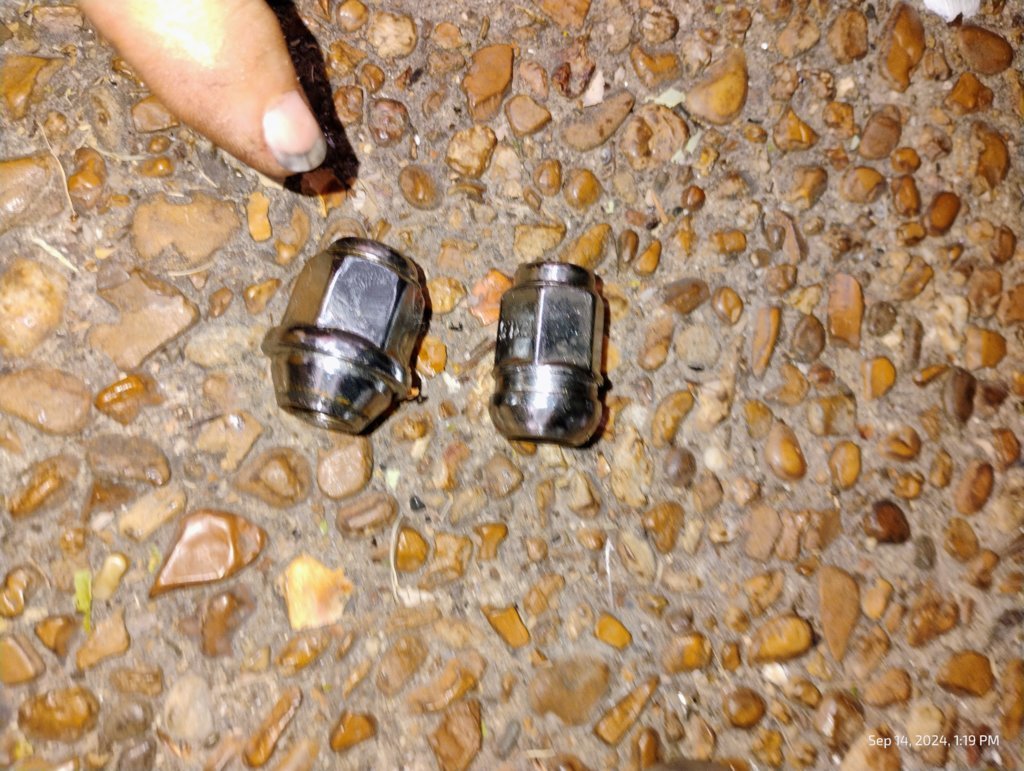

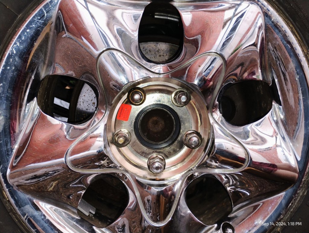

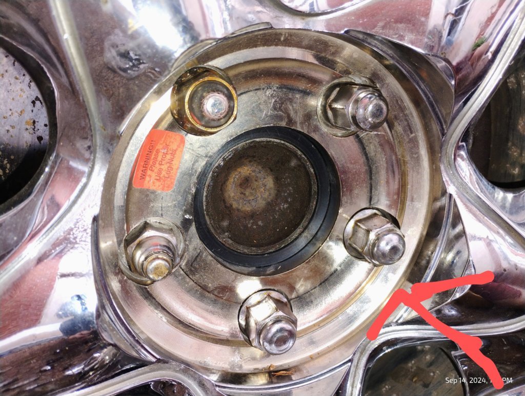

    Thanks .an am I better off with the fatter lug nuts vs the skinny ones so as to seat it better?
    I do get more turns with the skinnier one I'm pointing to on rim .. but less lip

    I can't tell from the photos what seat for the lugnuts those wheels require, but you need to.make sure you use the correct ones - mag, acorn, cone, whichever they are. The Tacoma is a hub-centric design, and with the very small size of your spacers, any slop or incorrect fit on the lugnuts is asking for catastrophic failure while you're driving.
