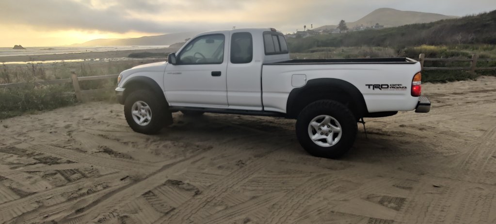

    Honestly, I still really like the "stock" alloy wheels from a TRD model. Sixteen-inch tires are very common, you retain the classic look, don't need to mess with offset, and they are relatively easy to find because everyone wants to replace them with shiny $350 rims. I have a spare set I picked up for $75 from a guy on Facebook Marketplace, so if I break one, it's no big deal. Use your savings to buy nice tires!

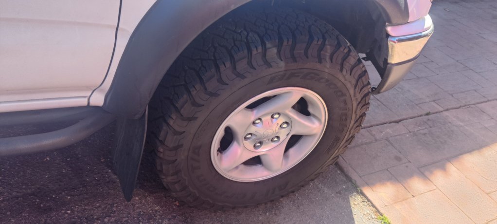

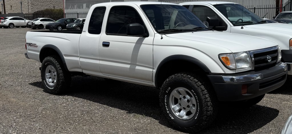

    I had my 15 inch OEM wheels refinished silver a few days ago by my mobile wheel repair guy. Mine were pretty badly corroded as well.
    EDIT, maybe corroded wasnt the right word, just worn after 25 years.

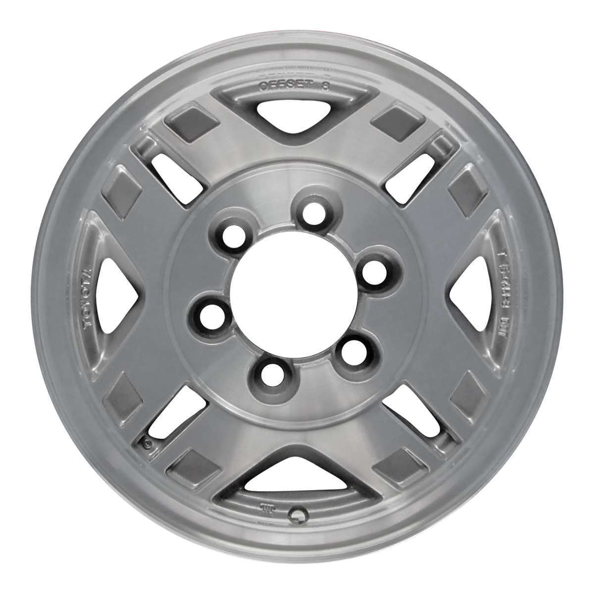

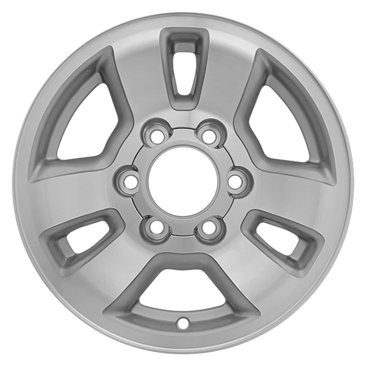

    15-inch rims were only used on Tacomas through the 2000 model year. Every Tacoma made since then has had 16+. Every 4Runner since 1996 has had 16+. Every Tundra and Sequoia ever has had 16".
    As far as alloy wheels go, there are really only two options commonly available for USDM 15" Toyota wheels: The double-tri-spoke used on early Tacomas (be careful with this one, as a 16" version of the same design was also used on 3rd-gen 4Runners) and the double-quad-spoke used on pre-Tacoma pickups, 1st/2nd gen 4Runners, and some Land Cruisers.
    If you're okay with steelies, aftermarket wheels, or non-USDM imported wheels you get a lot more options, but they still aren't common.

    Those are just pictures I grabbed from random places online. They're probably refurbs, not replicas, but idk. I know there are a handful of places to buy used/remanufactured rims but I don't have experiences with any of them so I can't recommend any specific place.
