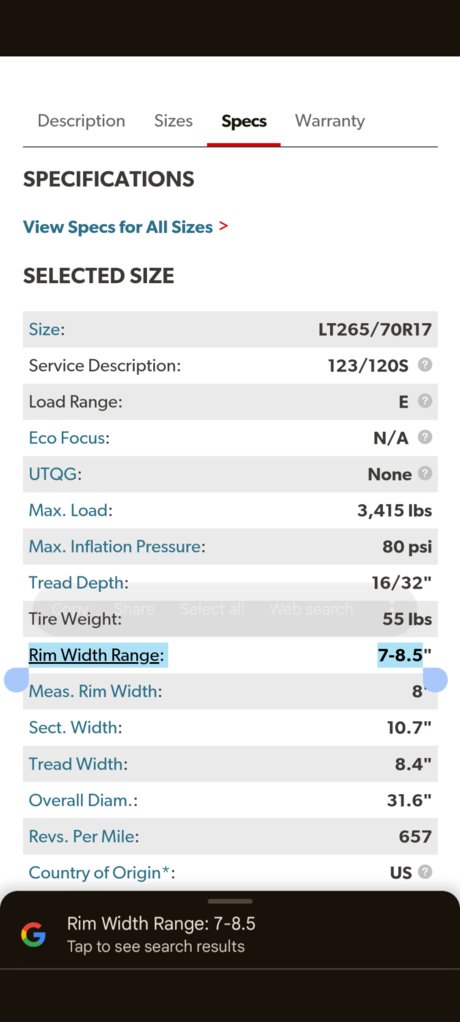

    tactrac
    tactrac [OP] Well-Known Member
    Aug 12, 2024
    #454994
    93
    2024 TRD Off-Road
  6. Sep 17, 2024 at 3:24 AM
    Schlappesepple
    Schlappesepple Well-Known Member
    Jan 9, 2017
    #206998
    908
    Joe
    2020 4Runner ORP
    tactrac[OP] likes this.
