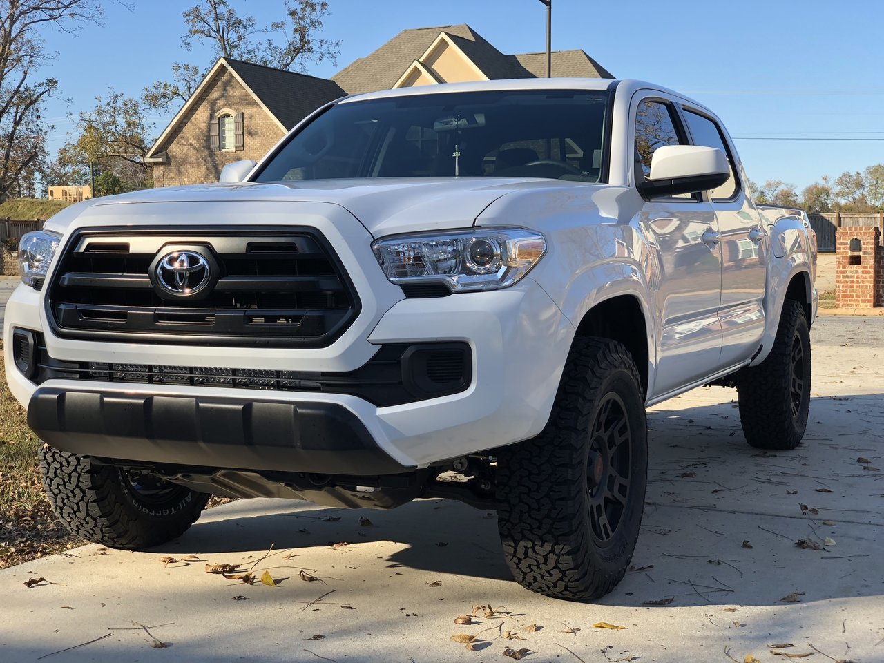

    2017 White Tacoma SR DCSB
    I did 17" TRD PRO Wheels with 265/70/17 (Biggest i can fit with stock suspension without cutting) BFG KO2 tires
