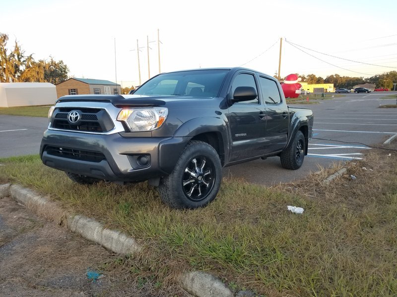

    2014 SR5 dble cab 5 lug
    17x9 mayhem wheels 30" tires, no rub.
    17x9 18mm offset on 245/65r17
    Stock suspension
    Black box untouched
