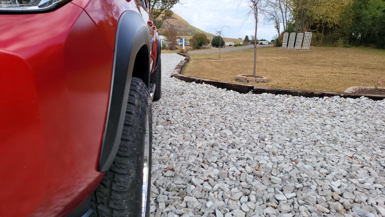

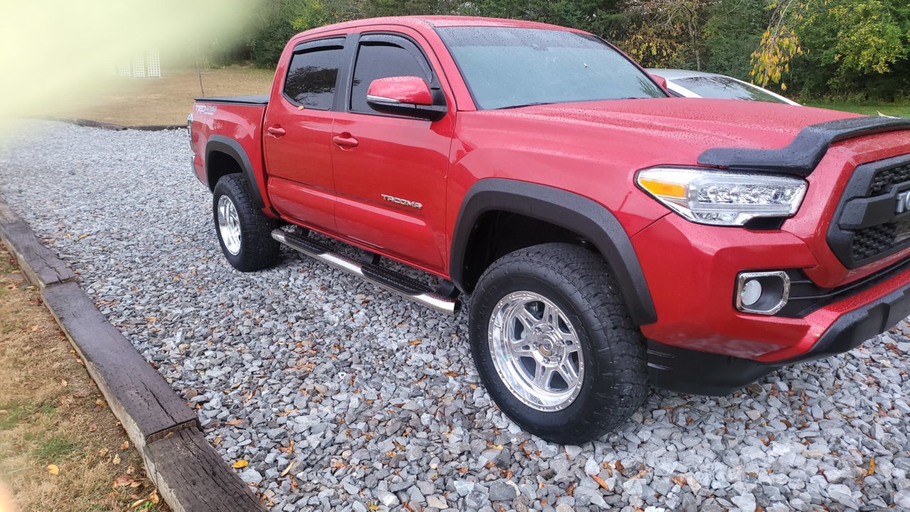

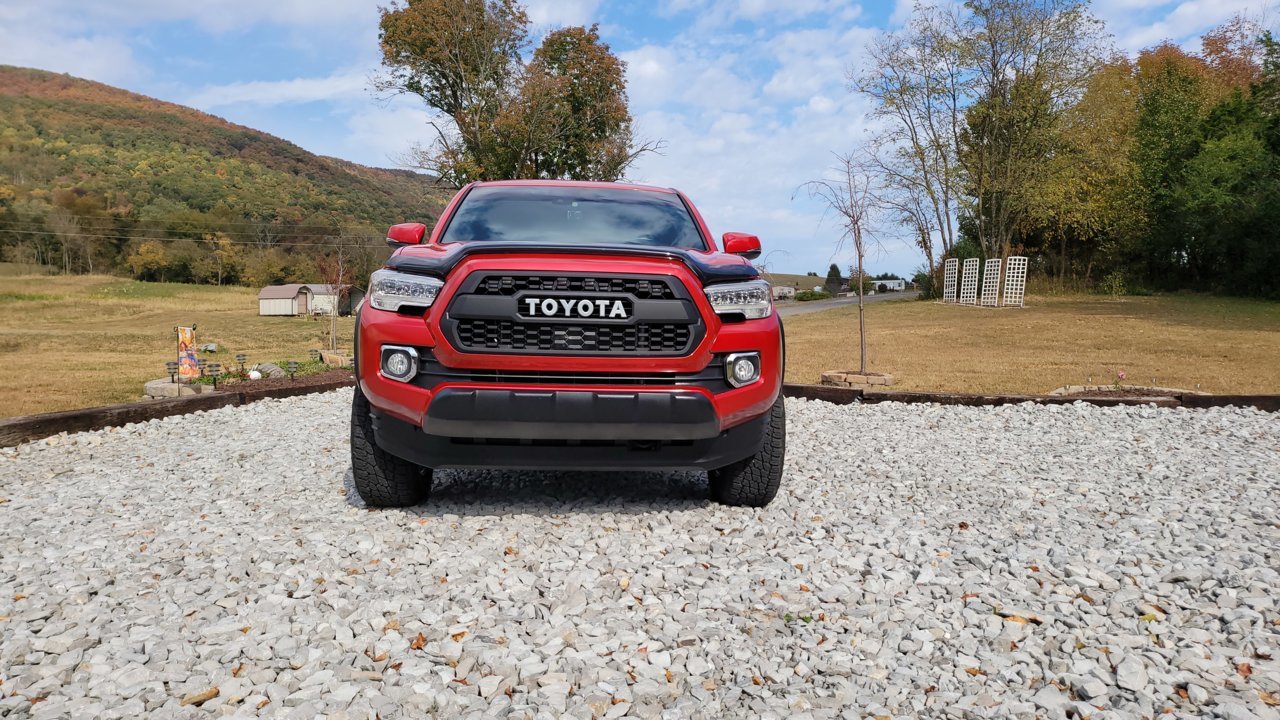

    I went with aftermarket RENEGADE 6 POLISHED 17x9 0-offset with 265/65r17 Nitto Grapplers..ABSOLUTELY NO RUBBING AT ALL..(the 265/65r17 is exact same Size as the factory 265/70r16)
    It makes for a wider stance with about an 1" poke outside of the fender wells....
    The only thing I dislike ..is it will throw mud, water , gravel on the side of your truck....I've ordered a set on mudflaps hoping this will help
    Here's some pictures 20221015_151400.jpg 20221015_151451.jpg 20221015_172648.jpg
