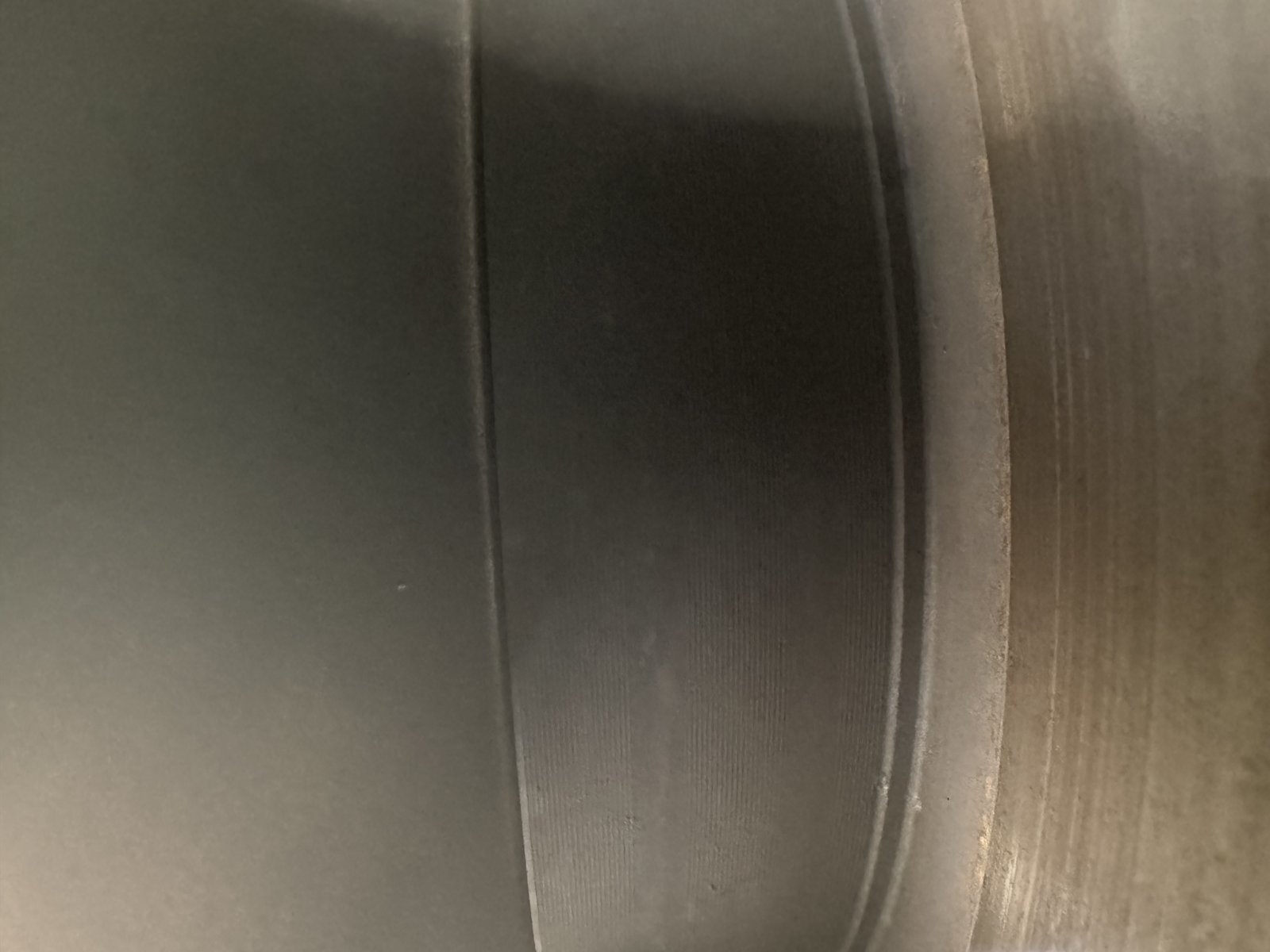

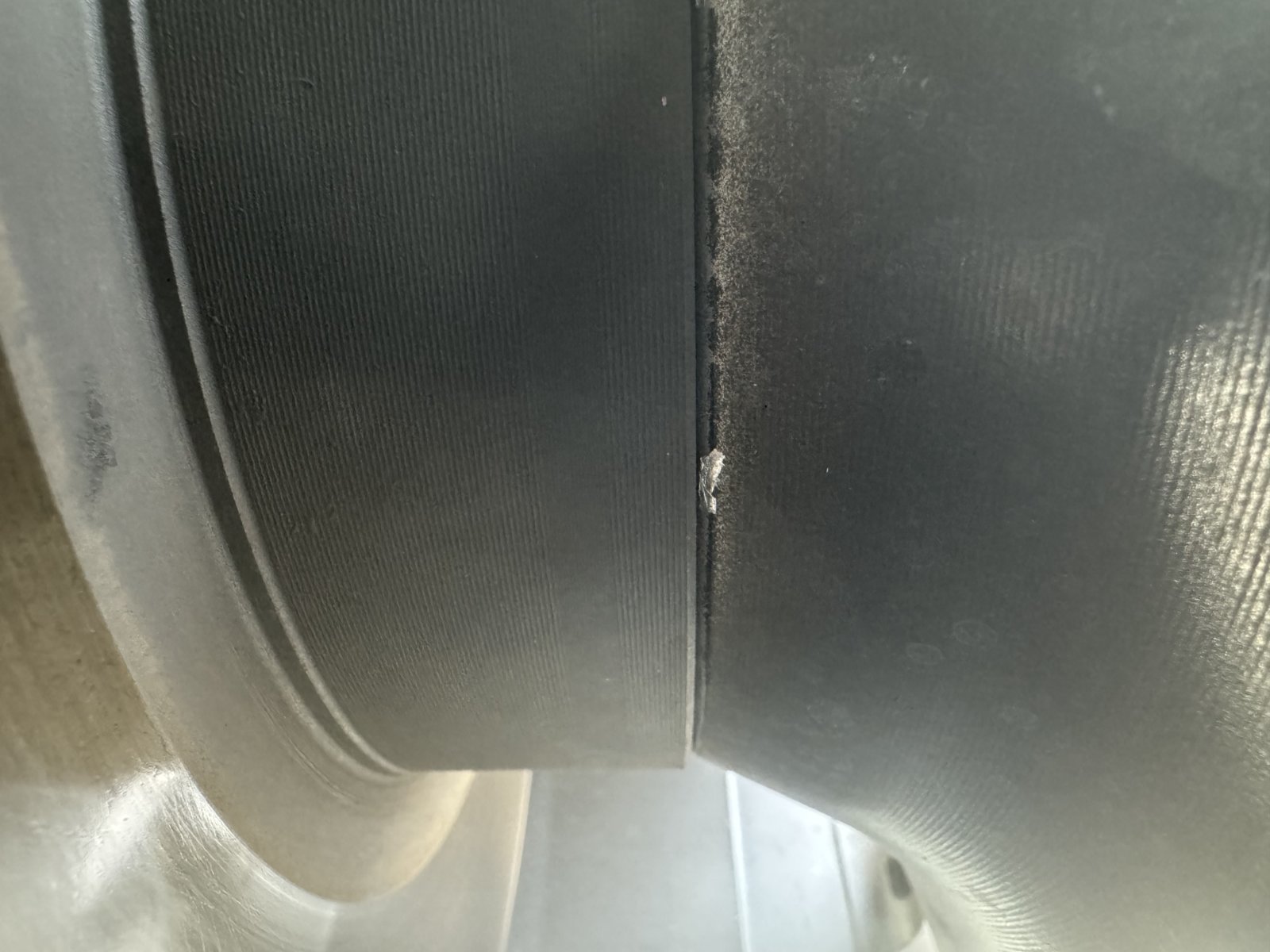

    I noticed a bit of bumping and thought just to look at the hubs and saw this. I’m not sure what could be causing what looks like the hub not to be seating/moving like this because I had it serviced at Toyota 3 days ago and they re torqued the lugs to spec. Any thoughts? the first picture is my passenger front side hub and the second is the drivers front side.

    Pull the wheel, check and then clean the mating surfaces, then reinstall. It looks like thats a metal shaving thats crushed in between the hub and wheel.

    Doesn’t look like that to me. That ding is at the edge of the bevel on the wheel and is several millimeters from the actual mating surfaces between the disc rotor and the face of the wheel.

    They told me they torqued to spec and the other wheels all look much more flush unlike the one in question.
    The ride just feels rougher but I don’t notice any wobbling in the wheel or pulling that I couldn’t attribute to the road or high wind. I did read from other thread that these wheels have had a fit issue on the Tacomas but I just think it’s odd that the other 3 sit well and only this one doesn’t.

    I lifted it and tested to see if it was loose but it feels solid in there and I’ve tried using my torque wrench to see if there was more thread to catch but was barely able to get a turn if any at all on that particular wheel
