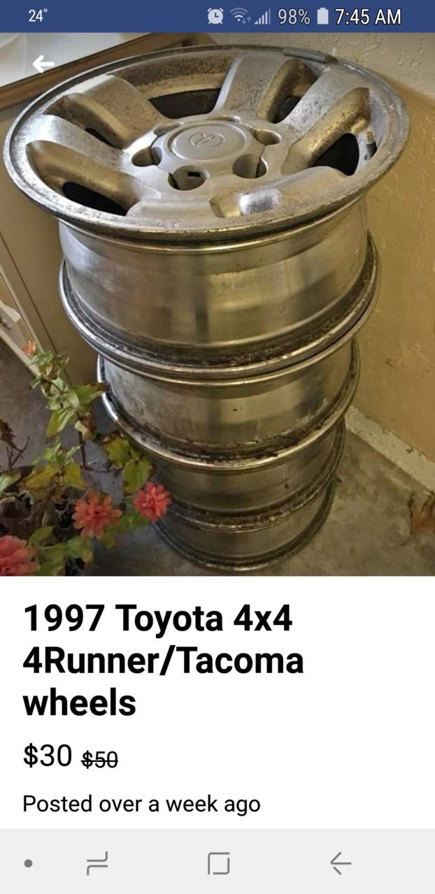

    So I found these for $100. These will fit a 96 Taco correct? Driving an 1.5hr to get them and not taking my taco to test fit00m0m_6glzpH0fx1B_1200x900.jpg

    5,288
    Should fit the lug pattern.
  11. Dec 10, 2018 at 3:46 AM
    #31
    Blue92
    Blue92 Well-Known Member
    Aug 26, 2017
    #228071
    16,472
    Daniel
    North Carolina
    2018 Sport
    Yeah those fit, but theyre damn close the the upper ball joints. Closer than my 3rd gen wheels were. Cant get my finger between the tire and ubj, anything bigger than 265-65-17 on those and your gonna need spacers.

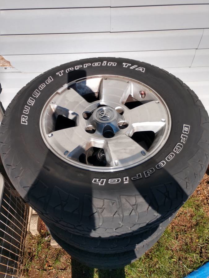

    Or there's these for 30bucks. At same placeScreenshot_20181210-074544_Facebook.jpg
  15. Dec 10, 2018 at 6:19 AM
    #35
    Blue92
    Aug 26, 2017
    #228071
    16,472
    Daniel
    North Carolina
    2018 Sport
    Id get the 1st set.

    @fnfarms1 the wheels you got are Toyota wheels, dealer option for some southern trucks.
    unfortunately they are not designed for manual hubs, only auto hubs or pre-runner. other toyota wheels with "removable" center caps like the 2nd pic and this last pic will work as the manual hub protrudes further out than the standard hub. that first set of wheel you got won't allow the room for the hub to protrude far enough.
    that being said what others have mentioned, anything Toyota 6-bolt will "fit" your truck as they are all 139.7mm(6x5.5) bolt pattern with 106.25mm hub bore. backspacing will be the determining factor, but seeing as you are running a standard size tire there should not be any issues. 245/70-17 is the same as 31x10.5x15 (and 265/70-16)

    So which set with set like OEM wheels. The last pic I posted is factory wheels for my tacoma if I understand. They are just 16s instead of the original 15s
    Starlifter likes this.
  18. Dec 10, 2018 at 10:17 AM
    #38
    frizzman
    frizzman Well-Known Member
    Sep 25, 2013
    #113212
    5,348
    Pittsburgh, PA
    04 XCab 4x4 TRD/OR
    OME 2.5,Tundra 17s,Falken Wildpeak AT3W hitch w/ 7-pin, ARE cap, JVC HU w/BT, HID/LED lights
    the last pic, if they are 16s were from the 4Runner. The Tacomas had the 15s. But either works. Also the backspacing is correct for all 1st gen
    the 17s you posted before are from 2nd/3rd Gen and 03-09 4Runner. They have more backspacing that moves them "closer" to the upper control arm. If you weren't doing stock size tires that may cause an issue. but with stock size (265) or skinnier (245) you won't see any problems.
    edit: you will still need to remove the center cap on the front two rims as none of those caps were designed for manual hubs. The center caps for the "tri-star" rims do have a version that is for manual hubs. but most just run them without
