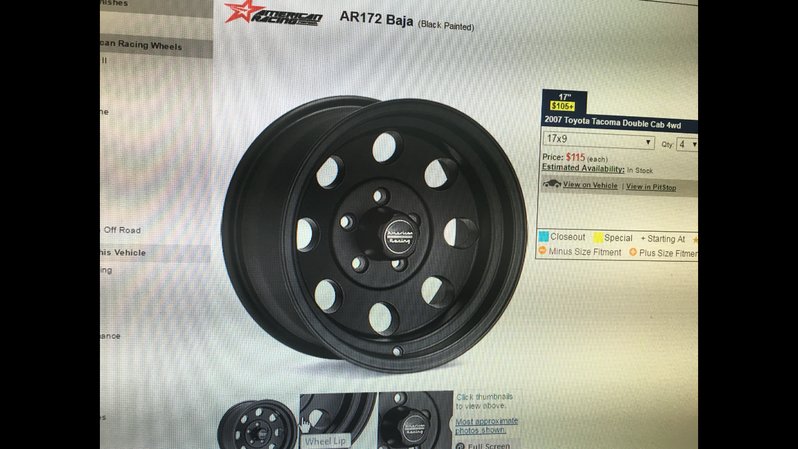

    Hey guys! I'm finally lifting my Truck, I bought Tires, a lift and now I'm ready for rims, the lift is to go in next weekend!!
    I'm having a hard time finding the rims I need, what has everyone found works to get the correct clearance?
    The rims are the set I'll order if I can't find anything else. Thanks!!image.jpgimage.jpg

    Those will be fine and stick out ~1.5" farther than stock.

    But I'm wondering if I even need that much of an offset

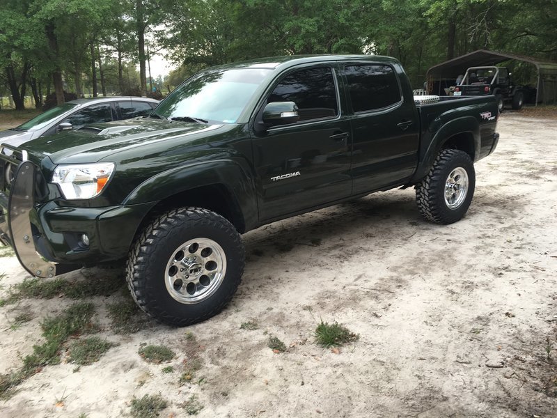

    3 in toytec
    2013 tacoma a.jpg 17x9 mickey Thompson classic iii 4.5 back space and -12mm offset 3 in toytec lift

    Are you planning on running a bigger tire? If the answer is yes, then you'll need that much offset. It's so the wider tires won't rub on the UCA.

    3 in toytec
    that is correct .... in the pic is 285 70 17 remove the small front mud flap and small cutting of plastic on the cab .... not bad at all cant even tell where it was cut
