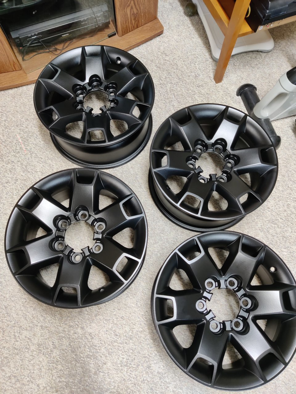

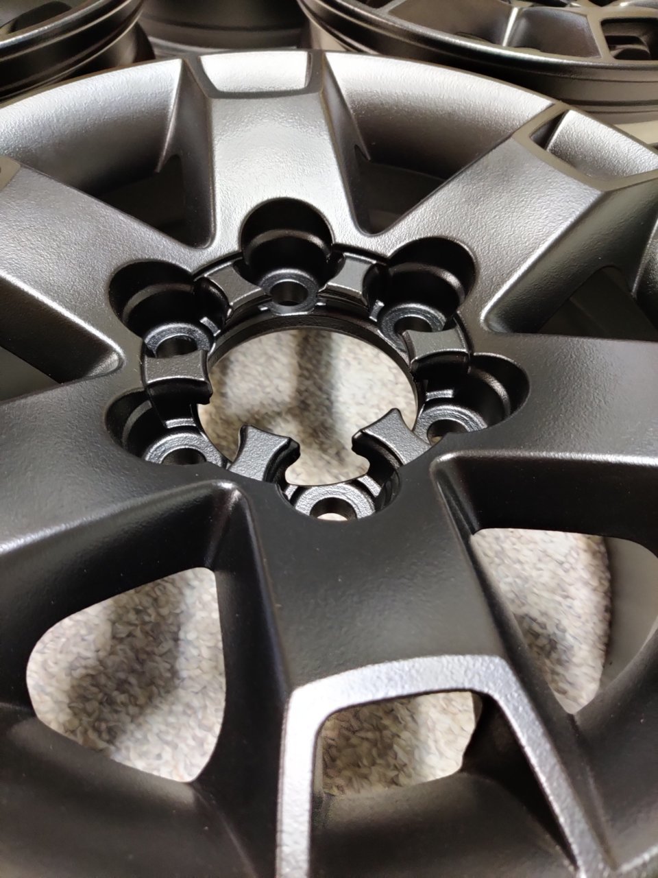

    Not sure if you would consider going this route but I had my old, scratched and peeling baja wheels powdercoated for $55 a wheel from a local company. They look amazing. Brand new!IMG_20200811_150921.jpg

    if I go this route... then I need to bring it to a place to take the tires off power coat, dry... then back on again? I need new TPMS too, the light is flashing...So I think they are failing... it looks like I need to spend some $$

    I don't know of a place that would do it all at once. What I did was put my truck on a jackstands for a few days, took the tires to the shop to have them unmounted from the rim, took the rims to the powdercoat shop. The powdercoat guy pulled the sensor/valve stems from the wheel before he started and gave them back to me in a box when my wheels were done. I let the wheels fully cool for a day and then took em back to the tire shop to have my new tires mounted and balanced, and reattach the sensors, then put em back on my truck! Tire shop only charged me for mounting and balancing. It was kind of a process but if you don't mind waiting a couple days and have another vehicle and jackstands, it's not difficult.
