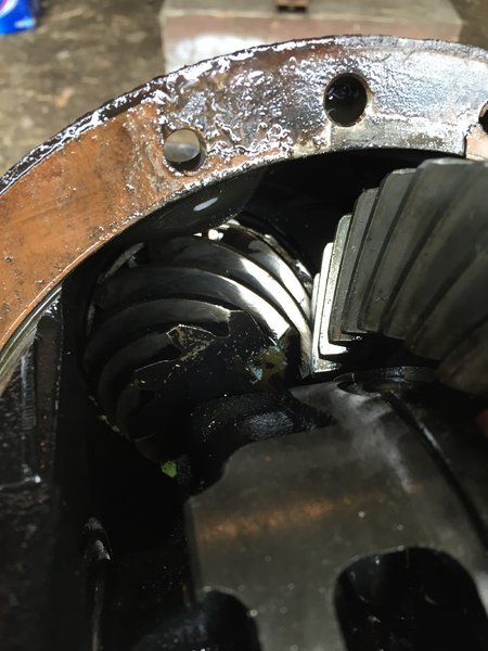

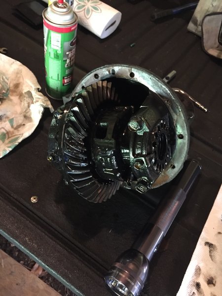

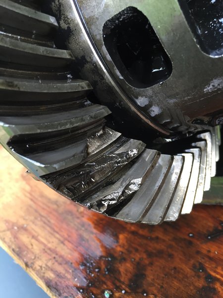

    So I'm in northwest CT. If anyone is in CT and can get access to a third member I would be very interested in buying it.
    I got the third out and there are busted teeth on the ring gear.
    Trying to post a few pictures from my phone. Limited network where I'm at

    Pinion gear looked ok besides some wear from the busted teeth on the ring gear

    So just an update, the entire third member is apart except for the rear bearing on the pinion gear. Waiting on the bearing puller and the ring and pinion in the mail. Everything came apart fairly easily with regular tools, no specialty tools required so far besides the bearing puller. I already had everything I needed up to this point. I decided to go this route because every other option was just too expensive and I don't mind taking my time and learning about something as I go. I'm a stickler for the details so I think I'll be ok moving forward.
    Side note: that diff fluid stinks...
