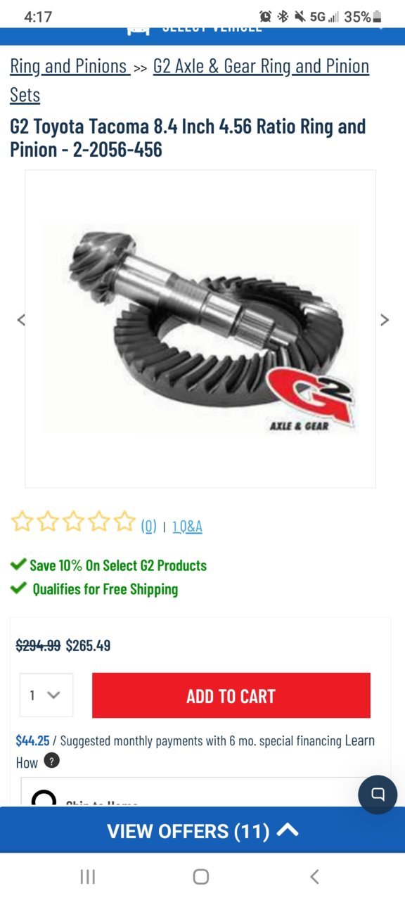

    Need help please! Looking to replace my ring and pinion for my 2008 tacoma 4.0l 4x4 without lockers. I do have stock lsd. Found that but I'm not sure if this is the right one for my truck

    8” is commonly referred to as the E-Locker.
    What you have is commonly referred to as the 8.4”
    That picture doesn’t really help.
    It just says - 8”, so I’m going with NO, it is not what you need.
    And YES, I know technically they are both the same size.
    It’s still up for debate if the 8.4” is stronger ( I say it should be)…Yada…yada….
    Just throwing that out there before someone else says it.

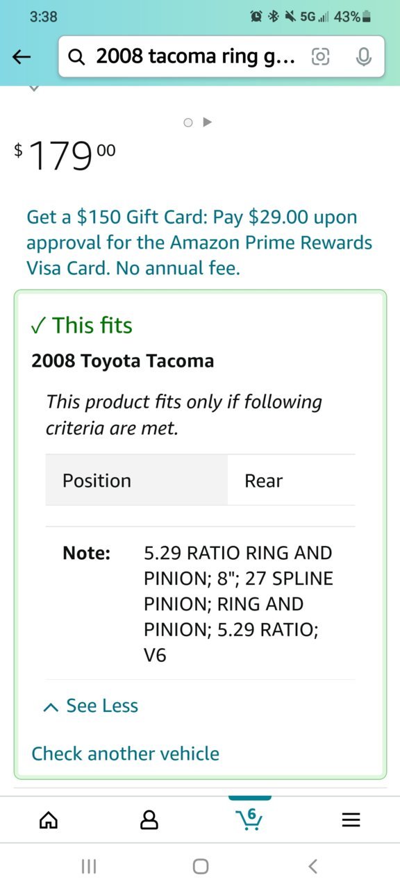

    According to this I have 4.56 I believe your right I have the 8.4 not the 8.

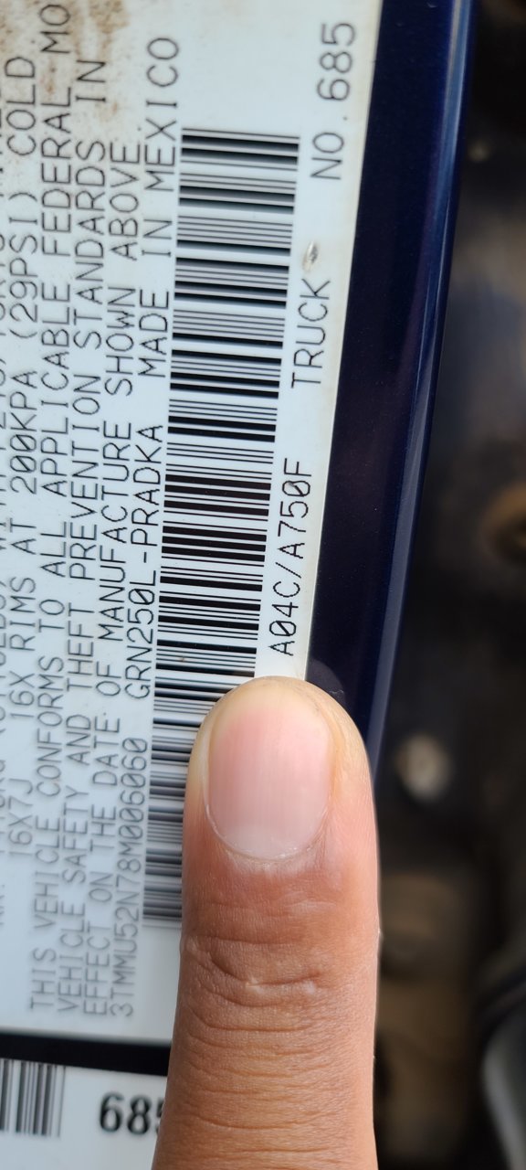

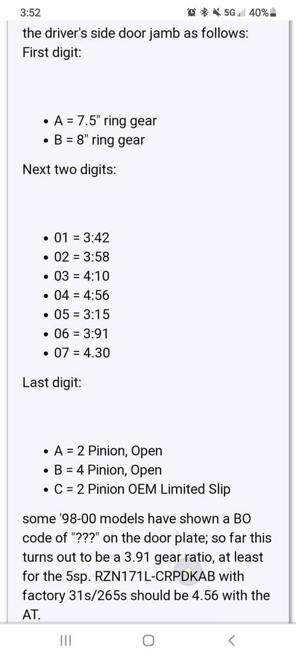

    This one says my gears is 3.73 8 believe this is the right gears

    1995-2004 axle codes do not apply to 2005-2022 trucks.
    Aside: I still get a kick out of the fact the common terminology is 8.4” just because someone didn’t know how to measure a ring gear.

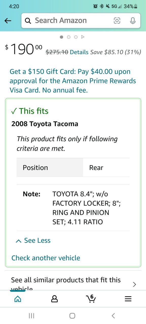

    A04C on your truck is an 8.0” non-locking 3.73:1 clutch-type LSD.
    May be listed as 8.4” depending on the seller. Just ensure it’s not for a locking diff.
    EDIT: So, neither of those.
