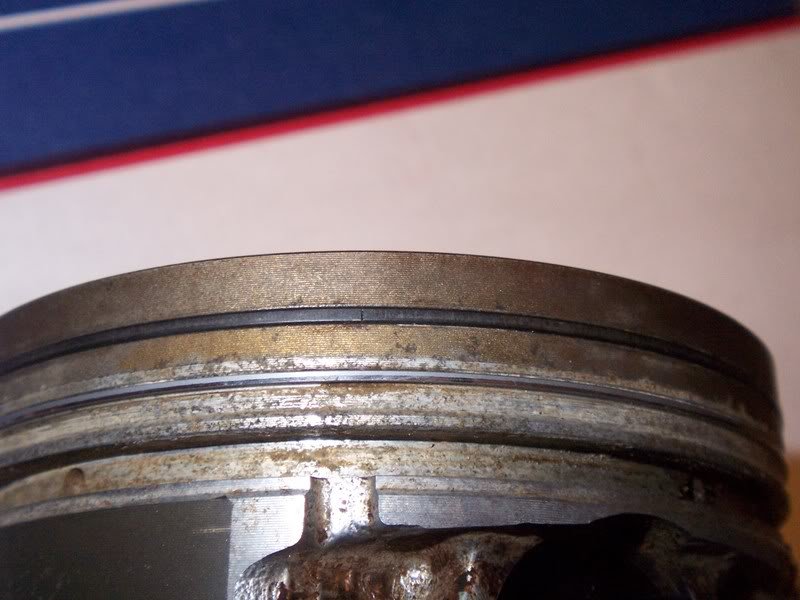

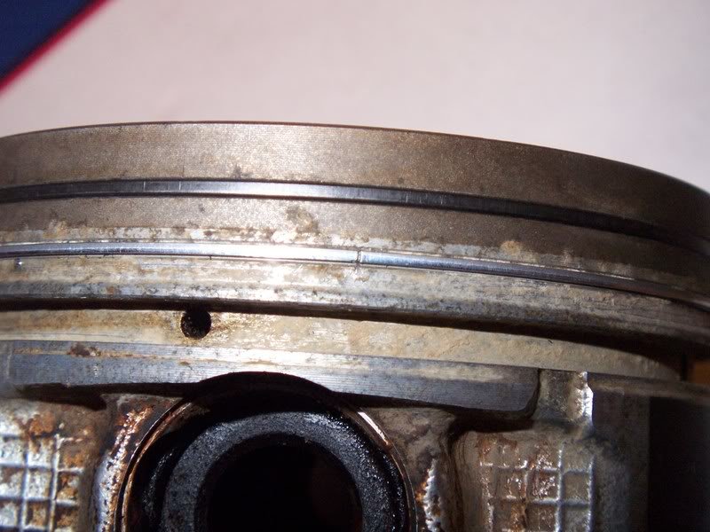

    Well, I got my pistons out and can't get the dang rings off. The good news is that I now know the cause of my really low compression. The rings are so tight to the piston that it takes a good minute to even find where the end gap is. I have tried using a heat gun and soaking them with solvent. Anyone got any ideas? :confused:

    Soak them in a parts cleaning tub.

    I am thinking of getting new pistons. I found a pretty good deal on them. I'm renting a car for $20 a day and can't be sitting around for 2 weeks for the rings to maybe let go of the pistons.

    soak them with liquid wrench for an hour, then try using a small flat head screw driver to break them free............or go with the new pistons/rings like you were saying:D.

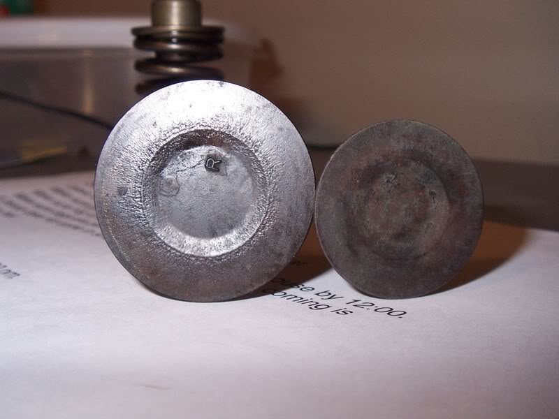

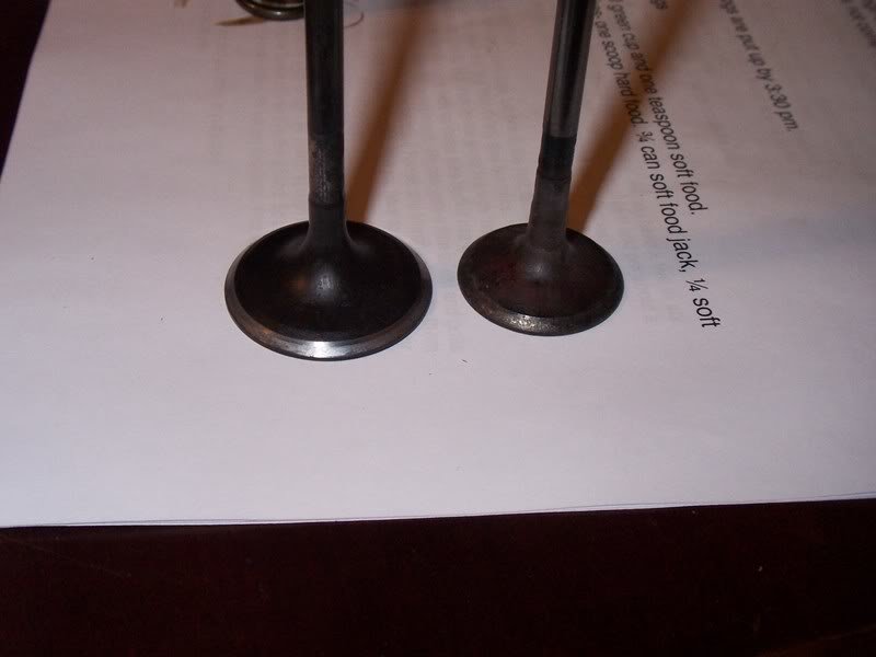

    I've got my valves out and they look pretty good for 113,000 miles.

    would defintly agree on getting new pistons if its in your budget

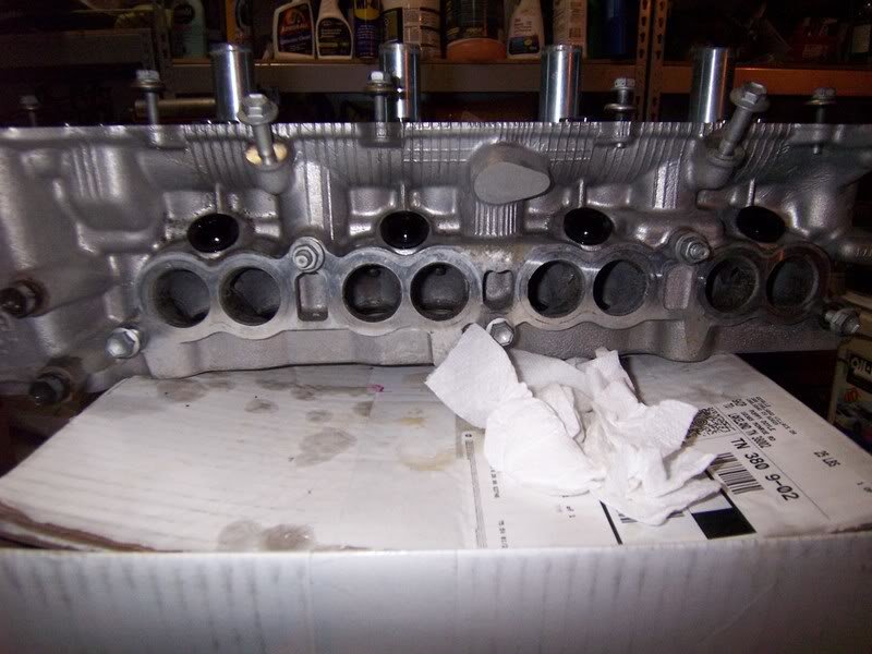

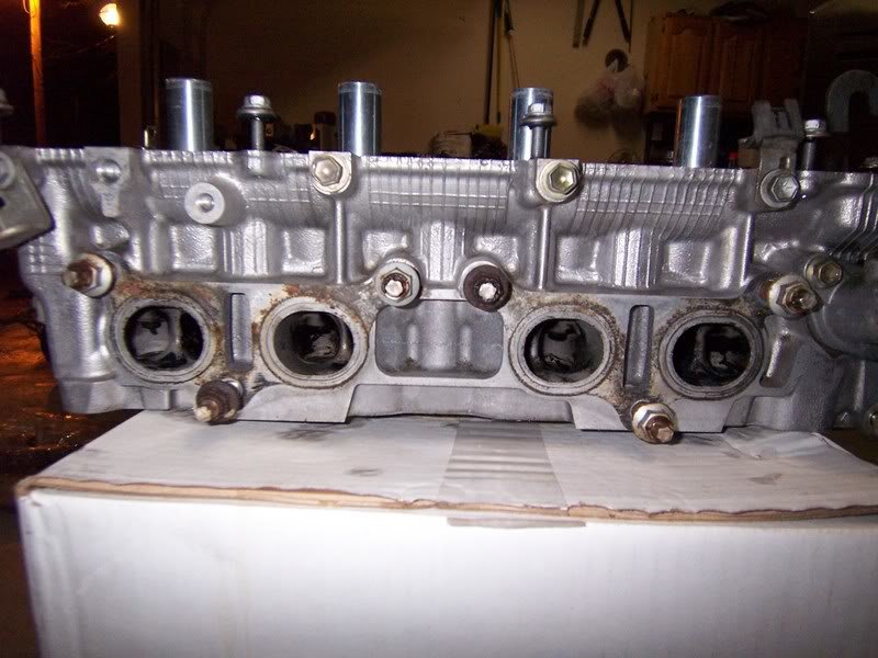

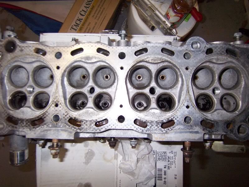

    Got the new pistons on the way. While I'm waiting for them to come in, I decided to do some clean up.
  8. Mar 9, 2008 at 8:58 PM
    06tacoma
    06tacoma Well-Known Member
    Dec 6, 2006
    #407
    415
    Tampa FL
    06 PreRunner SR5 XS-P Trd Longbed Double Cab
    20" enkei wheel,BFG G-Force tires, BHLM, Smoked tail lights, 2 RE Audio 10s, Quantom 900watt amp,10000K HIDs headlights and fog lamps,Borla exhaust, Borla drop in filter,Debadged tailgate,Painted black tacoma badges
    looks like it is coming along pretty good
  9. Mar 9, 2008 at 9:06 PM

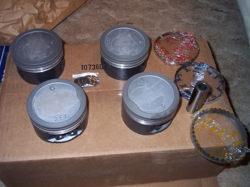

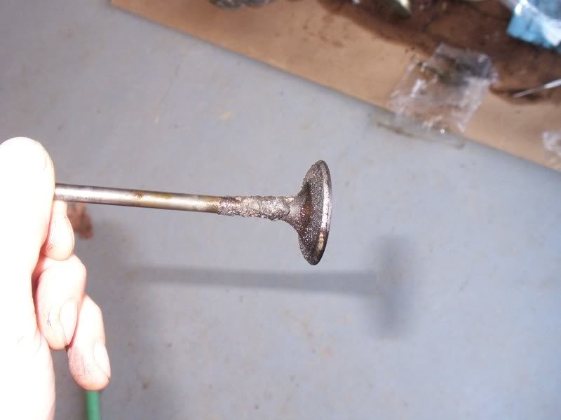

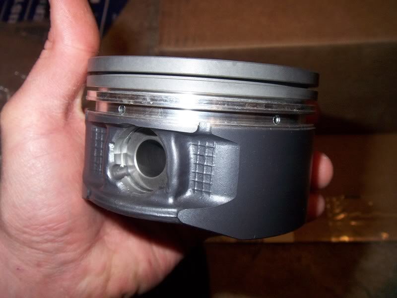

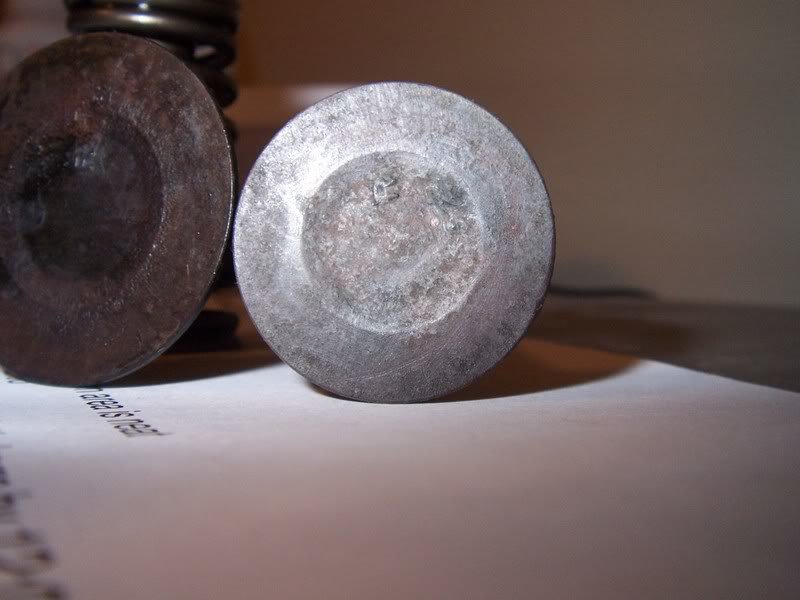

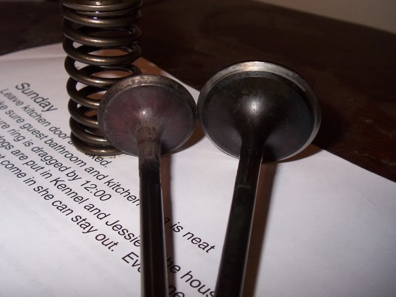

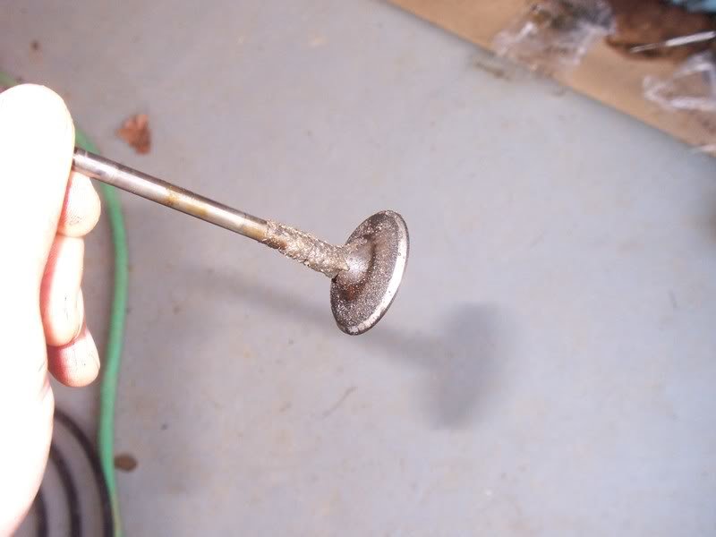

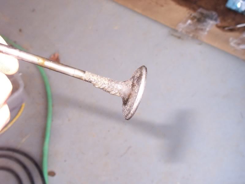

    Gook on intake valve. Same type of hard deposit that glued the rings into the pistons.
    Same valve.
    They are all this clean now. :hattip
    Nice set of pistons, pins, and rings.
    Teflon (I'm guessing) coating all over the piston skirts.
  11. Mar 13, 2008 at 4:55 PM
    350TacoZilla
    350TacoZilla Well-Known Member
    Sep 22, 2007
    #2767
    1,119
    Hancock MD
    1997 3RZ 5spd 4x4 Reg Cab
    2.7L 3RZ,K&N filter, 4" deck plate mod,flowmaster 40 series,3" suspension lift, hybrid 52"chevy/toyota rear springs.
    looking good yeah that gook is basically carbon and those rings may never come out...I'd soak one of old ones now that you got new and just see how long before they free up (if ever)

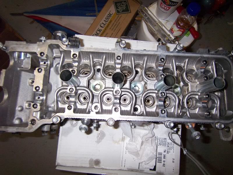

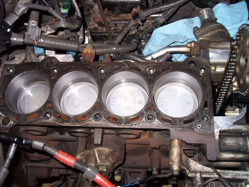

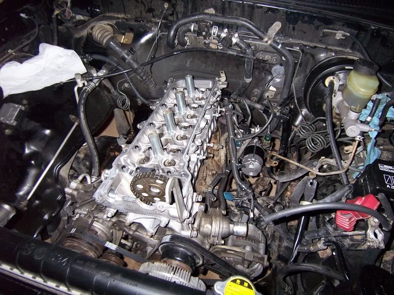

    I put my pistons in yesterday and got the head on and torqued. I feel like I got somewhere with the head back on. I didn't like having all those dirt sensitive parts exposed. Tommorow I will put the lifters, cams and exhaust back on and hopefully have it all together and running by Sunday.
    Shiny new pistons.
    Head on.
  13. Mar 23, 2008 at 9:55 PM
