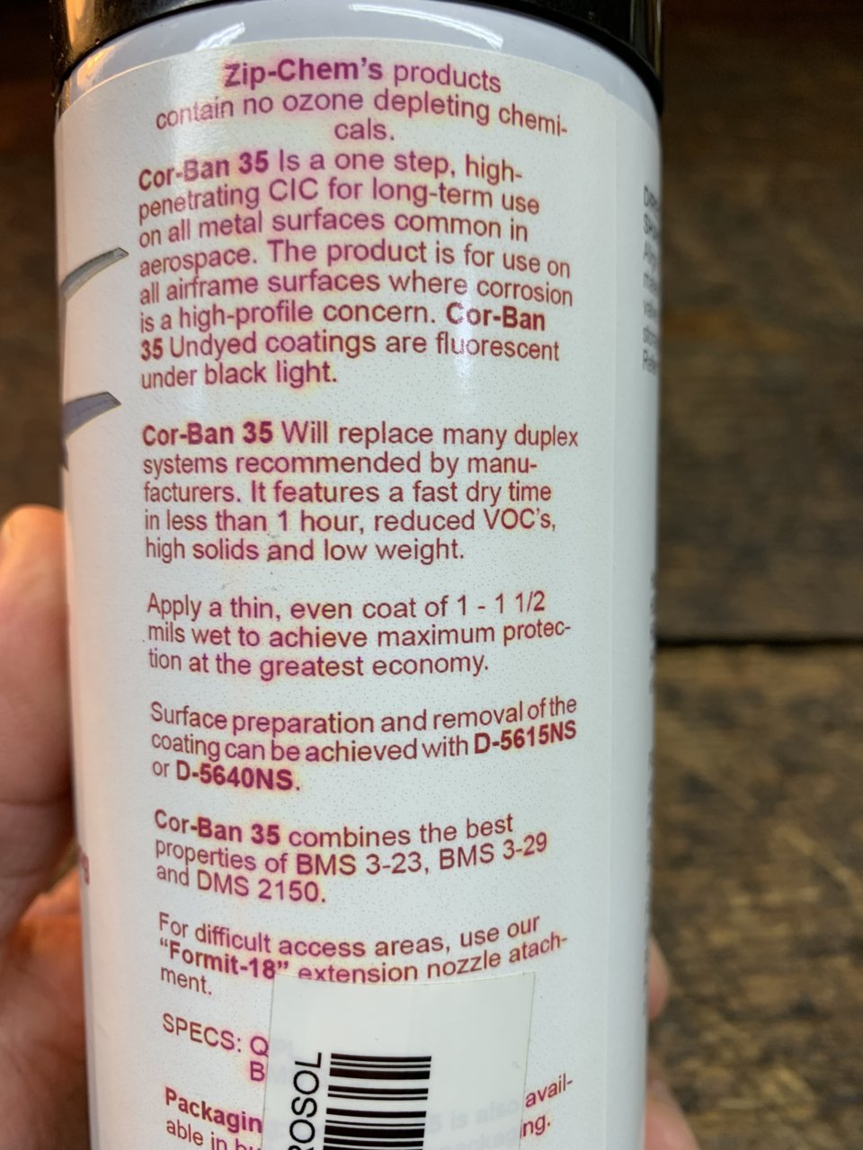

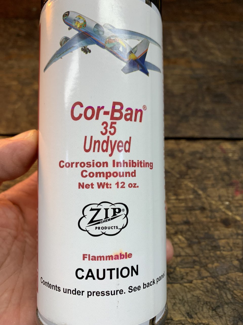

    Nobody ever thinks of this stuff but you need to consider that if the Govt. and most of the airlines along with oil rigs in the North Sea, Railroads, etc use this it might be worth your time to investigate. It is and has been in wide use in Europe for years but here in the states is still largely unknown. We used it to spray the wheel wells on Boeing aircraft, Airbus and you can imagine the hostile environment that must be. We also used it in the cargo compartments beneath the floors because on international flights the ramp people urinate in the cargoes and is highly corrosive. After seeing what it can do I bought it for my cars. It goes on almost clear so you can see what is happening to the metal underneath. It dries to a semi hard wax like consistency and needs a solvent wash to remove. It stays put

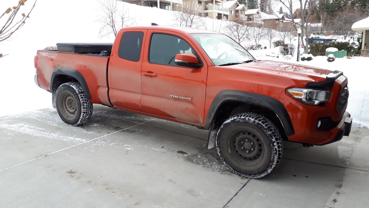

    Mine is 2016. We have had snow since Nov 16, about 30 inches since then. Roads covered in snow, salt and sand for the last 2 months now. I have washed my truck once in the last 3 months.
    That was in my driveway with a pressure washer just so I could get inside the wheelwells, and underside and clean it up a bit in the nooks and crannys. Did not wash the outside of the truck, no point since the roads are crap and back to dirty the next day. My last full wash was first week of November.
    I think as one guy said, don’t overthink it. This is my 4th 4x4 in the last 35 years, and each would get maybe 2 washings on the underside over the worse 3 months of each winter. Despite 30+ hardcore offroad trips each year on bad trails in BC, and snowy winters, all of my trucks looked pretty good for many years. Wax them twice per year, once before winter and once after, and it works pretty well. Never had any issues with rust even on my old 86 F150 which took a heavy beating for 13 years. We have had 3 bad winters since I got my Taco, and zero rust on the underside and I check that several times per year due to my undercarriage taking a beating off road.
    Truck has looked like this every day for 3 months now, and the same the previous 2 winters. No mud since it is just snow salt and sand. Looks a lot worse in person, in that pic it looks like it just rolled off the showroom floor. The orange masks the dirt pretty good. Best thing is you can’t see the license plate on the back so its great for getaways. Still, no rust on the underside and nothing special done, just the original coating when new, and that rust treatment the dealer put on for the frame issue.
