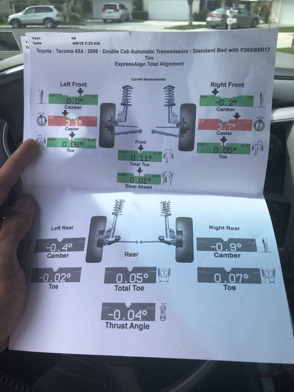

    I will get an alignment first this morning but
    It drives well. Handles, different. A little oversprung still so I need to add the winch soon. I’ll comment again when it’s all set up.

    If I could even begin to desrcibe the 6 hours of cussing it took to get this alignment. The tech gave up and I did it on the rack
    MattCowsmasher likes this.

    I was wondering why my turning radius was absolute garbage...More things to figure out

    That may be resolved with an alignment

    I just got one. I think pulling the caster back may help. I set it pretty far forward

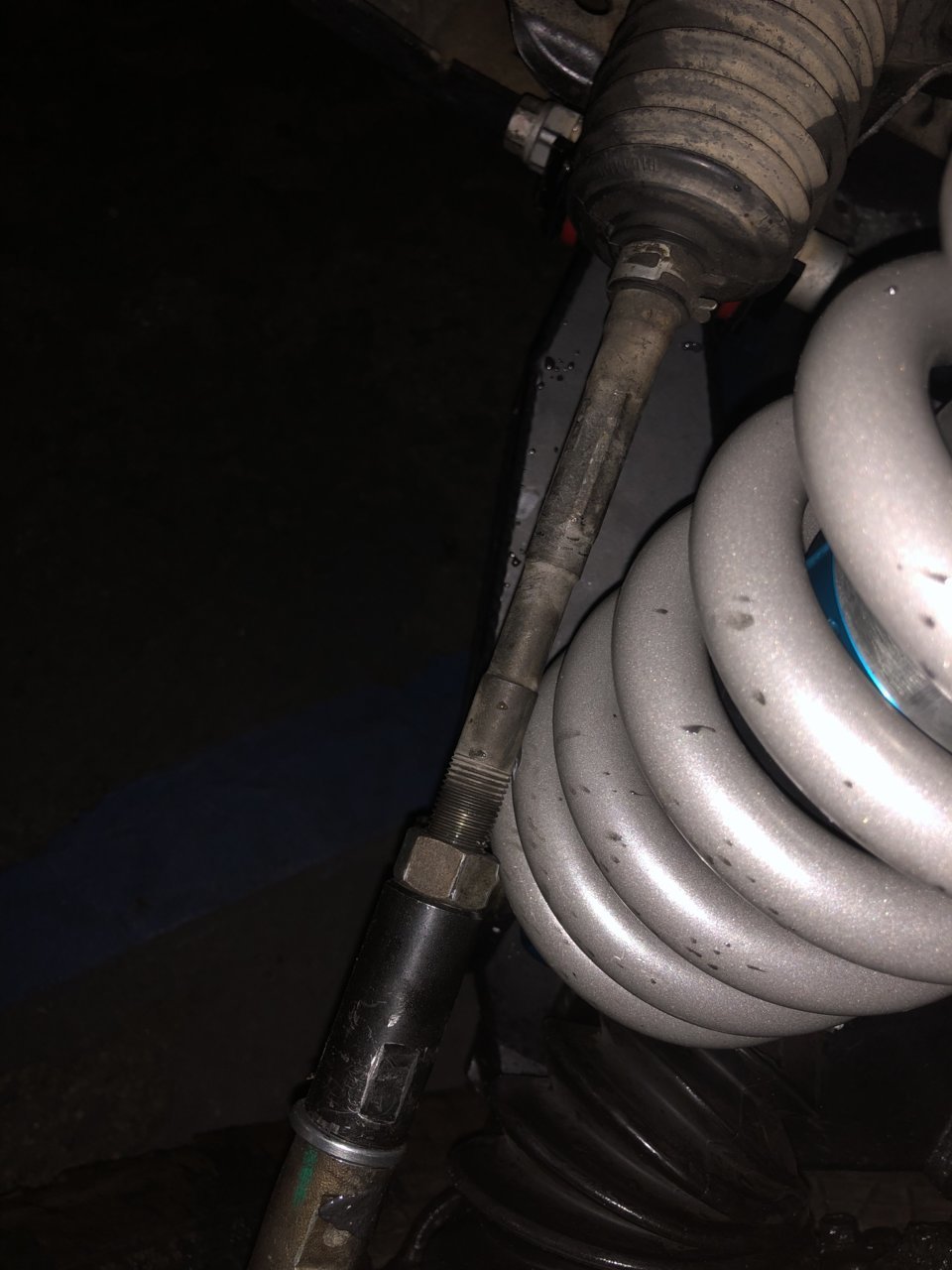

    5,405
    That was me trying to find tie rod extensions
  17. Apr 5, 2019 at 10:55 PM
    #957
    socalexpeditions
    socalexpeditions [OP] IG: @socalexpeditions
    Sep 22, 2017
    #230791
    5,405
    Yeah just a bit of issues to get it going again

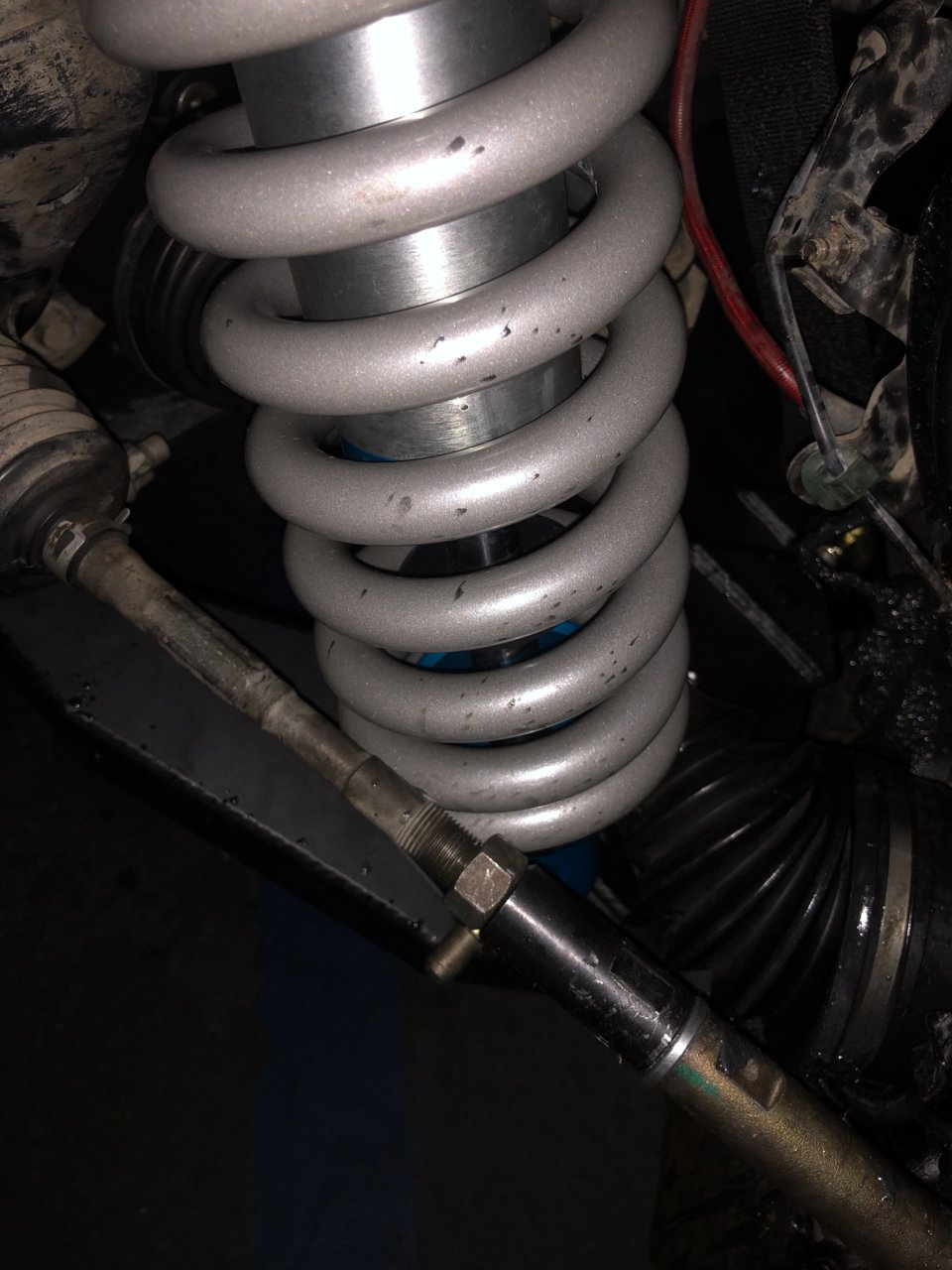

  18. Apr 5, 2019 at 11:01 PM
    #958
    socalexpeditions
    Sep 22, 2017
    #230791
    5,405
    So here’s what I’ve came to realize - My spring seats are wrong. Take a look at the difference between mine and @Jim Bob ‘s . This also means my 18” 700# spring will
    be way, way too long with the new spring seat.
    My plan is to call King, order the right seat, go to Kartek and get 16” King Springs and try that out.
    Tie rod extensions - I’ll deal with that problem later. CV is getting replaced on monday.
    Hopefully that’s enough to get it back on the road!

    San Diego, CA
    2008 dcsb trd offroad 4wd
    That’s the rod end not the spring seat
    He has extended rod ends
  20. Apr 5, 2019 at 11:50 PM
    #960
    socalexpeditions
    Sep 22, 2017
    #230791
    5,405
    Totally makes sense. That’s what I need.
