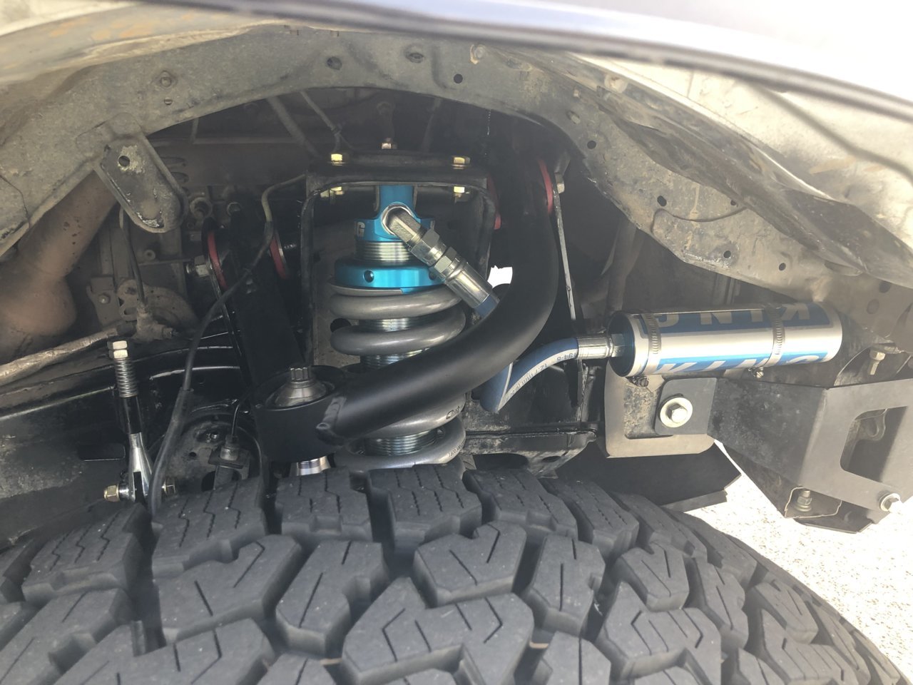

    I thought you had tie rod extensions? Would they not work? Sounds like you’ve got a plan though to get it fixed up

    I do have the extensions - However I only have one side in right now. On Monday I’m tearing everything apart to make it all work. The alignment is SOMEHOW spot on, just an upside down steering wheel hahaha

    I also wonder why such a big difference in your caster, maybe bent spindle

    I pull hard to the right no matter what I do. So I have to offset caster to keep the right tire forward and left back so I can go straight

    Can't pull caster that high. I got 4.9 degrees but had to dial it back because of the UCA hitting the reservoir line. Thanks though I'll keep it in mind, the alignment is near perfect.

    You're going to damage your suspension if you leave that limit strap as it is in the photo.
    You can adjust the reservoir position and twist the reservoir & then tighten it again to turn the hose the way you need it to help clear the UCA. If that doesn't work you can completely move the reservoir somewhere else.

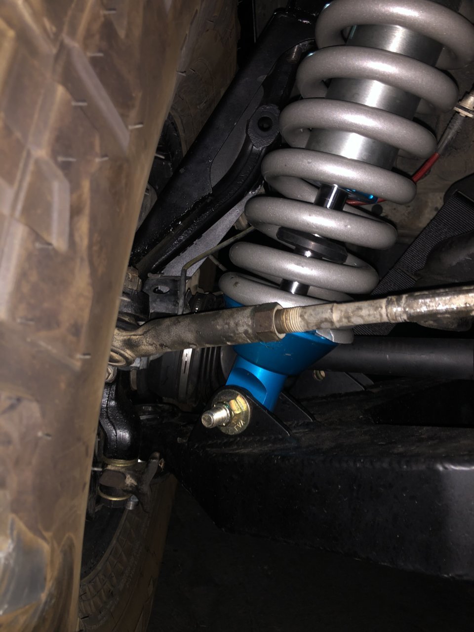

    That sounds like fun been there with tire rub, what's rubbing or what's the issue? What about ur cv? Was it busted?

    CV’s are busted. Funny enough, my CV boots also rub my shock mount...discovered that one today hahaha.
    The spacers which go from the shock to the tophat, I’ll send you pictures tomorrow!
