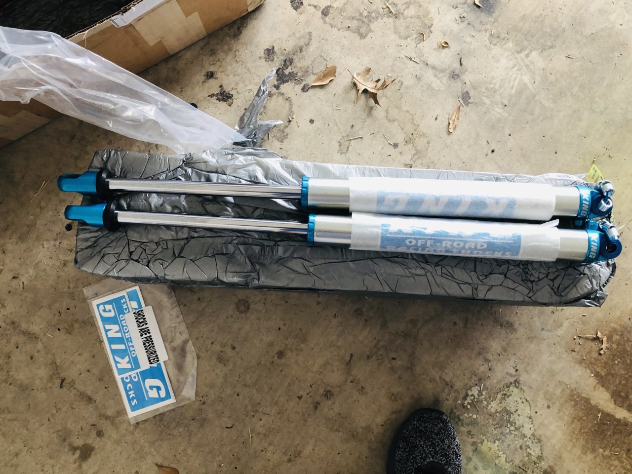

    Well where I’m at is mostly rocks an rutted trails. I don’t plan do any high speed stuff went with king 2.0s non resi out back with the relocate kit and hanger to be installed.
    Current setup this week is icons 2.5 w/resi up front an King 2.5s w/resi out back. Gonna try an sell this setup to get matching Kings upfront....again:anonymous:

    Don’t believe so, meant I want matching king coilovers with resi up front.
    The rear 2.0s don’t have the resi found a killer eBay deal on these.

    #230791
    5,405
    wow i’ve never seen them w/out resi’s

    Probably why they were so cheap. The will work fine for my use.
  17. May 9, 2019 at 8:49 AM
    #1317
    socalexpeditions
    socalexpeditions [OP] IG: @socalexpeditions
    Sep 22, 2017
    #230791
    5,405
    Yeah they’ll be great. I had Bilstein B110’s forever and they were just fine but on the long distance dirt trails they got hot and faded. But the slow stuff, just fine!
    How much did u get them for (;

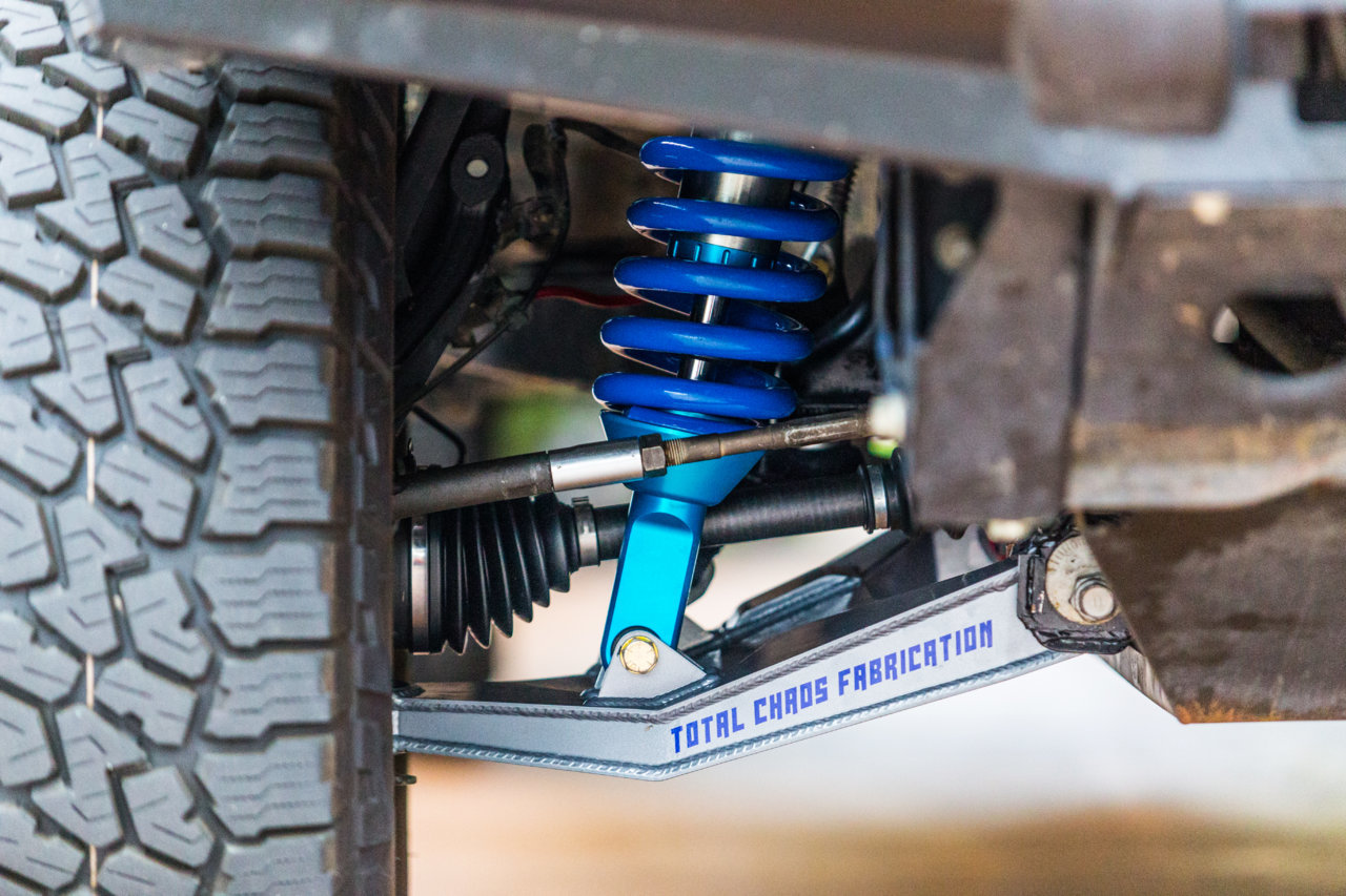

  18. May 9, 2019 at 8:51 AM
    #1318
    socalexpeditions
    Sep 22, 2017
    #230791
    5,405
    In this pic you can see the new gap between CV boot and shock tab - No binding at all even at full droop. Pretty clean setup now. All thats left is to grease the zerk fittings today

    Nor have I
    Have a part #? I'm curious

    Sweet!!
    I paid $375 shipped.
