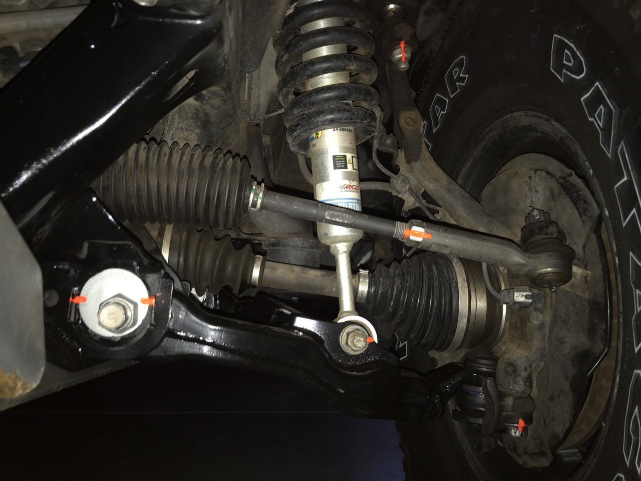

    Killer pics from your recent trips. As usual.
    I would HIGHLY recommend you spend $130 on the Marlin LCA brace kit and have it welded on. Your alignment issues will likely continue and will be an absolute nightmare with even bigger tires than you already have (you mentioned 37’s). The Marlin kit is super stout. You can even put a bunch of bolt marker paint on the tabs and keep a close eye on everything after the kit to be sure it’s helping you. It’s helping my truck stay in alignment with some tough wheeling and 35’s! You would likely benefit greatly, especially considering all the other mods on your truck fighting against the alignment tabs.

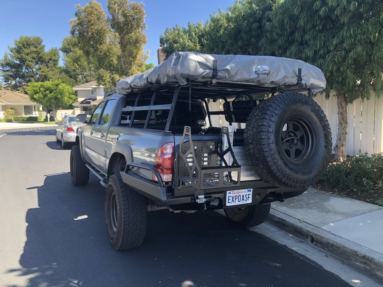

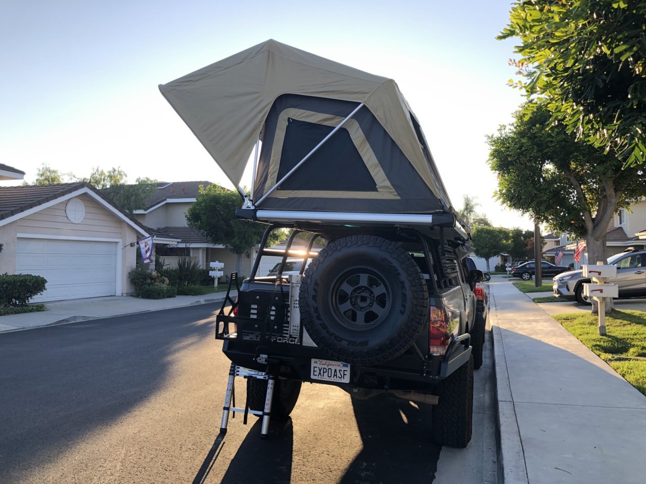

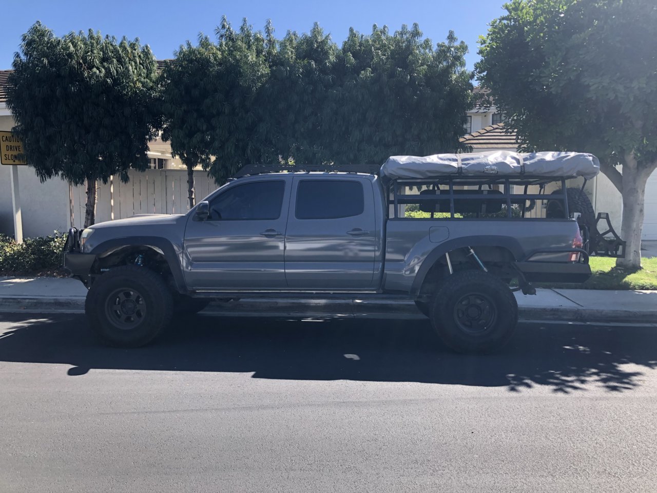

    New tent who dis? 60” wide. @fatfurious2
    This thing is MASSIVE.

    That’s that new RTA
    Rooftop apartment

    Low income rooftop apartment now accepting applications.

    good lord! looks roomy tho

    Oh it’s extremely roomy, love it
