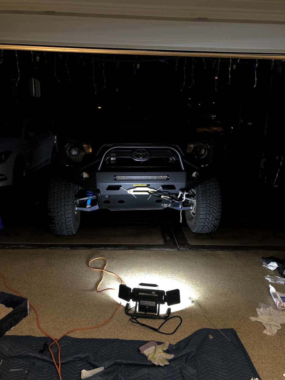

    Well that was easy! Now have a winch. Still yet to tension the line as I don’t have any bumper brackets on and don’t want to risk it.
    And yes, the fairlead is ziptied on (; Need to get rid of the hook for something like a factor 55 or smittybilt
