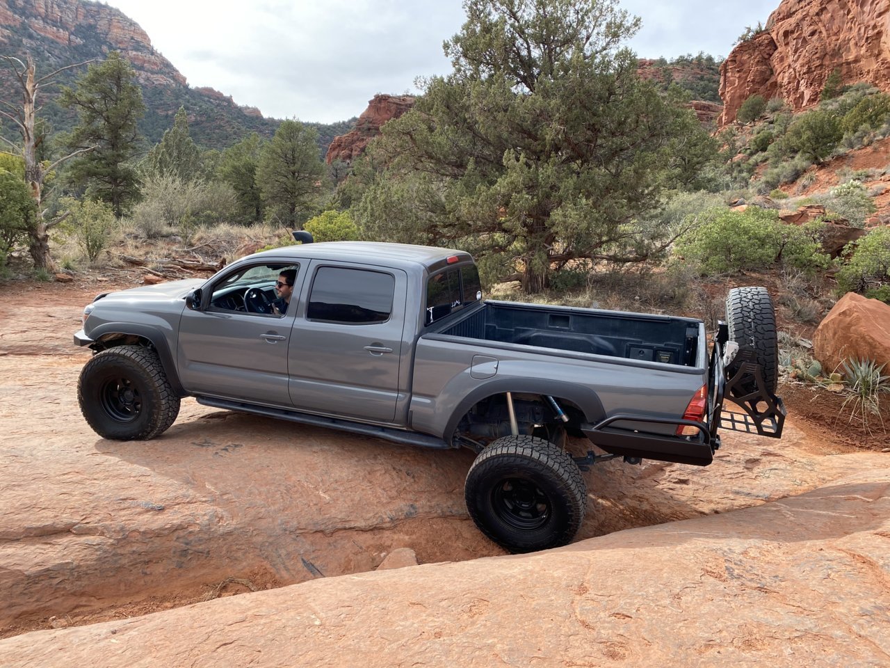

    Did some light wheeling in Sedona!

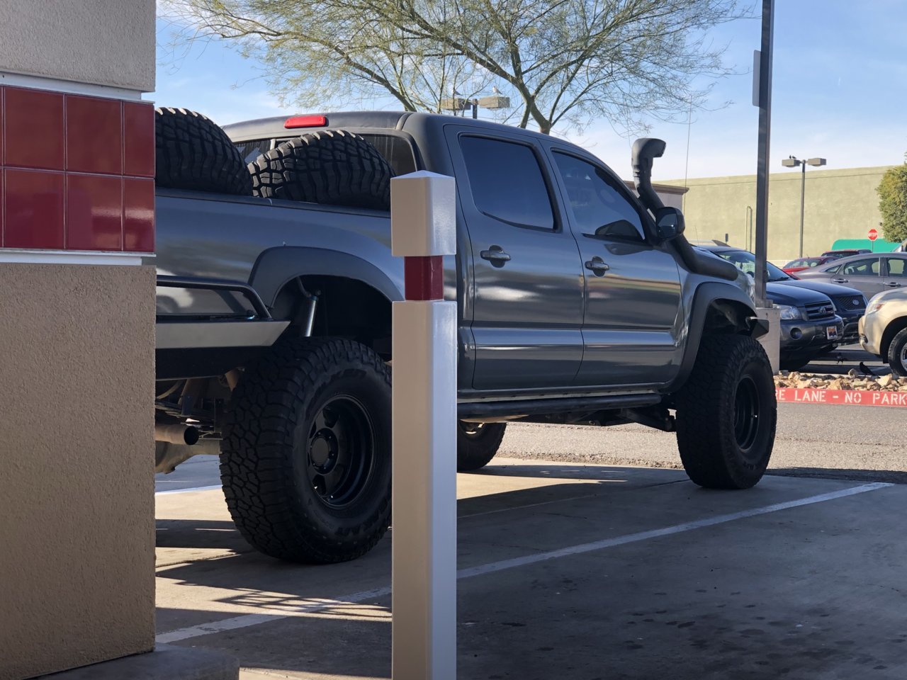

    Are those 37’s in your bed? :drool:

    Yessir

    It could with gears (;

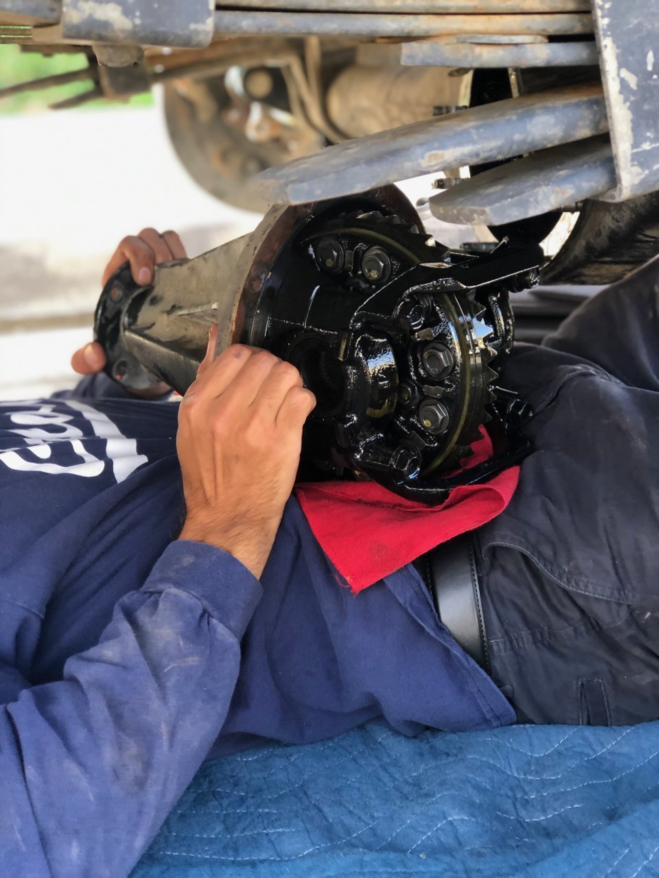

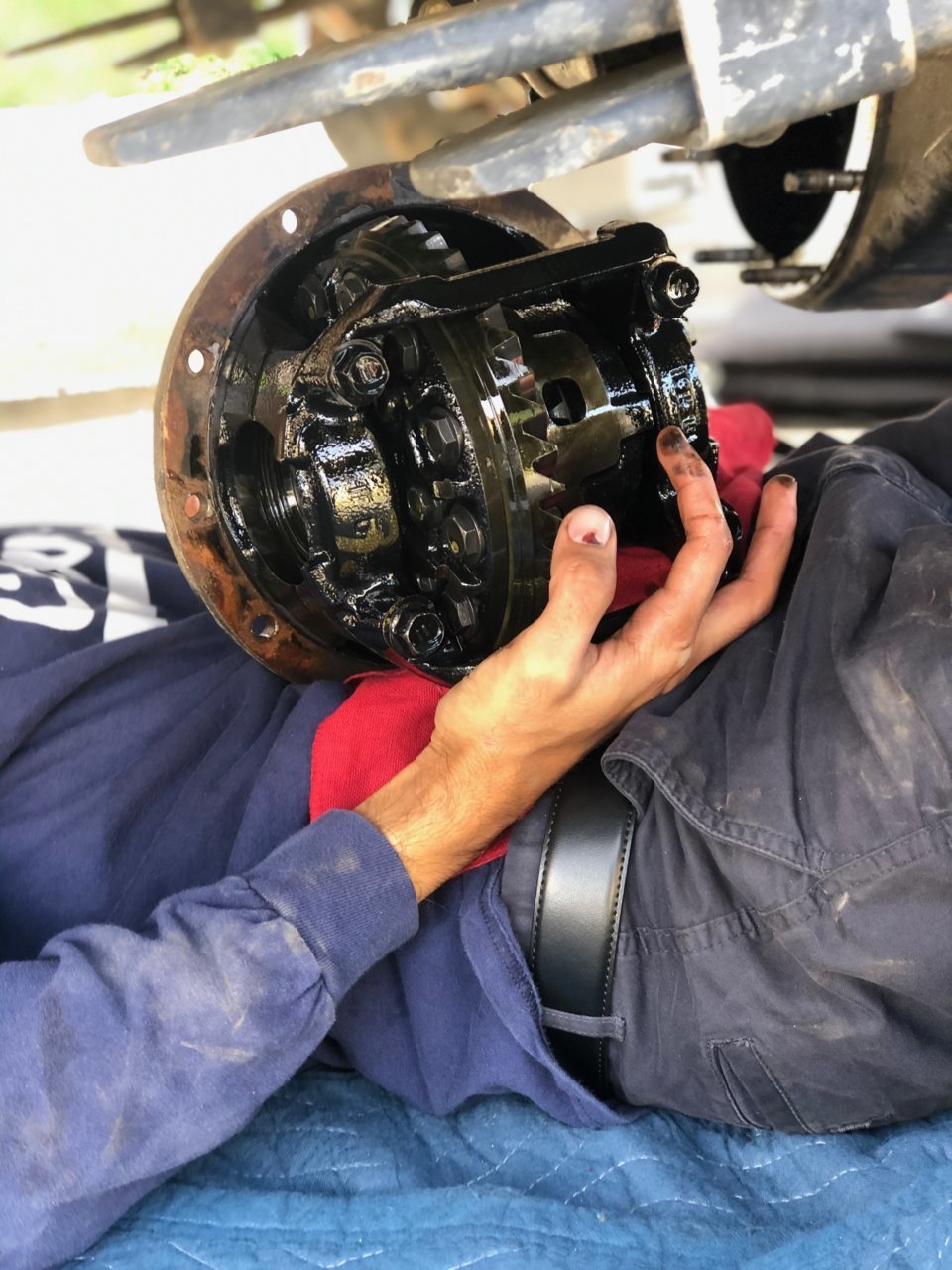

    Knocked out the front diff install yesterday. It’s very straight forward, but patience testing. And putting the diff back in with only 1 person, trying to rotate it correctly was a major PITA. Then once it’s in, you have to blindly attach the oil line and the bolt for the bracket...Took an hour to just do that. The ECGS had the oil line clocked too close to the body, so I had to pull on it while installed to get everything to line up again. Total time was 6.5 hours. Could probably do it again in 4. Still need to take the front apart again and check some bolts and torque down the CV axle nut to 173. Also need to replace front CV clamps...It’s nearly impossible to get off the ones on right now.
    Taking a day off to go to a concert, then finishing up the rear tomorrow. Heard it’s a lot easier so I’m excited. Gotta pump both diffs with fluid.
    Definitely need a new jack and a solid wood spacer.

    62lb baby I'm cradling, lol! Those oil stains don't lie...This was a messy but fun job!
