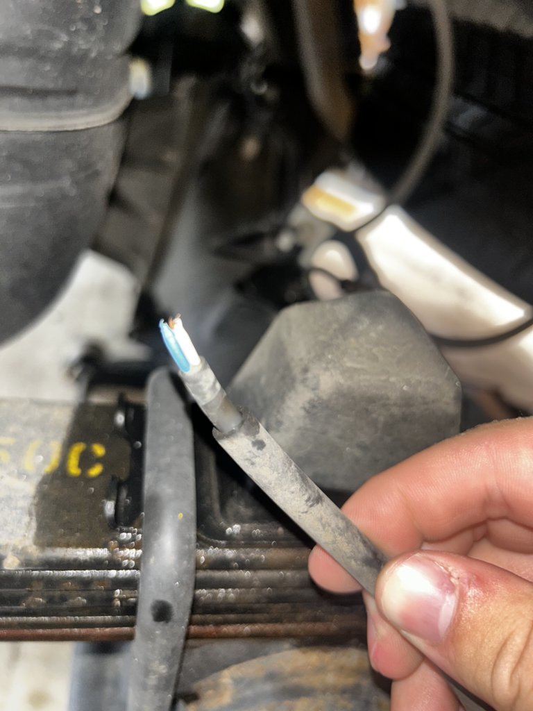

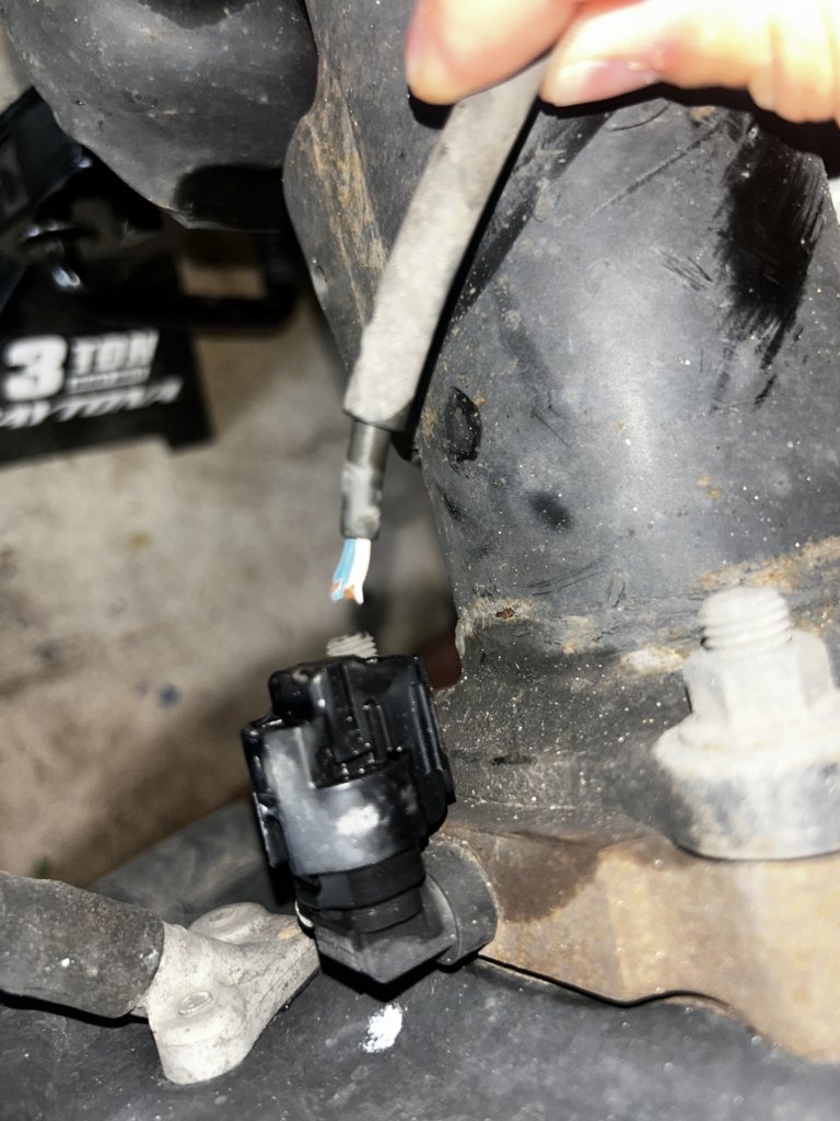

    Hey everybody this is my first post and I’m pretty new here
    But the other day I went to start my truck and it threw all the normal codes for ABS sensor failure
    Went underneath my truck and I saw the sensor wires were pulled out of the part that connects to the sensor
    Has anybody been able to rewire them into the Connector that attaches to the sensor
    If so can you guide me on how to fix
    edit: This is in the rear

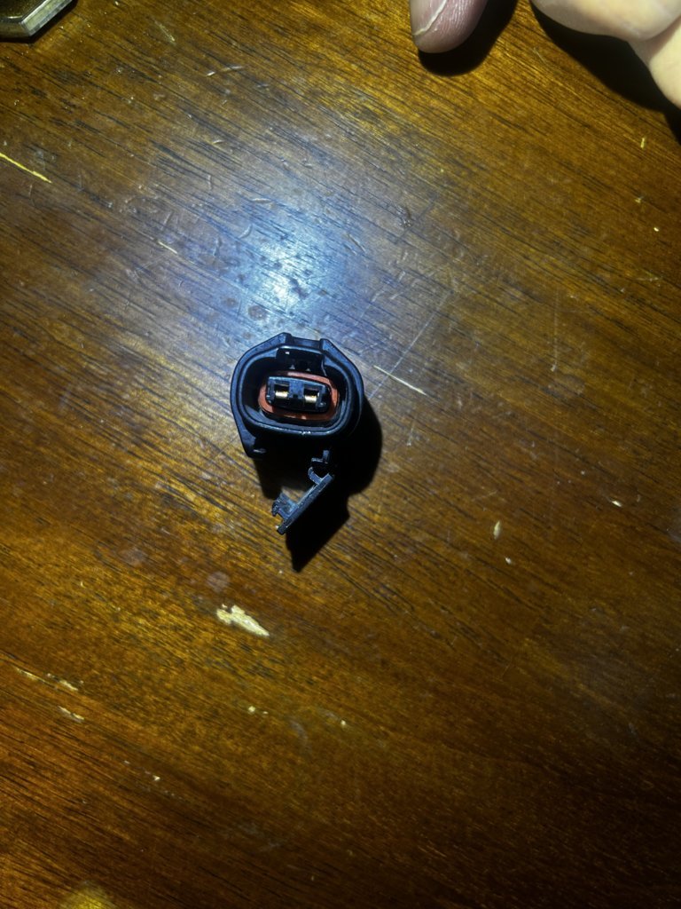

    Ok so I have the plug pulled out I’m scared to break it how do I take it apart
  16. Jul 10, 2025 at 2:25 PM
    #16
    Toycoma2021
    Toycoma2021 Well-Known Member
    Jan 3, 2021
    #351607
    1,706
    Northern California, Temporarily
    2021 Access Cab, LB, AT, V6, Off Road
    First step is to remove that white piece. Get a sharp object and lever it out towards the opening. After that it gets a bit more complicated. Take a picture and post straight down from where the white part came out of. We will instruct from there.

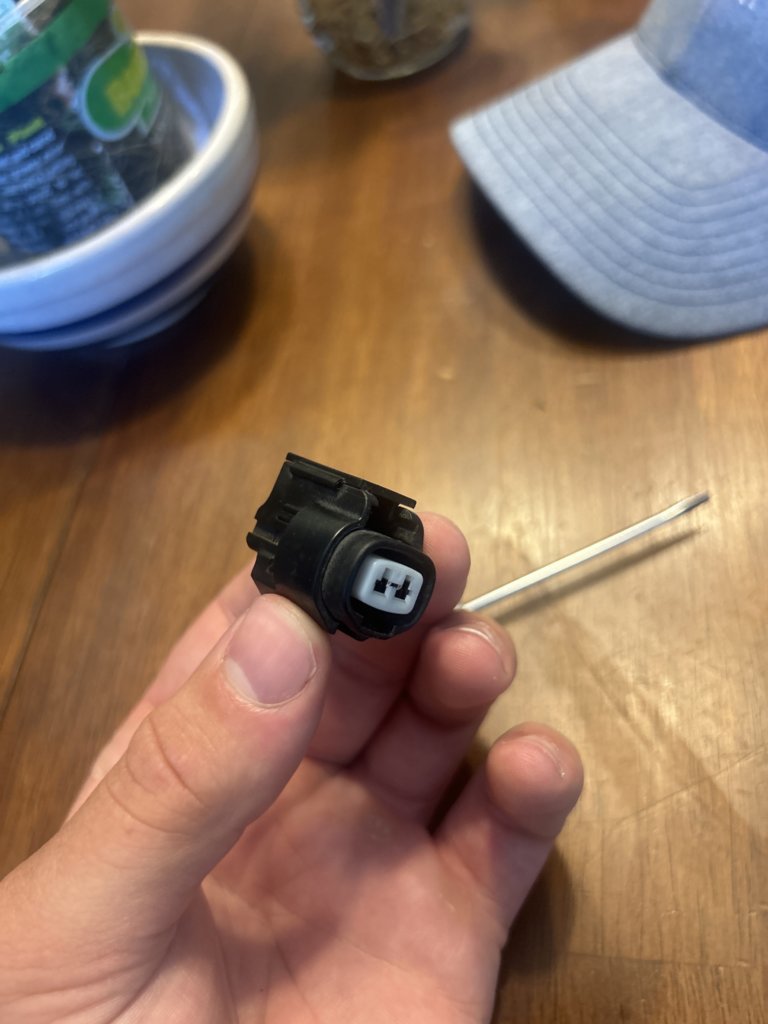

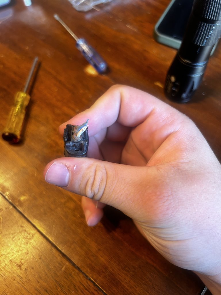

    Is this anywhere close to being correct
  19. Jul 10, 2025 at 3:05 PM

    We were able to remove it from the housing
  20. Jul 10, 2025 at 3:07 PM
    #20
    Toycoma2021
    Jan 3, 2021
    #351607
    1,706
    Looks like the strain relief is hanging open. Is there a round opening at the other end where the larger wire would fit? Do you see any rubber plugs with holes in them for the smaller wires? A clearer picture of what you already posted would be nice to be able describe the finesse next step.
    OK see the two wires coming out the back. That is good.
    Now on to the front. Need a clearer picture of the contacts.
