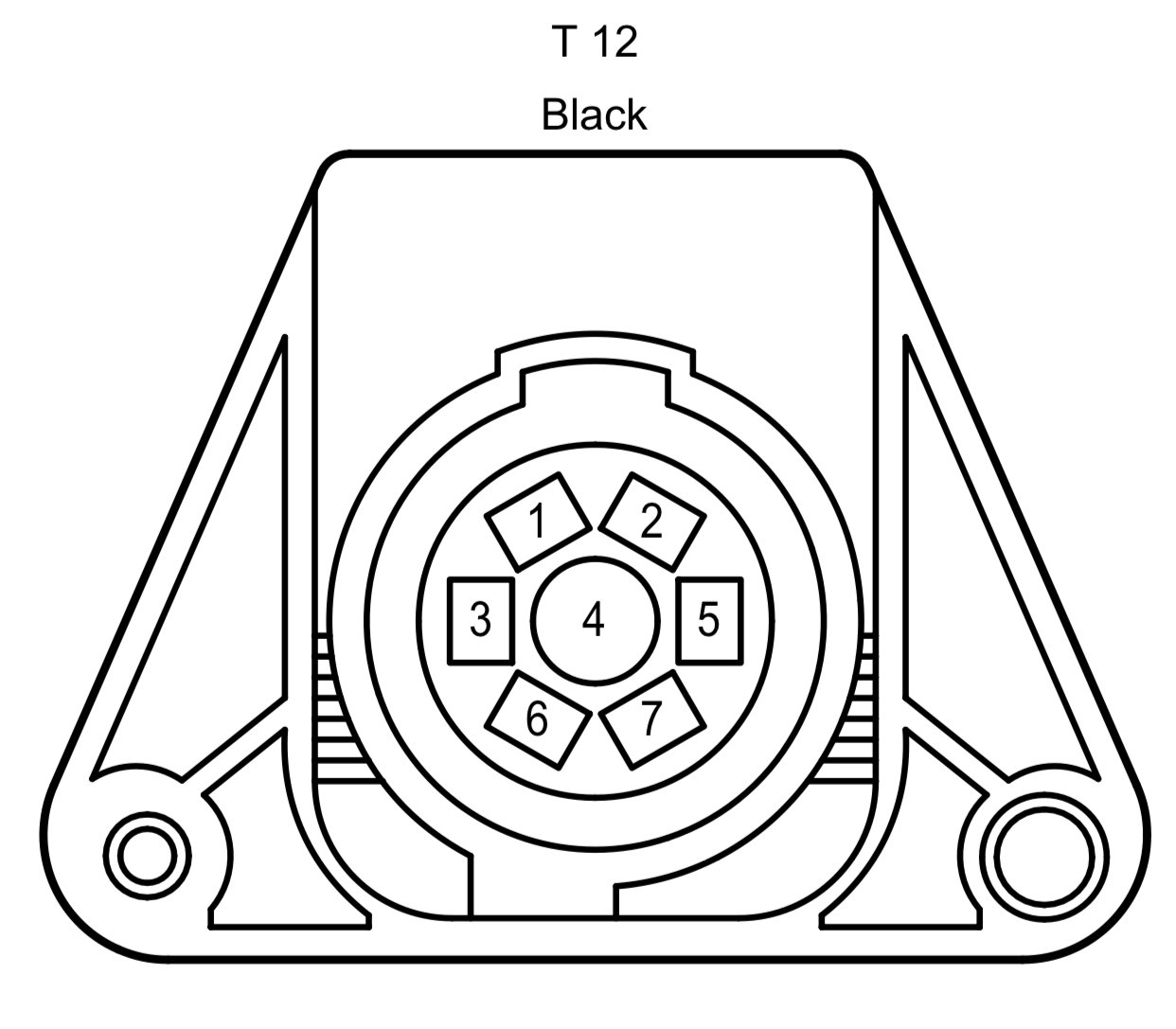

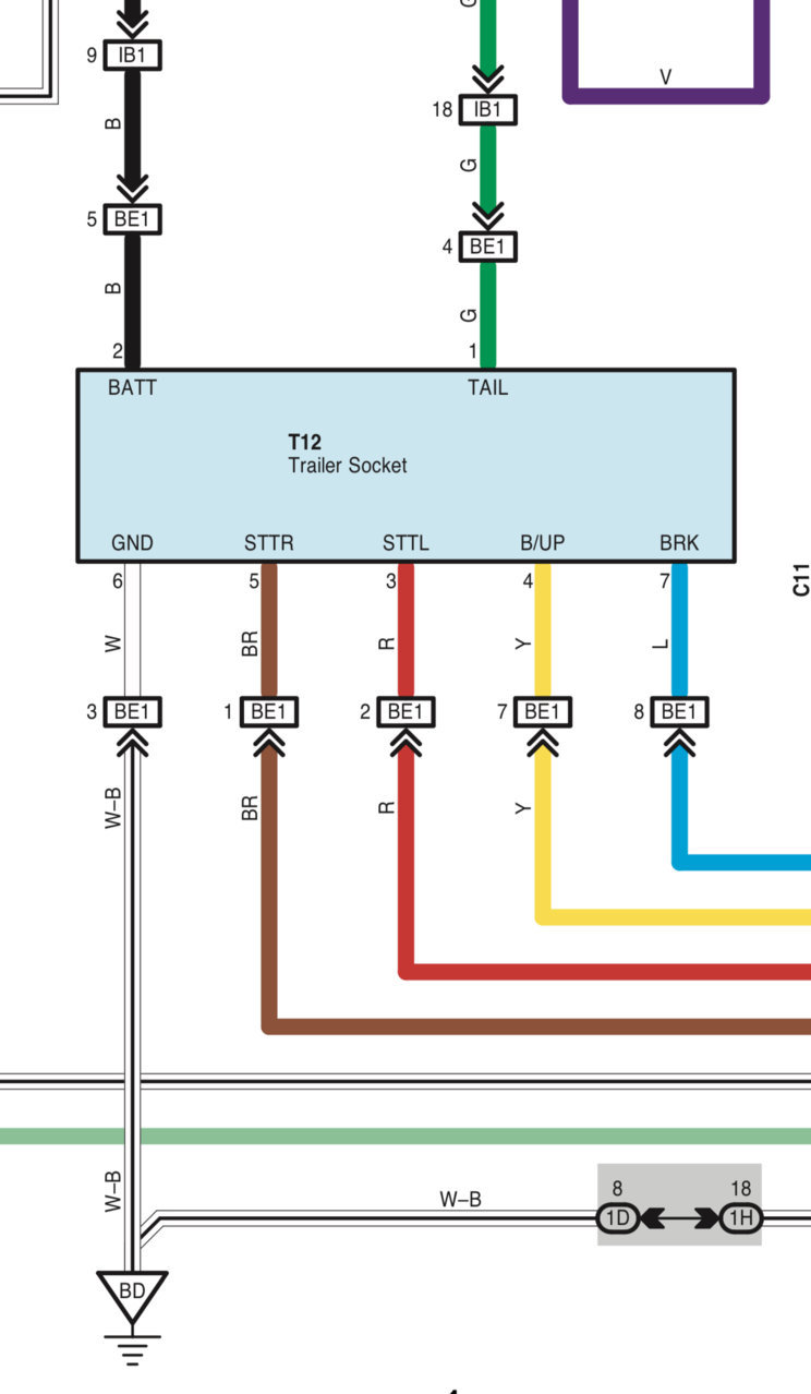

    Does anyone have the correct wiring diagram for the 7 pin for this year????

    Unplug at BE1 and check for continuity between pins for a short.
