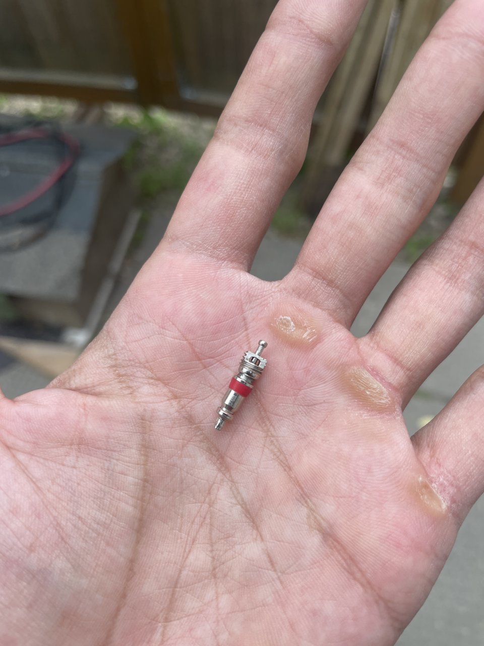

    I put a skull cap on it ceased .. the valve stem came out and will not thread back in.. what are my options??
    need response ASAP

    Do you have a spare? A tire shop can install a new valve stem for you

    I have a spare tire yeah .. I guess pop it on and drive to tire shop? Can I take the valve stem out of my spare and put in the real tire? Or is that silly

    Definitely silly, you have to break the bead loose to pull the stem. Just use your spare and drive over. Even if the spare is a different size you should be OK if it's on the front

    The valve stem is mounted from inside the wheel, therefore the tire must be removed first.

    It's hard to decipher what components you're actually saying. Is it the internal spring loaded core or the whole valve stem?

    Just to be clear - are you speaking about the valve stem or the valve core (the little valve that screws into the valve stem)?
    Edit: If it's the latter as your picture suggests, just screw it back in and reinflate the tire. Some valve stem caps actually have the little prongs used to screw in the core.

    Ya bad move at 32 - cheap shit and ceased on my tire stem

    All you need to do is screw the core back in and air the tire up. Of course i am guessing you dont have the right tool.

    20-30 to fix unless they need to replace the tpms. Then about 80.
