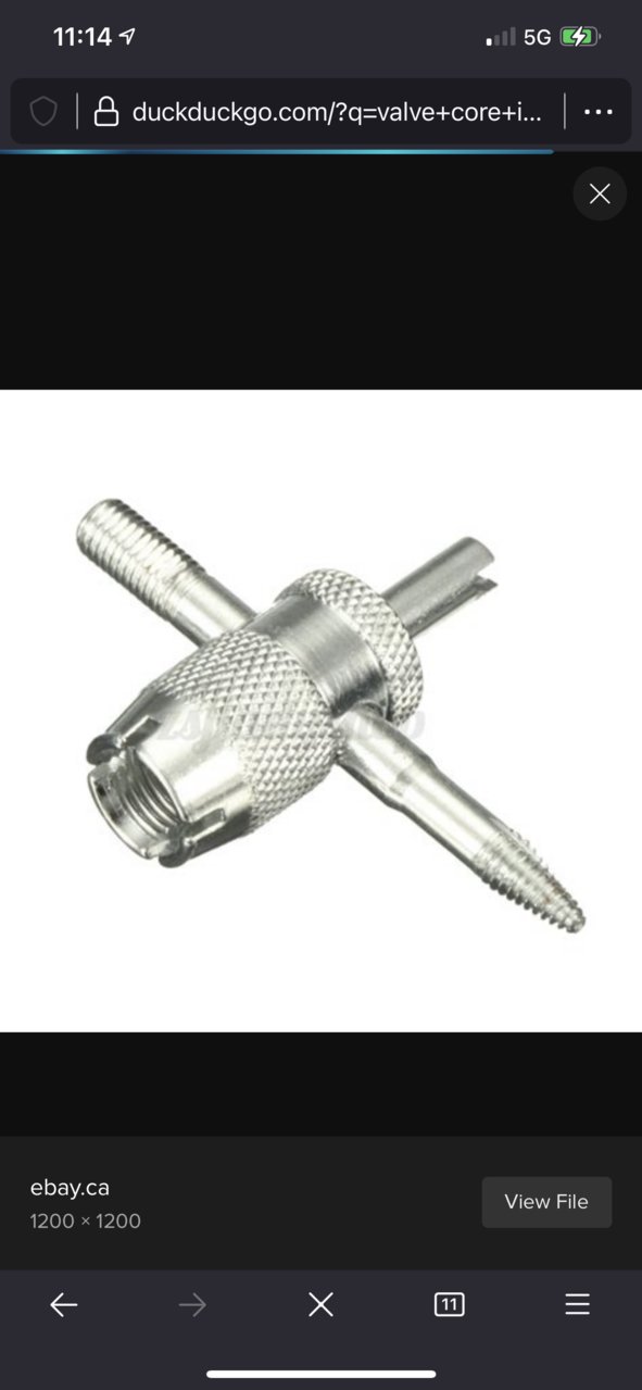

    I don’t have the right tool go figure .. I thought I did but apparently not, also, no tool for the tire my dealership never gave me one.. I have a set of wheel
    Locks (5 pack) no key tho .. anyways I’m towed to a fountain tire. Yippie

    Core fell out. Get a valve tool and put it back in.

    Small needle nose pliers will work in a pinch for the core. Just use them like a little spanner wrench, no need to close them tight.

    Plumbing section at Home Depot has a Klein 11-1 that has a valve stem tool on it.

    Any bicycle shop will have a tool to reinstall the core with too.
    You're looking at a kerfuffle you can turn in to a DIY learning lesson for under $5.

    U just need a valve core tool and maybe a new valve core, u can get the tool at walmart for like 2 bucks

    True. But most shops are capable of repairing big box store bikes too.
    Any auto parts store, anyplace you can buy standard bike tubes (WalMart, Target, etc) likely have them as well.
    This is not a difficult venture.

    Wow I called a bike shop and inquired, you are correct damn I learned this too haha .. I have a mountain bike so I’m going to pick that tool up from the bike shop $18

    IF you have Presta valves in your MB it won't fit the truck and the bike both, unless it has some type of dual head like @JasonLee shows above.
    And $18 is robbery for a standard tool. Folks seem to think when they put 'bike', 'marine' or 'aviation' in front of a product name the price should quadruple.
