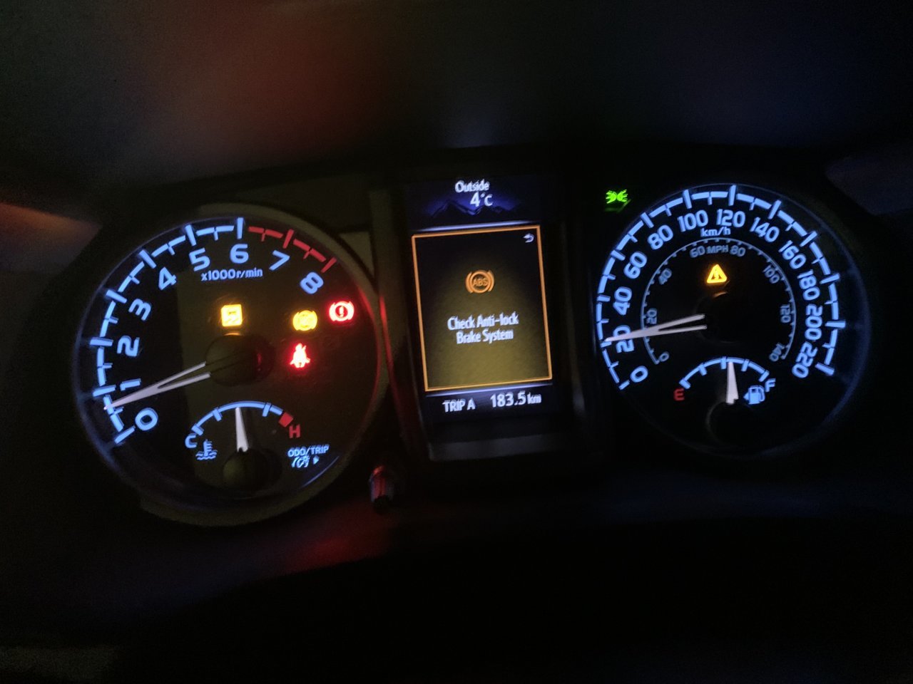

    Hello TW, need your help again.
    Went wheeling with my group, going there was fantastic, going back was an absolute nightmare. I thought I was gonna stay the night in the woods, not a good feeling.

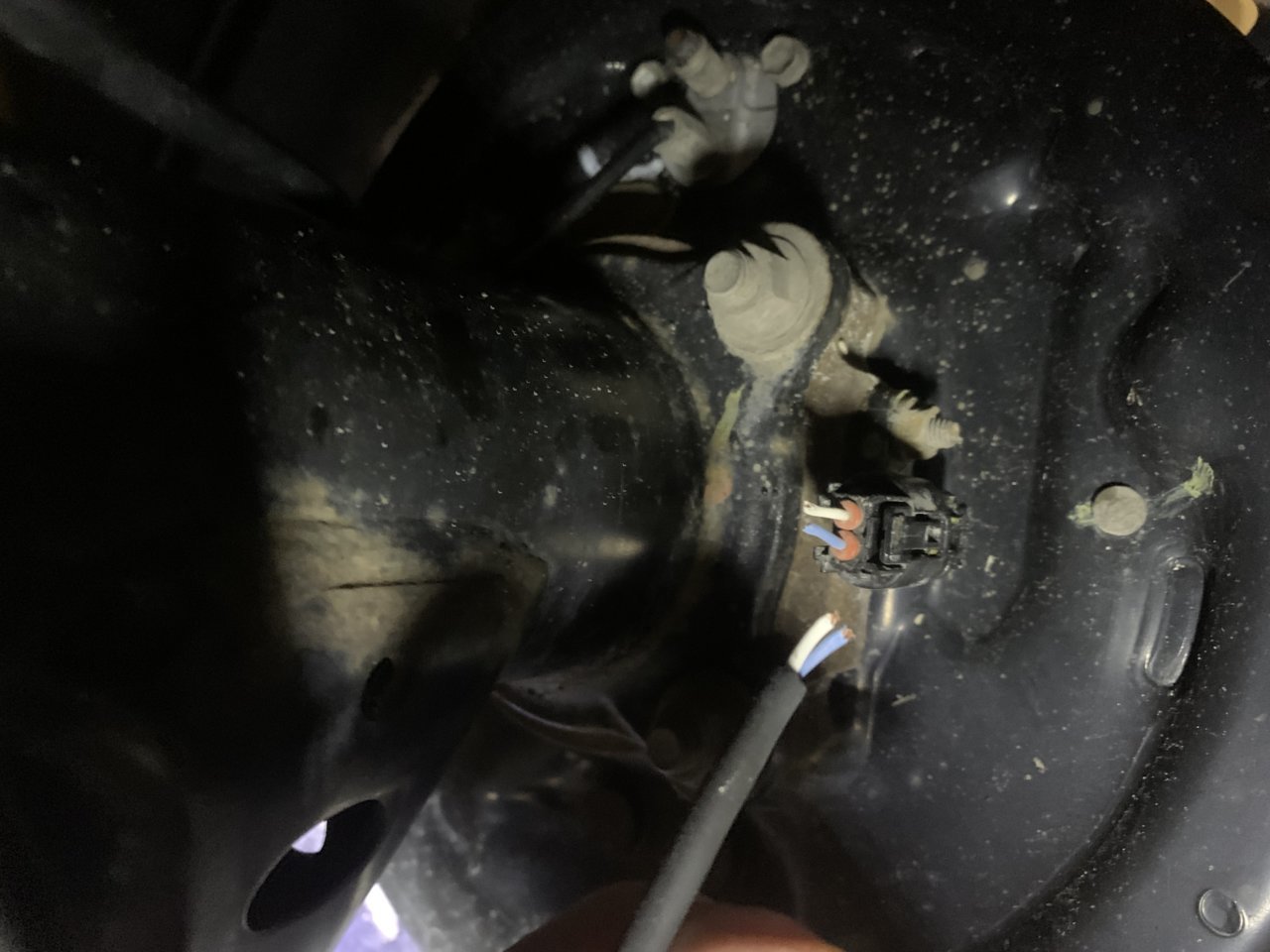

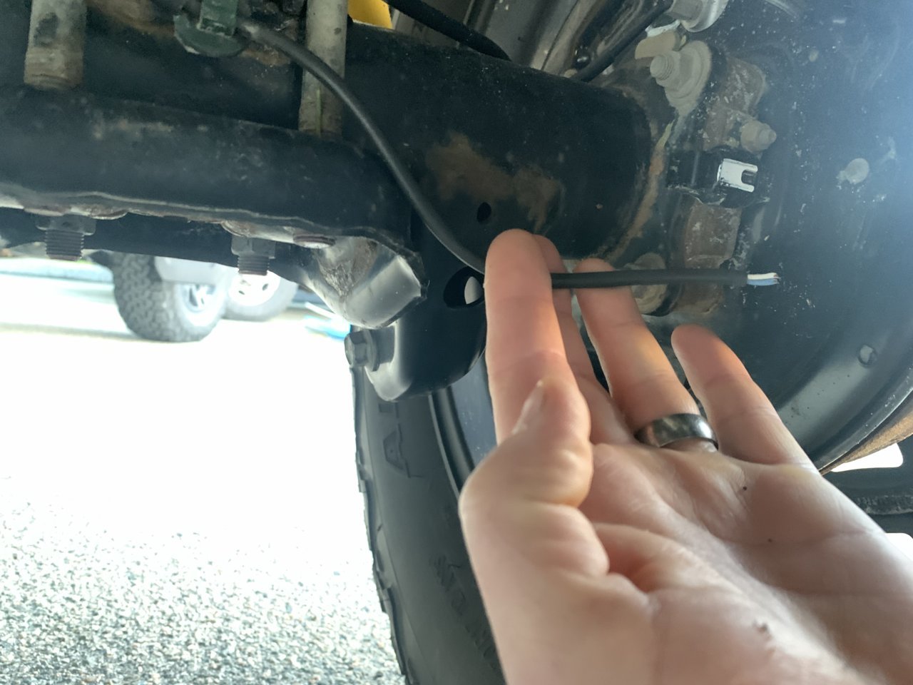

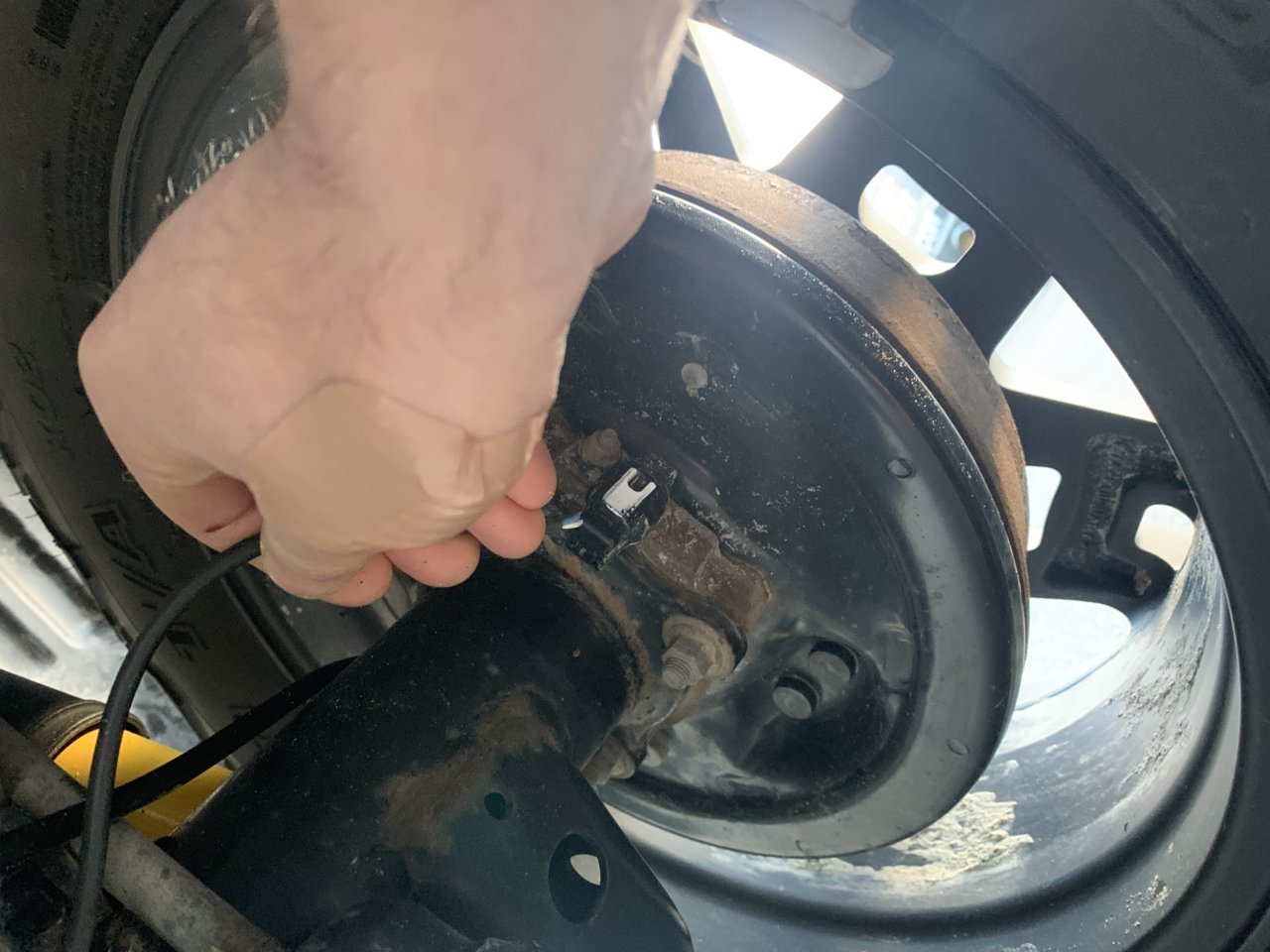

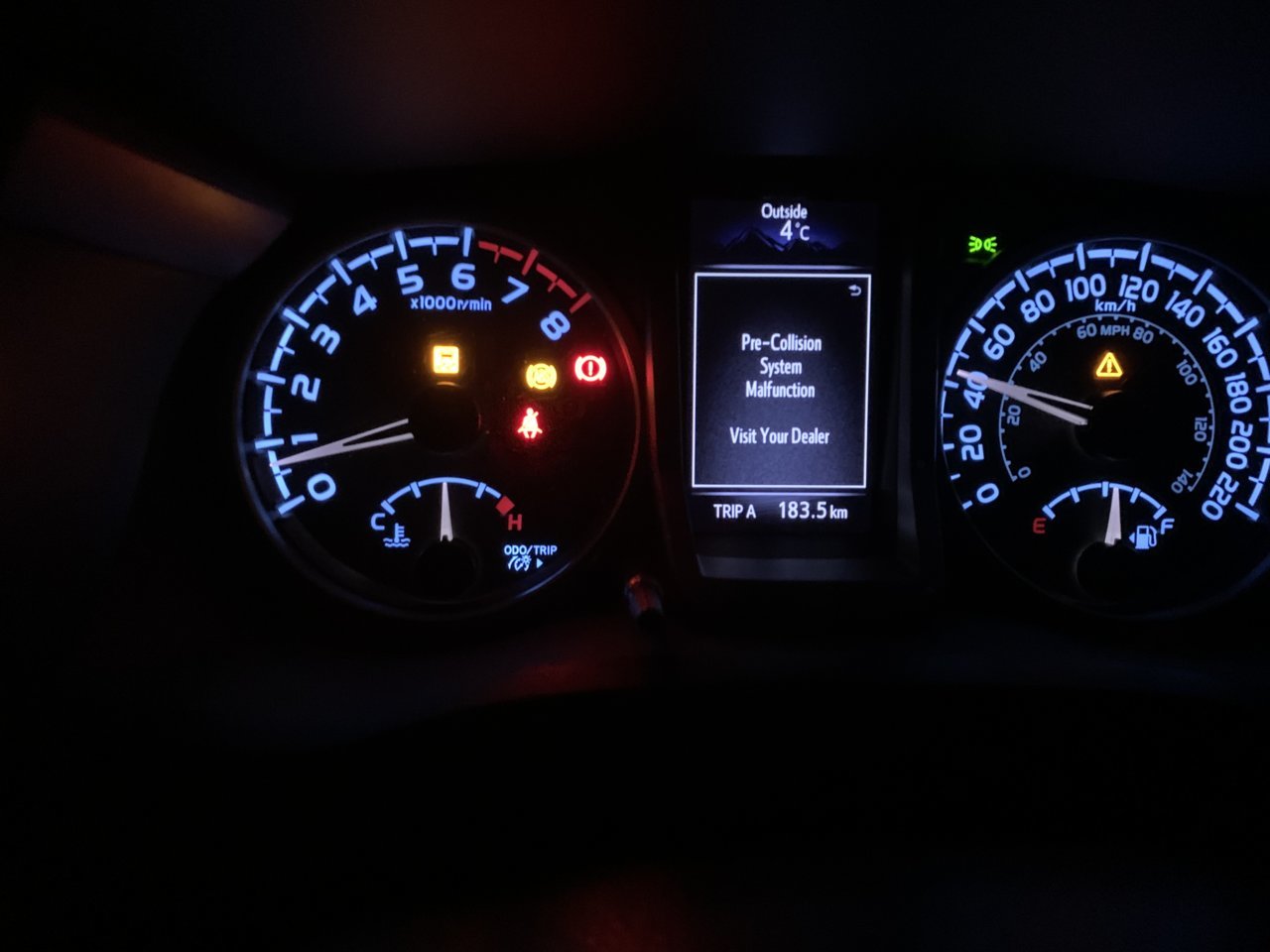

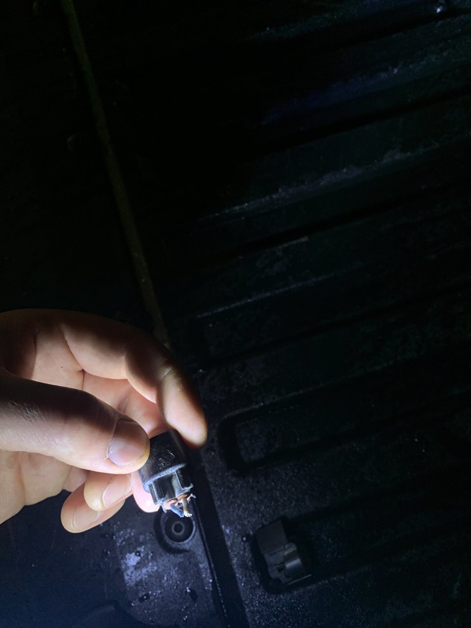

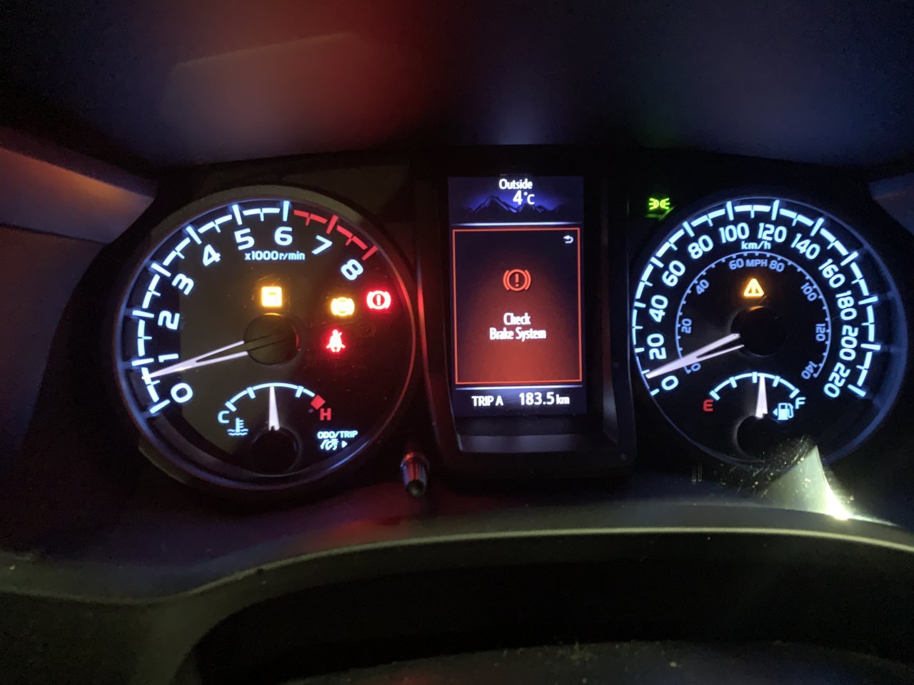

    Anyways, I managed to wrap a kinetic rope around my rear axle and ripped what I understand is an ABS/wheel speed sensor wire? Can someone confirm that? I took a look underneath today to see where I need to unplug the harness but couldn’t really see. I’ve got no ABS brakes, and my brakes feel a bit different. The truck still stops fine though.
    Sucks I have to work right now, otherwise i would be crawling under my truck right now. I tried using the car scanner app but no codes, I’ll need to hook up tech steam when I get home.
    Does anyone have experience or tips replacing this harness? And is it actually ABS/wheel speed sensor? Thanks guys.

    I've never had to touch that but if there some slack you can probably just repin the wire and reuse the plug. Would be much easier than replacing the entire harness. If not enough slack (or you don't wanna crimp) they also sell those connectors with wire on them already or you could just get the connector as a pigtail and solder it on.
    I don't know these are the proper connectors but should be something like this. Don't want to link you to the wrong parts... so this is just more of an idea of what it may look like.
    https://www.mouser.com/ProductDetail/TE-Connectivity-AMP/175265-1?qs=AplfTeSvkkBL3BcjZdHR5Q==&mgh=1&gclid=Cj0KCQiArt6PBhCoARIsAMF5wag70LEhdb-tFc8smhfgBDpZYosIiNN0bJkwKdbDR_TM44ueis-OTPwaAnKOEALw_wcB

    Thanks for the advice, that might not be a bad idea. I’ll need to have a better look when I get home today.
    Although I found a harness for a 100$ at the dealer. Hmm

    Same dash lights went off when I broke my rear left sensor. From picture it looks like the wires just pulled out or broke from connector. Can you unplug the connector and maybe splice it back in?

    If you've never done it before those terminals are really easy to crimp and just slide into the housing once you remove the old ones. It's something useful to learn and the connectors are really cheap.
    And worst case if you mess it up you just replace the entire harness for the 100 bucks. Only thing you can you really do wrong is flip the wires. Hopefully when you pull the old connectors out there still some of wire cover on there so you can easily see what color goes where.

    I’m going to pick up my truck now, so I’ll see if I can unplug it and splice it back in.
    I’ve called a few places and seems like the harness its out of stock, of course it is…

    So I took apart the plug and found some hope inside, 5/16” to be exact. Do you guys think it’s a good idea to try to splice them together? Or try to rewire the plug somehow, is it even possible?
    I tried to chase to where the harness unplugs but it’s somewhere way up under the bed, and looks like they are at least 200$, not 100$.

    Yeah a bit of a bummer but at least I know I can fix it without probably buying a new harness.

    Could just try to sodder off the short lead on the connecter, and see if it works. If not just repin the connector like said above! Probably blew a fuse as well, happened to me the other day. Pinched abs wire that I couldnt find and thought I had bigger issues

    So my neighbour and I took apart the plug and we will re pin the connector, doesn’t look hard at all actually.

    Late to the party, but I soldered mine together after breaking the wires. Been fine for years.

    That's a good idea and it should work. You may also need to clear the associated ABS codes once the repair has been completed.

    My bulldog chased a squirrel up into my wheel well about a year ago. She tore the abs wire loose and I just soldered it and used shrink tube. No issues. That being said I did have a little bit more wire than you do. Good luck! Can't hurt to try. If it doesn't work you can still get the new harness.
