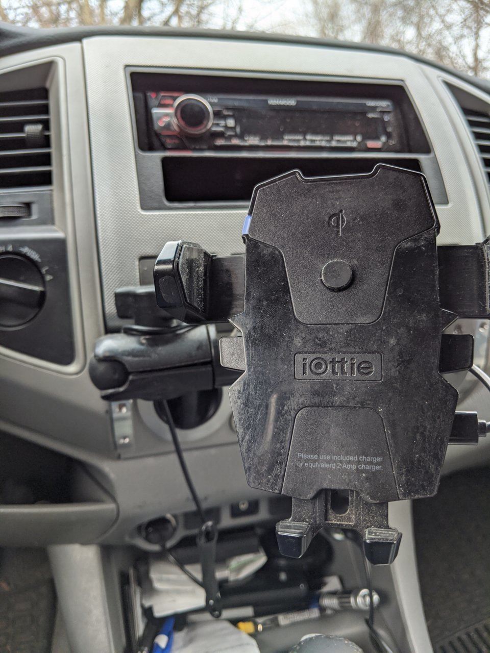

    @Larzzzz those aren’t available any longer, right? I’ve seen those and long considered them, I have this complex with blocking the removal of the HVAC controls (regardless of how frequently I actually remove them). It’s definitely not a big deal but has been enough to keep me looking for better options.
    @trdtacojef - agree. Mounting location has been my issue with all the other solutions. I’m not really interested in cluttering up the center stack or blocking parts of it.
    May the moment I’m using a clutch it mag mount which has by far been the best solution I’ve personally used. My magnet is placed just below the passenger side center vent and the double articulating arm allows me to position in a great spot where I don’t have to look too far down to see it like you would in a cup holder mount and it doesn’t block anything.

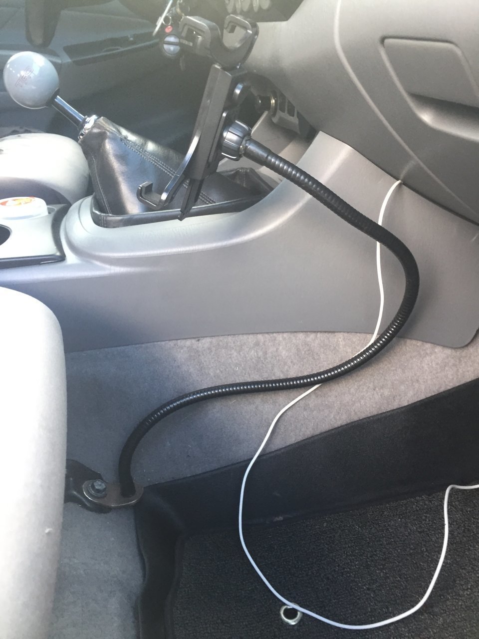

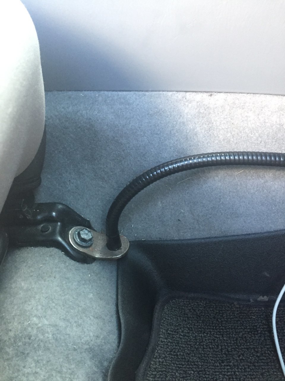

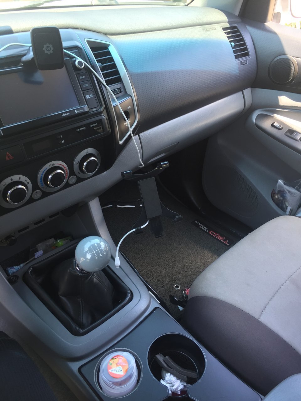

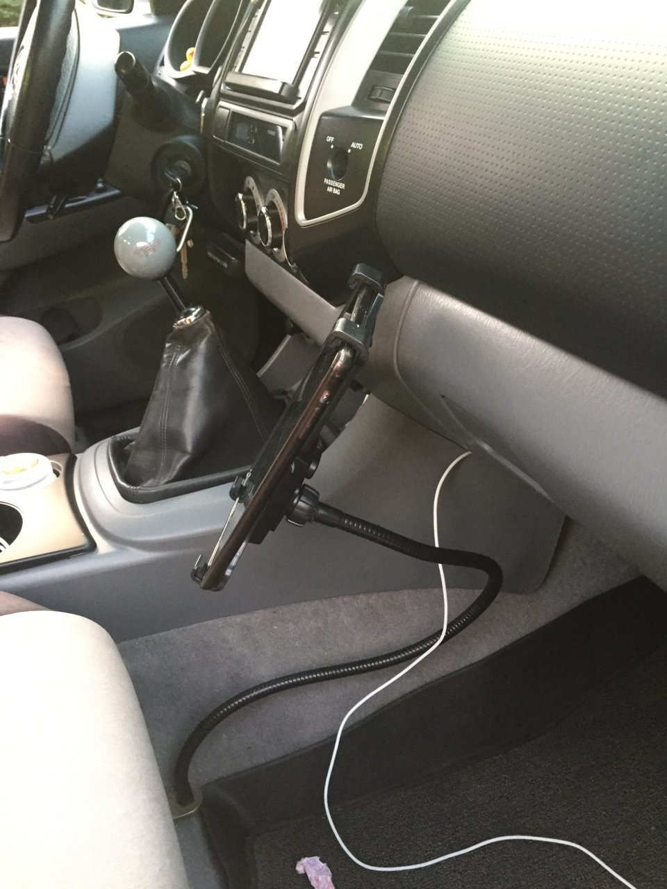

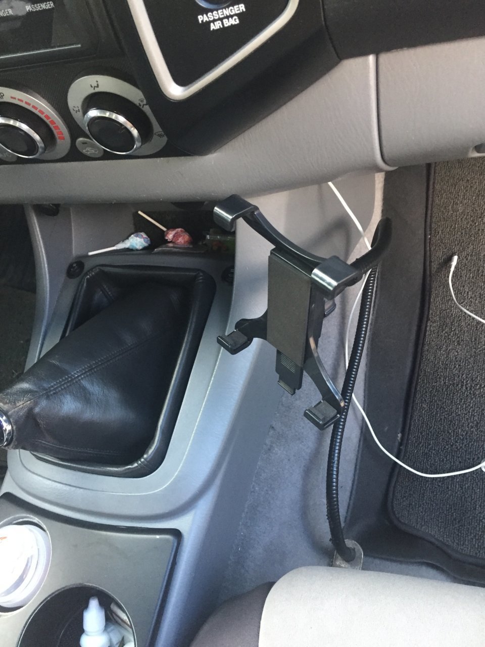

    My solution for my iPad.
    I didn’t want to clutter the console either because it’s a 6 speed
    It’ll flex up to radio height
    You can see my phone mount in the last picture too

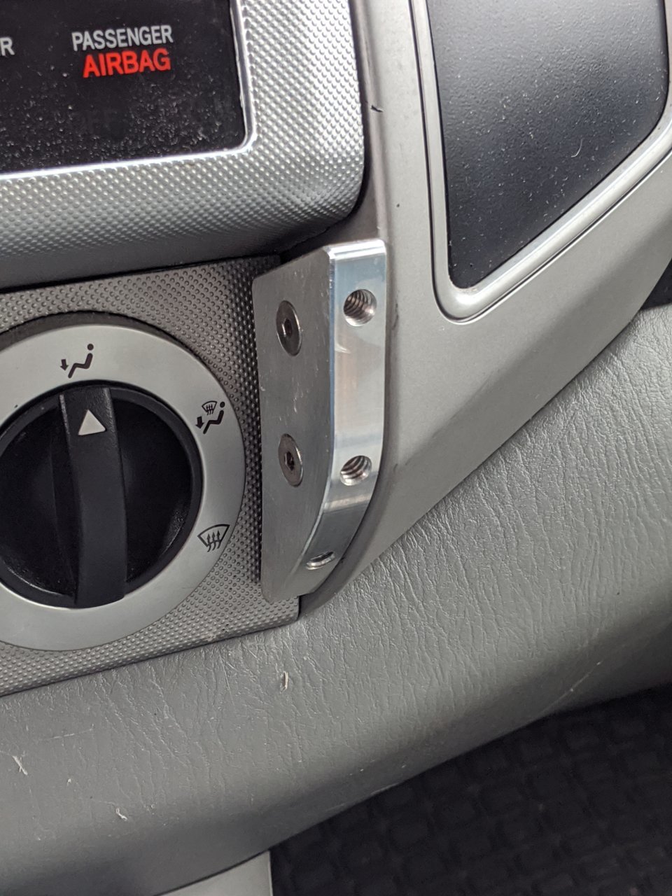

    4 screws isn't much to get at the HVAC controls. He provided mounting hardware and the nut was actually a plate, dropped and tapped.
    @Lostsheep you got any of those mounts left?
