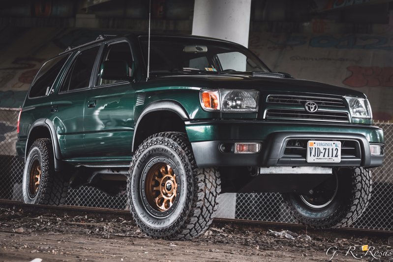

    Current pic:
    11OCT16
    10JUL16

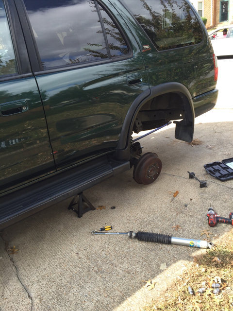

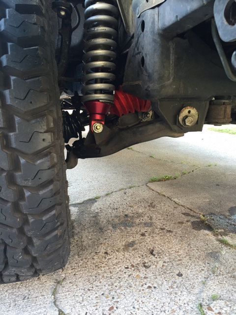

    After basic maintenance, fun began.
    Bilstein 5100's and OME 890's in the rear:

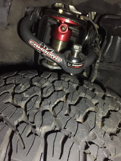

    Camburg UCA's and SAW 2.0 Racerunner's in the front.

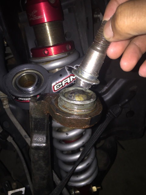

    Removing and installing the UCA's was no fun. I spent hours trying to get the UBJ's to work with me. Ended up grinding the bolt off to get me more room for the press and smacking it out with a BFH shown here:
    Mounted some Cooper ST Maxx 285/75/16's

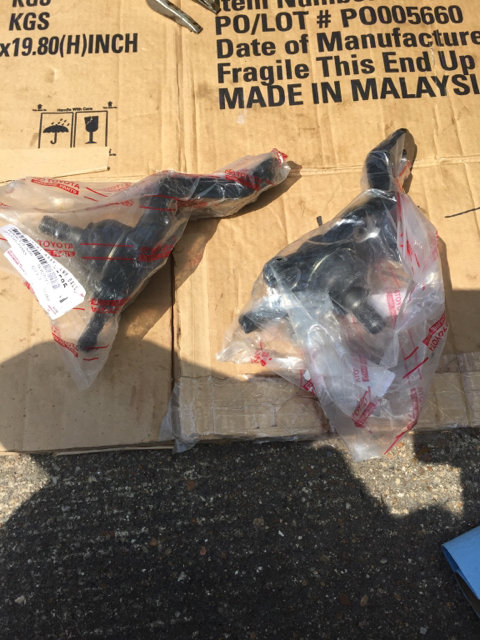

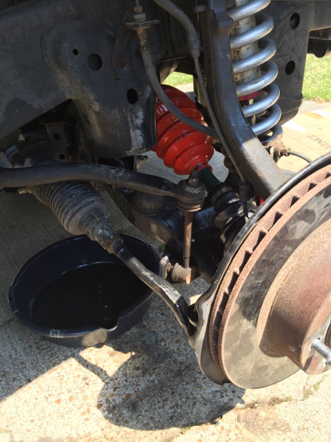

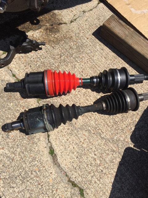

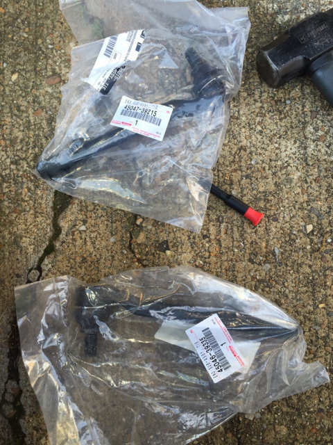

    Had some leaky CV's after a while and hopped on some CVJ's and also threw some OEM LBJ's in there. While doing so, I ripped the boot off the OTRE's. Whatever, new OEM outers as well.

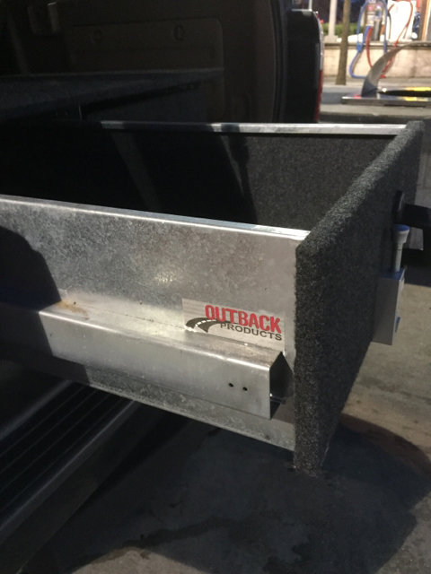

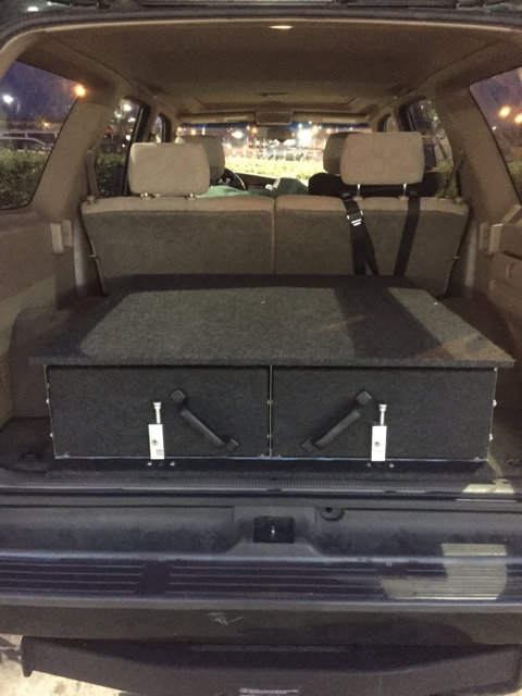

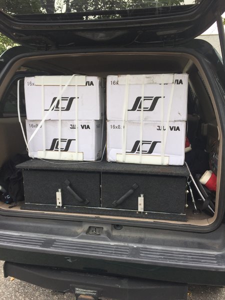

    Forgot to add these...
    Love these things by outback products.
    I'd love to make it a sleeping platform and to complete the sides to cover it all but I'll leave that for another day.

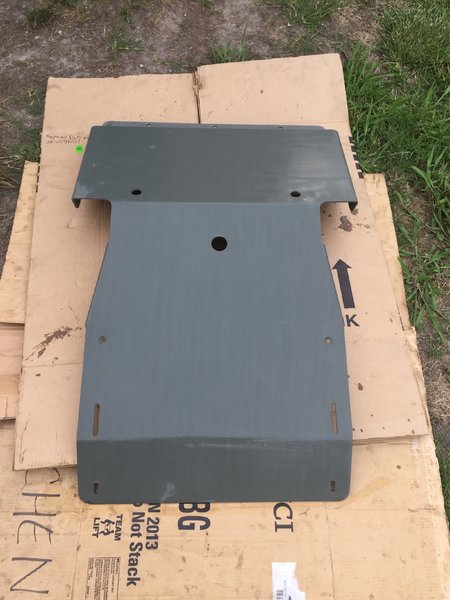

    Picked up a brand new budbuilt front skid for 175. Have to call budbuilt for hardware and the steering rack mount.

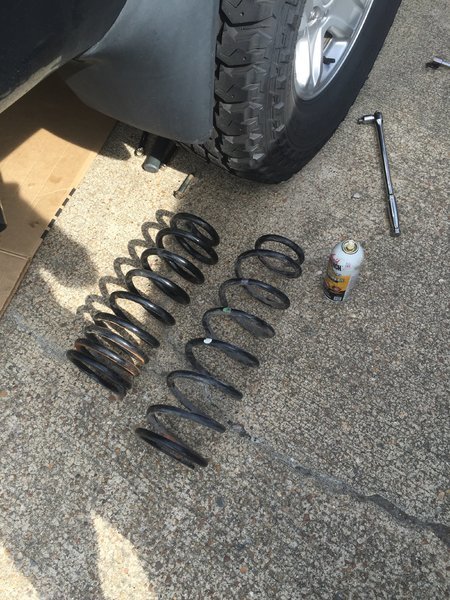

    Switched out OME 890 springs for LC 8 wraps. It's now sitting just as I wanted it.
