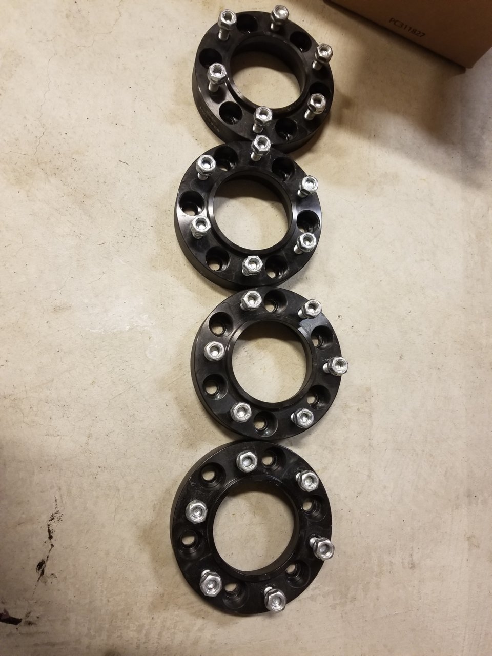

    Are you still running the wheel spacers? How did you know you needed to add them? I have been thinking I may need to add a set. I'm currently running 295/70/17 KM3 with a 0 offset wheel. It sounds like in reverse while in full lock I may be hitting the UCA. Awesome build!

    I actually didn't need them at the time but was thinking about when I would eventually move up to 35s. Now that I have 35s I barely clear my UCAs with my tires. I have about a 1/4" of space. I'm contemplating putting it on there but if it causes more rubbing issues then I might trade/sell them. Have you cycled your suspension?

    if you are rubbing on the cab mount get your alignment done first. In the pic quoted your front cam is all the way out. By turning this in you will raise caster and move the wheel forward. It'll give you a extra room at the back of the wheel well.

    I'm pretty sure its the other way. You want your front cam bolt to face all the way inwards and the rear to face all the way outwards. We watched the tire move forward as we adjusted the cam bolts to get more clearance. I do have SPC UCAs that push the tire just a little bit back to gain more castor. I'm about 4' on both sides so I'm going to reduce castor up top to gain more clearance and push the tire further forwards.
