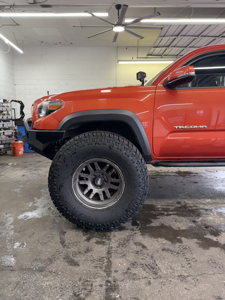

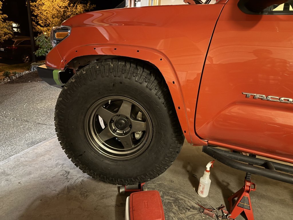

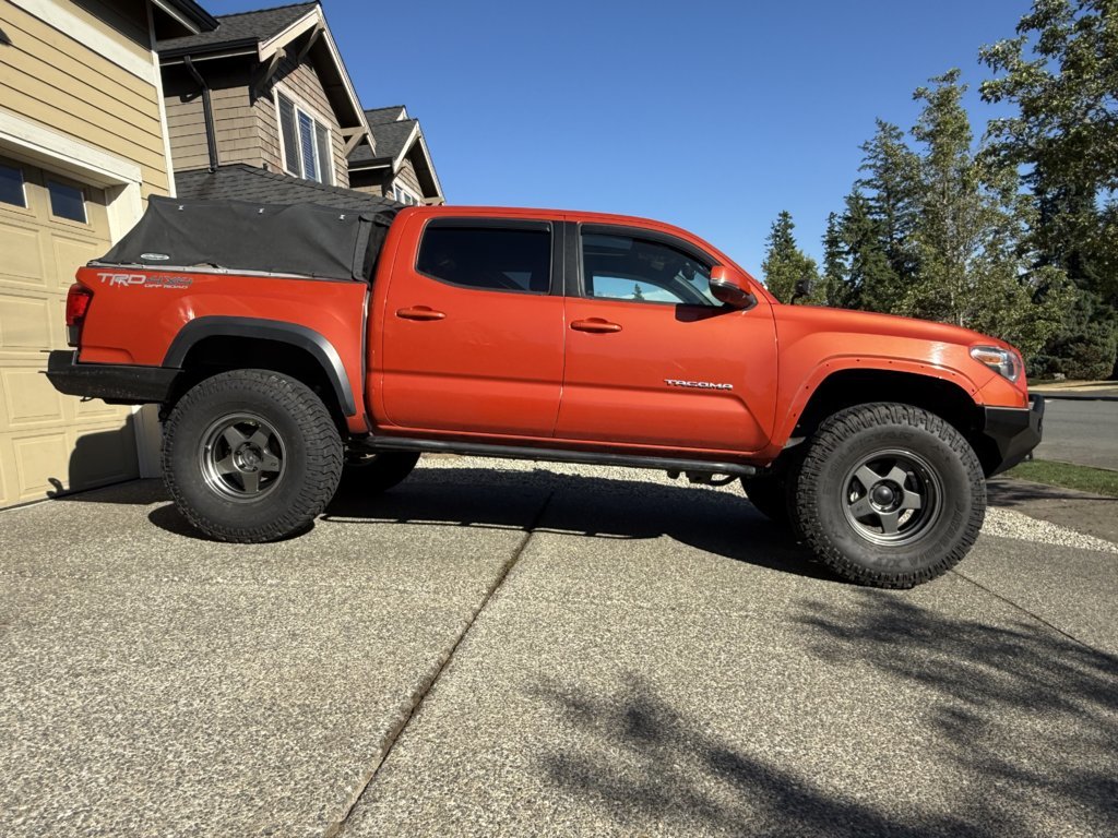

    However 37s are officially on the plate (37/12.5/17 Patagonia XT) and I’m starting to cut the fenders even more to get these mounted on in order to mall crawl before tubbing the fenders.

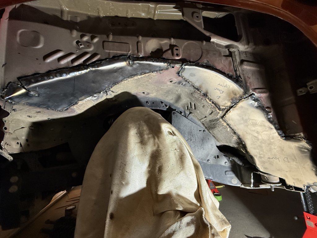

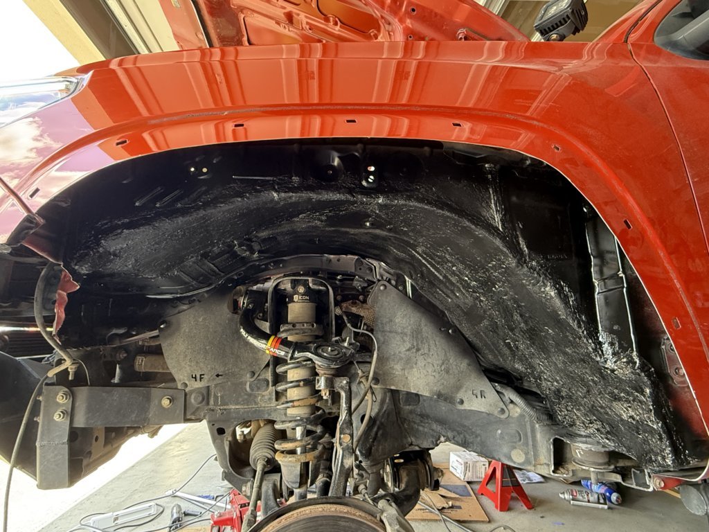

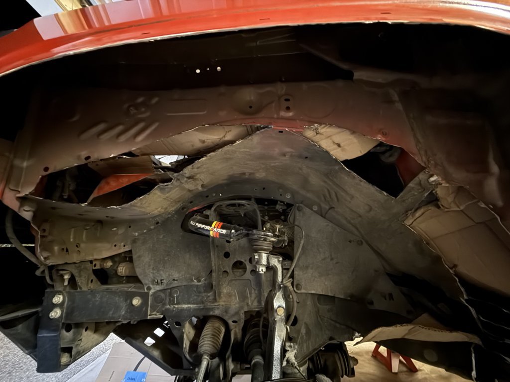

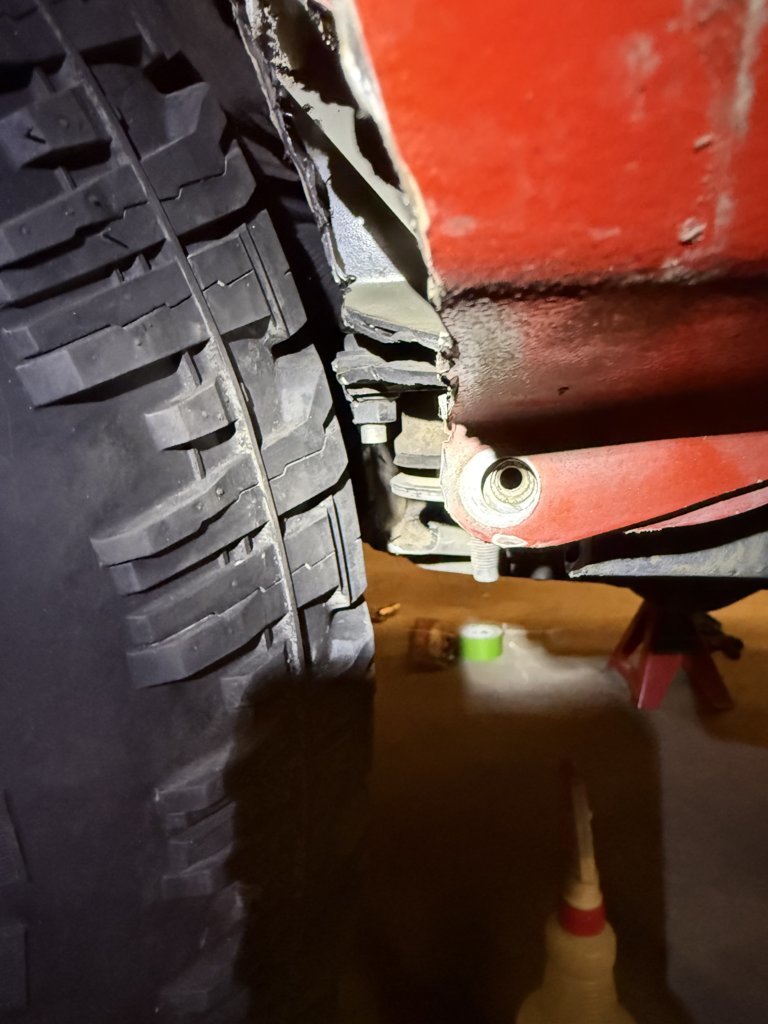

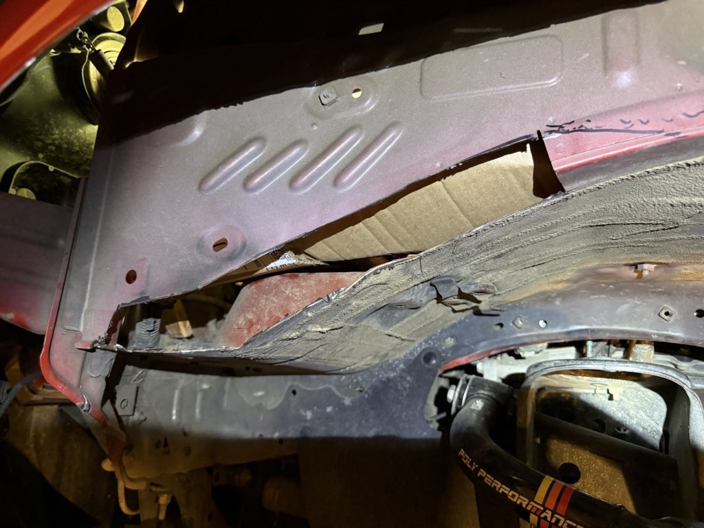

    The ass pain required to running 37s properly without long travel:
    Check for clearance lock to lock with bumpstops fully compressed. Mark areas that rub. Cut said areas. Check for clearance again. Cut new areas that rub. Repeat process ad nauseam until you fully clear or say fuck it good enough.
    Create templates for the gaps.
    Create fill plates for gaps.
    Weld, or hire a monkey to weld to new plates without burning the truck down.
    Relocate washer fluid reservoir and possibly battery.
    Seam seal and paint everything inside and out.
    Stare at the fruits of your labor and immediately want to go to 40s.

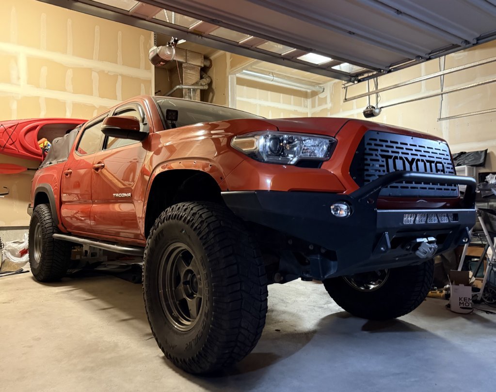

    That looks perfect!
    Even the 35s on my 4runner look tiny.
  12. Jul 2, 2025 at 9:30 AM
    #152
    rlx02
    rlx02 [OP] ¯\_(ツ)_/¯
    Sep 3, 2016
    #196329
    6,155
    Western WA
    2017 Inferno DCSB TRD OR 4x4
    Yeah, mine never felt like I really had 35s lol. Maybe because I only have like a 2” lift, who knows.

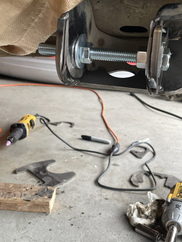

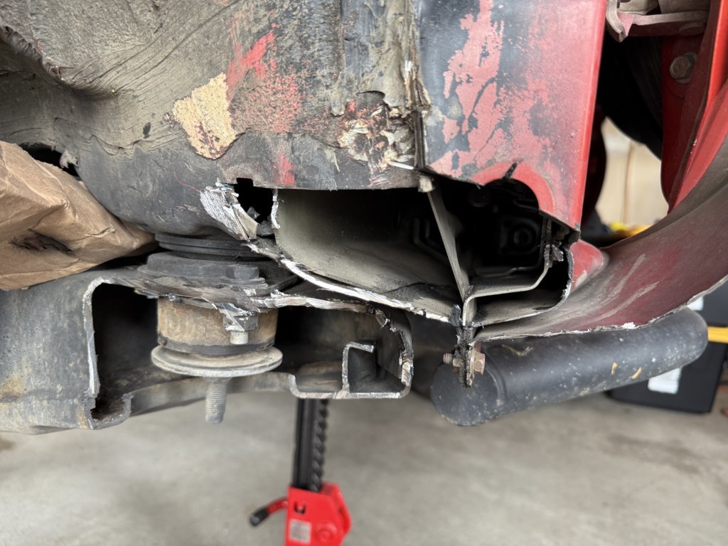

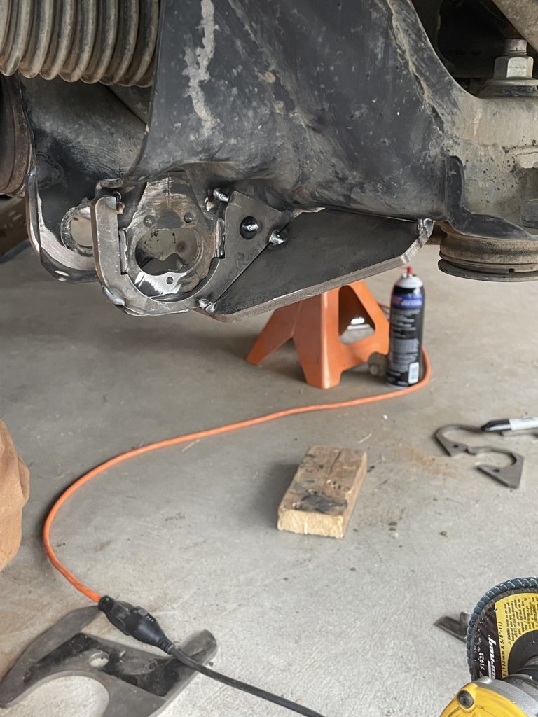

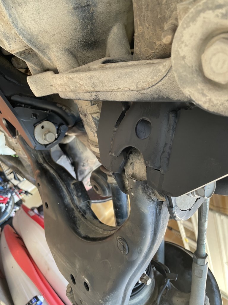

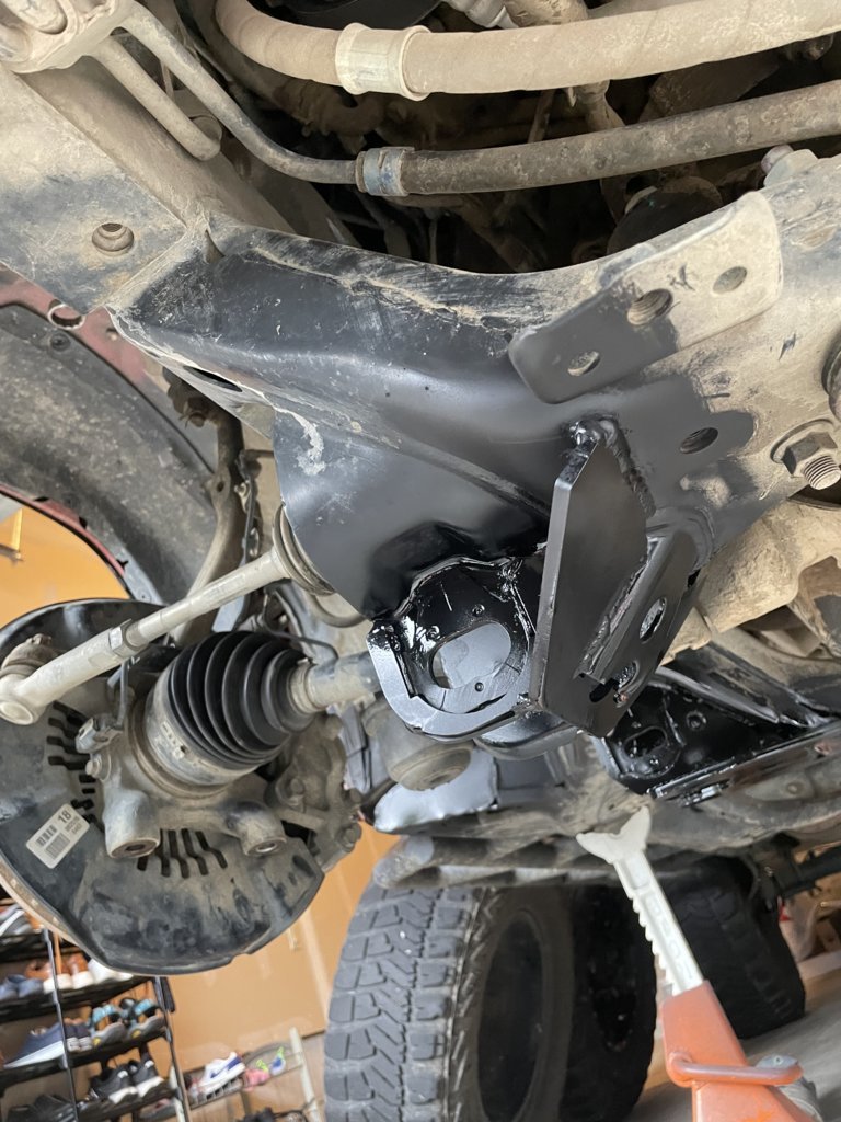

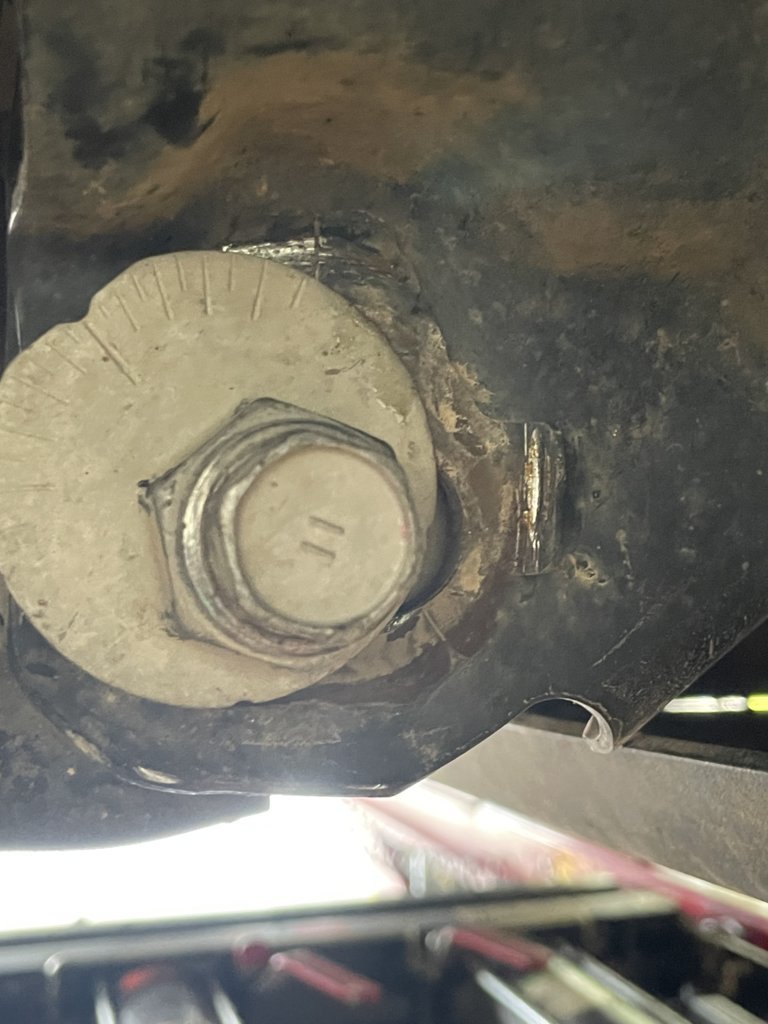

    Had a hard hit on last summer’s trip and flattened out my cam tab and threw my alignment off the whole trip. Looked into just welding a bead behind the tab, cam eliminator kits or just the gusset kit but ended up buying the MC LCA frame brace kit from a member here (can’t remember who it was) locally. MC says no modifications required but it definitely did not fit in some places without grinding some parts down. I’d give 7/10.
    Used some hardware to keep the lca mounts in place when welding it up. I think the directions say to leave the LCA in and put a wet towel over it but didn’t want to risk burning the bushings.
    Annoyingly, you will need to notch out a section of your LCA brace/skid if you want full droop (without your coilovers in) too. Some long travel guys were modding their LCAs instead as well I think.

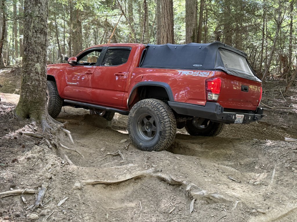

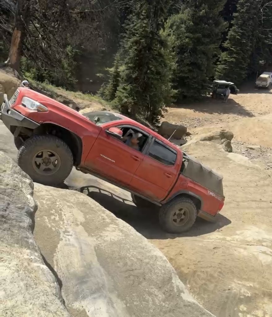

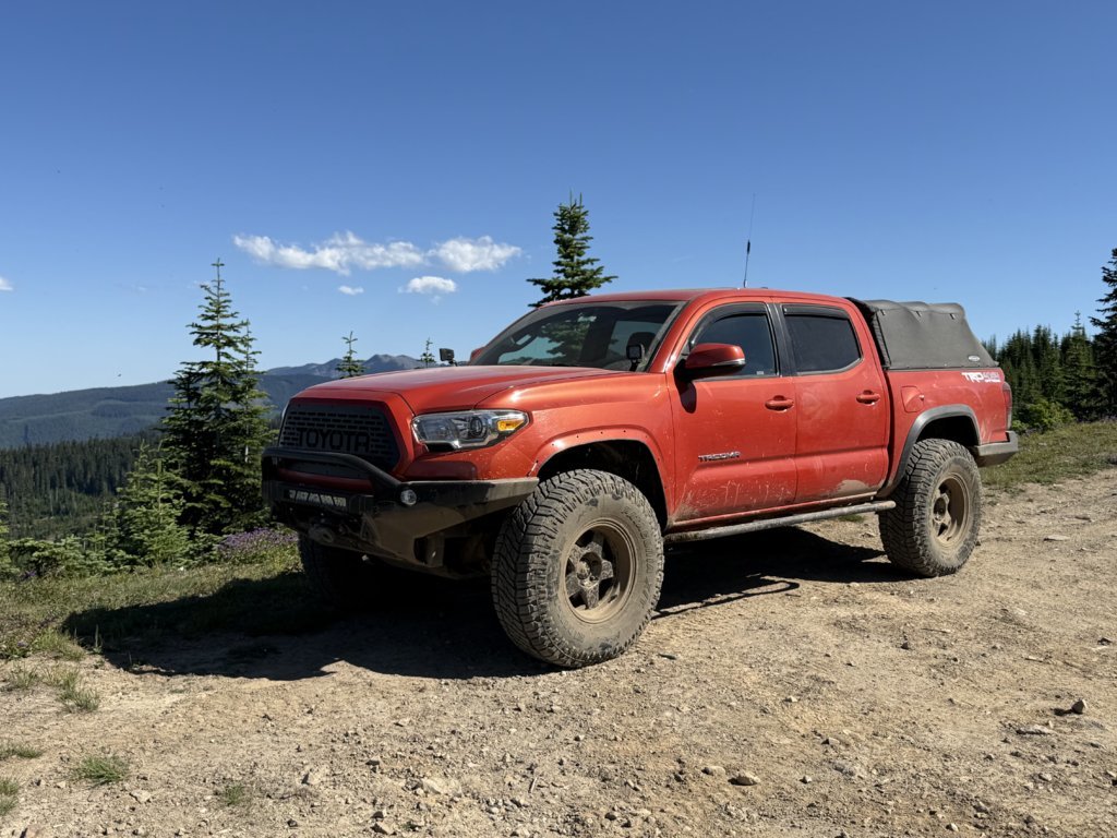

    Few pics from a recent wheeling and camping trip. 37s made a big difference just crawling over the biggest rocks on the trail and avoiding a lot of wheel damage to my new Gen 5s. Stock travel still sucks and I definitely need a front locker in the future.

    Looks badass. Nice job climbing that rock hill. What trail is this?
    rlx02[QUOTED][OP] likes this.
  18. Jul 28, 2025 at 2:15 PM
    #158
    rlx02
    Sep 3, 2016
    #196329
    6,155
    Western WA
    I actually failed that line lol. I shoulda aired down a little more and used some more speed to bump up the rear over that ledge but didn’t want to risk breaking something.
