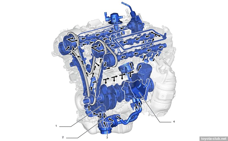

    At upper right:

    What is directly under the fill spout? I thought there was some sort of baffle although obviously not designed for catching oil during crankcase ventilation I am hoping it will have some effect. I would still personally run this with a catch can.
    It does appear that crankcase ventilation is being short circuited so the drivers side cylinders are not well ventilated which would result in more vapors condensing and entering the oil.Probably not a huge issue if you aren't trying to stretch your oil change interval but I would personally not be comfortable doing more than 5k when running this. Some oil testing may help determine its overall effect.
    With this kit we are basically just moving the PCV connection from one corner to the other. Drainback under the oil filler should be significantly better though and the height of the filler neck likely acts as good buffer. I wonder if some sort of riser creating a buffer under the PCV valve would be helpful. If you did it after the PCV would the PCV prevent the oil from flowing back into the engine? Although if you are bothering to make a riser might as well throw a hose on it to have it drain back to the oil pan.... Of course then you need to add a fitting somewhere for it to drain into.
