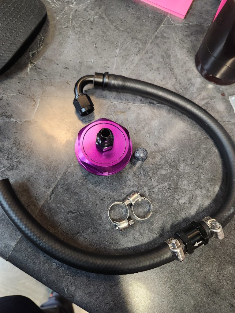

    TW I have a question regarding PCV reroute I'm wondering whats your thought on installing PCV reroute kit from RM Engineering i dont see many people reviewing it besides 2 videos on YouTube.

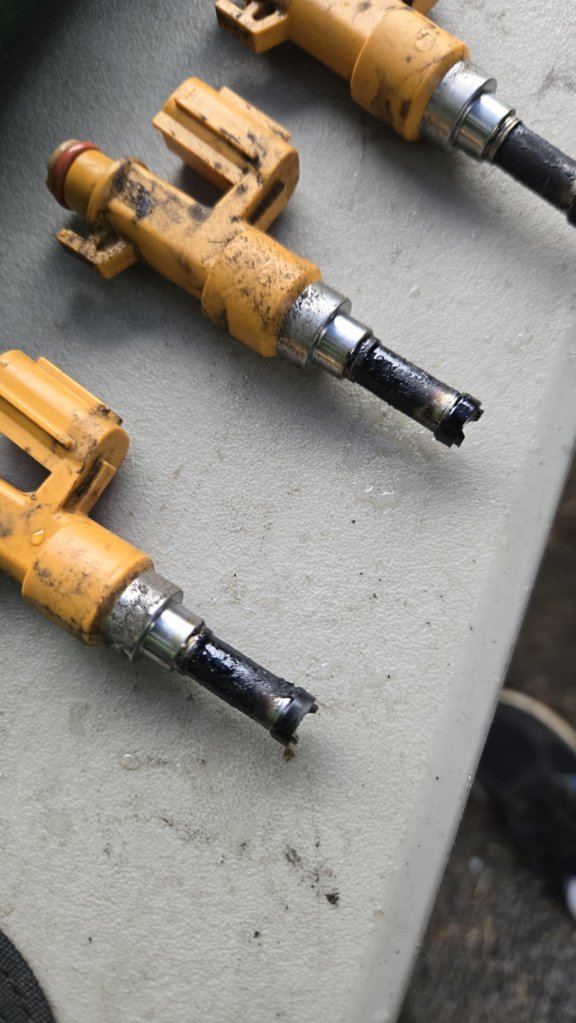

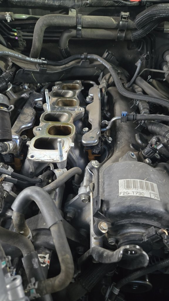

    I just bought this and I am putting it in this weekend. 1/18125 The pcv on the 3rd gens are a terrible design! should be recalled! Ive bough 2 brand new. Both threw oil into my intake. Coated my injectors with oil. clogged one of them. it threw a 174 171 and a 117b code. its been hell tracking this down. Ive replaced the mass air sensor. cleaned throttle body, bought new throttle body. revs would get hung up after all this. bought a new gas pedal. it wasnt util I took the intake plentum off I saw the oil and went for the injectors. cleaned all of it up. replaced the pcv at that time. drove it 2 days about 100 miles. checked the pcv hose.. full of oil. replaced the pcv again.. same results.. the pcv shouldnt be sideways Bought the reroute after some investigating.. My taco is lucky to be alive still. I hope this fixes my problem! I will upload a couple of my photos once Im off work

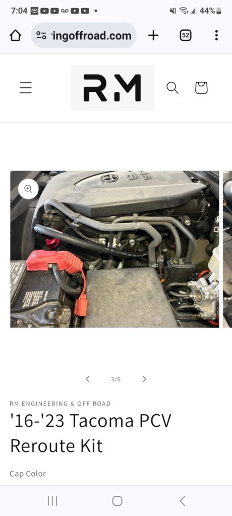

    ^I see @MrMustacho has done it in Nov: https://www.tacomaworld.com/posts/30291070 Looks like a decent enough kit except you have to unscrew the hose with every oil change.
    Be sure to route the hose so it clears the battery. Don't want the battery knocking the oil filler neck off its mounting base.
