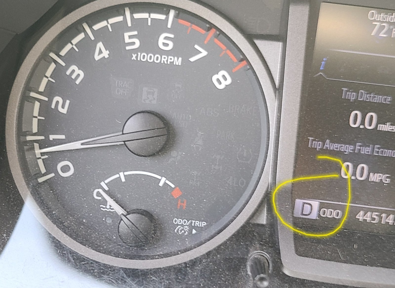

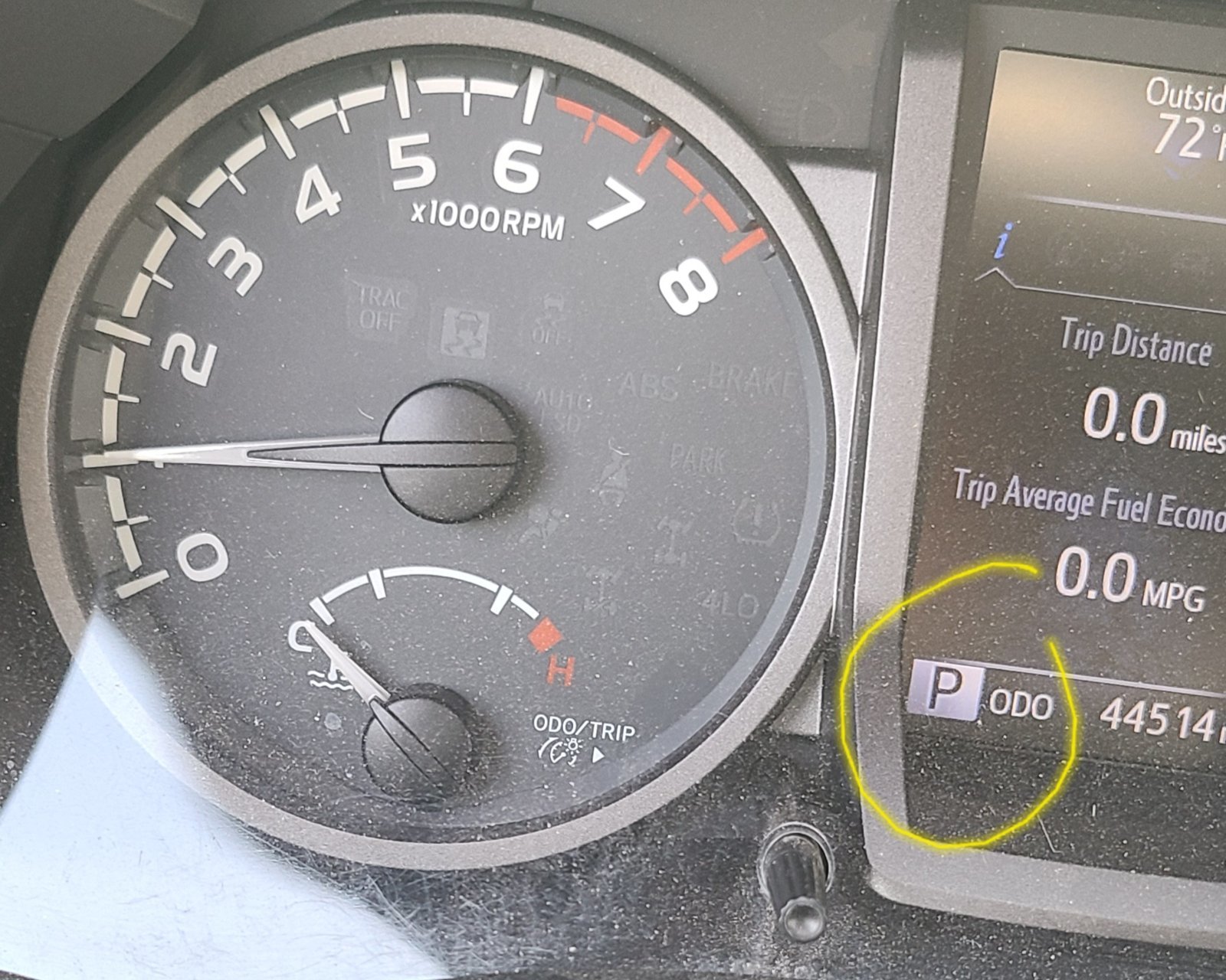

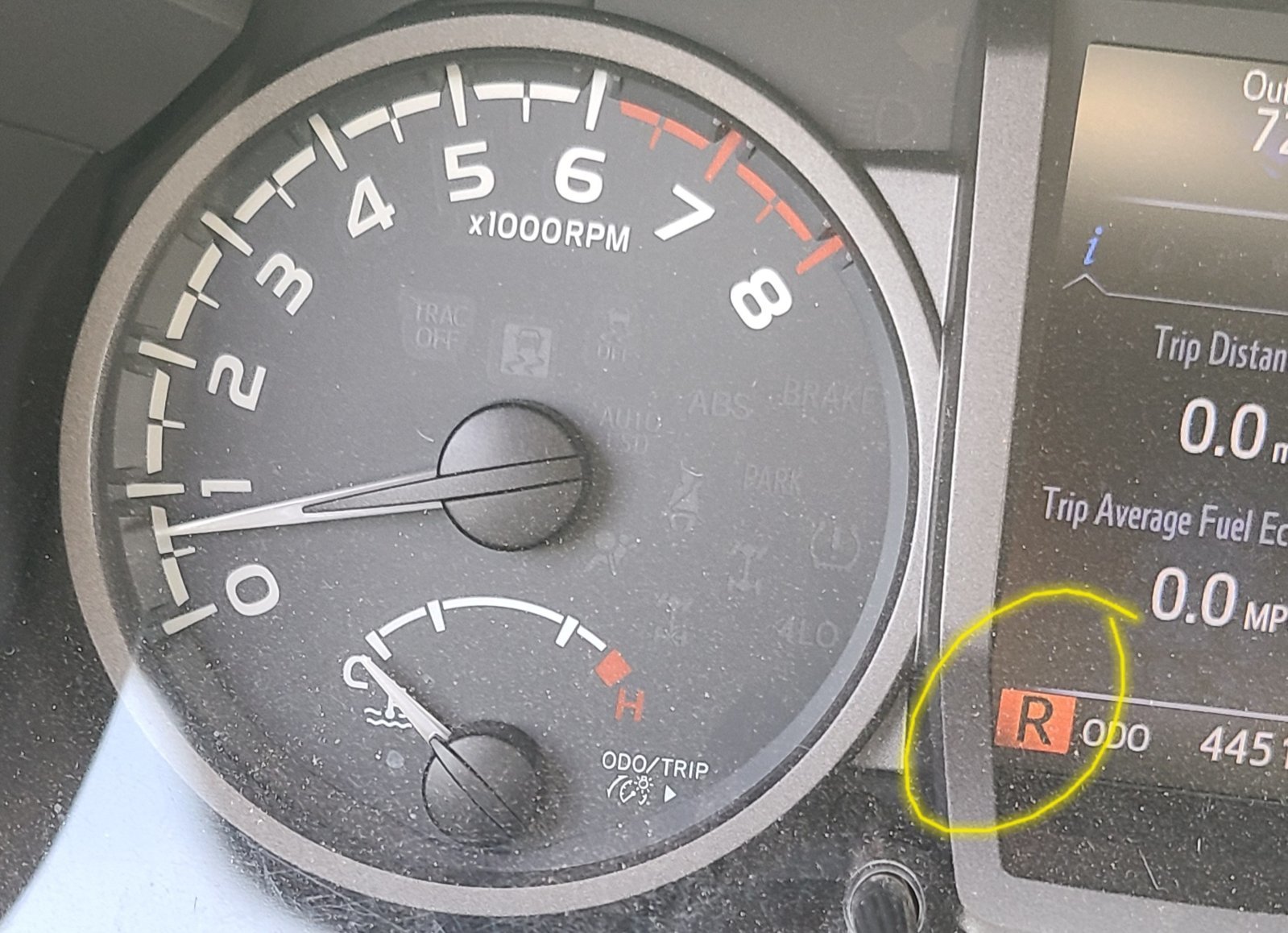

    Thanks for the reply. I deleted my AC and installed new oem belt that comes on the base models that dont have AC's. belt squeek only happens right when the RPMs drop to around 550rpm. belt is silent when is put under load and cruising. I do see that a lot of people have this low rpm issue, but they all fail to mention it only happens when the brakes are depressed at idle. perhaps they do not realize it because you wouldnt really notice unless your handbrake was on while in D or R. I'm just fustrated that i cant make sense of how depressing the brakes would drop the rpm only at idle, even if it is normal i would like to know why haha. my only other guess is maybe torque comverter related? I'm going to replace idler pulley and tensoiner bearing because well why not at this point...

    my tach is just slightly below where yours is but still above 500. thats where it used to be like yours and that little +50rpm im missing makes a big difference in vibration when in the range below 800-700. its enough where i have gotten two comments from passengers about the shake. as someone else said the 2trfe is a smooth idling engine. truck is lifted 1 inch, no diff/driveshaft drop, aftermarket control arms but this was a problem before all that. I might go test drive a 2.7 at a dealership to make sure im not crazy haha.

    This is normal behavior....I think it's part of both trying to minimize emissions and making the most out of gas mileage. When in drive, my 2022 cycles back and forth from a "normal" idle to a "lower" idle when stopped (like at a red light), and it does this like clockwork, which means its an ECU function. Just be glad its not a start/stop system.

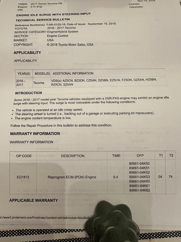

    Report from the mechanic…

    Your profile says you have a 2.7.
    That TSB in the picture is for the 2GR / 3.5 engine.
