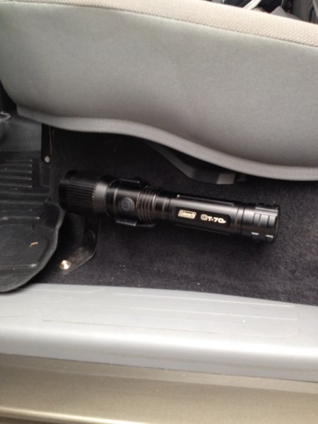

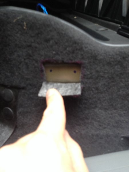

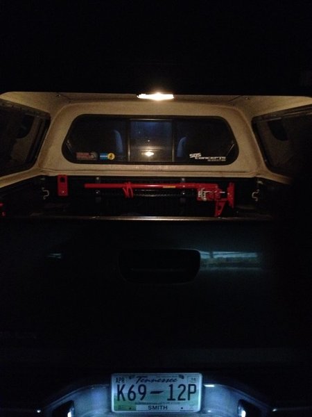

    Flashlight mod. I didn't like the idea if mounting it to the flimsy platic on the driver seat so I put it in the sheet metal below the rear seat. I cut the carpet, marked the holes, and ran a couple self-tappers through. It's sturdy as can be.

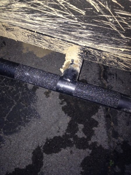

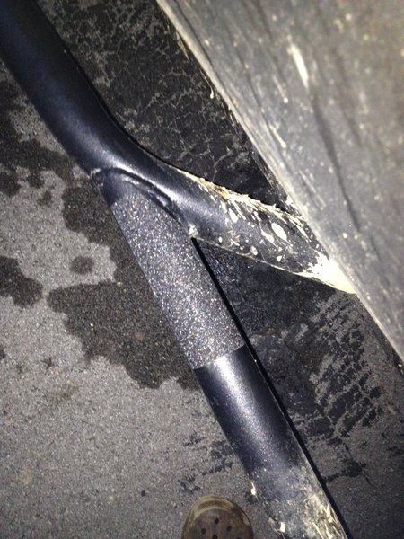

    I have nearly busted my arse a couple times getting in/out when it's raining and the sliders are slick. I'm going to give this a try. It is super gritty and seems very tough. Time will tell.
    I have quite a bit left over. If anyone wants some PM me your info and I'll mail you enough to do your truck free of charge.

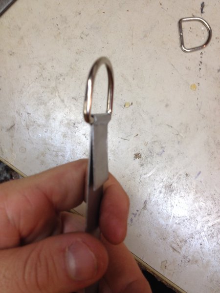

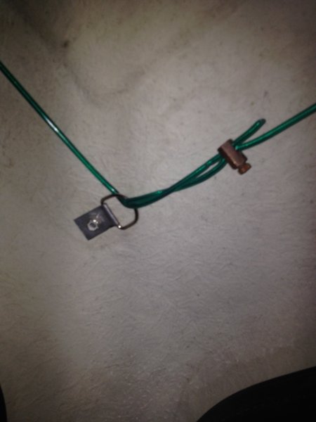

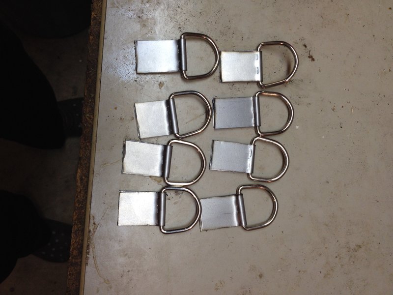

    Stage 1 of operation "No more shit rolling around bed". Thanks to @Crom for the idea for this one. https://www.tacomaworld.com/threads/the-getaway-croms-build-and-pics.362772/page-13#post-10592456 I duck hunt, ALOT. Which means I have wet gear laying around, ALOT. I finally have a way to hang it up to dry without leaving the truck. I grabbed some 1" D rings from lowes and a piece of 22ga sheet steel. Cut the metal into 3/4"x3" strips and bend them over the D rings with a vise like so.
    Then I drilled some 1/4" holes in the brackets so they will go on the bolts holding my roof rails on, and bolted them down. I used some clothesline wire I had laying around and some cable clamps.

    And here I thought I was being original with the grit tape. Should have known better. Ha ha. It is working as I hoped.
