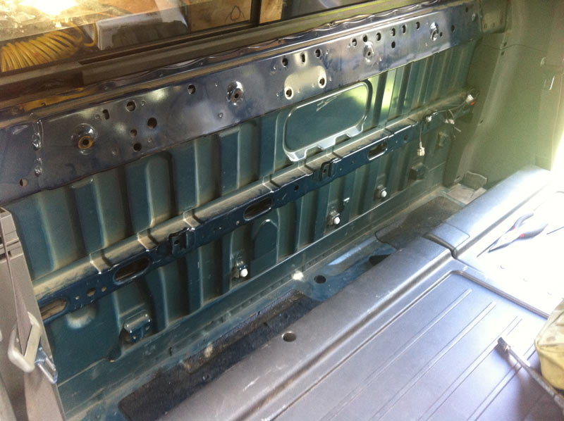

    yep - you are right. Now that you mention it, i think I remember seeing the vertical vent. Here they are on a 1st gen. Not sure why they redesigned and enlarged them other than maybe additional airbags? but they seem to be where the road noise is coming from.[​IMG]

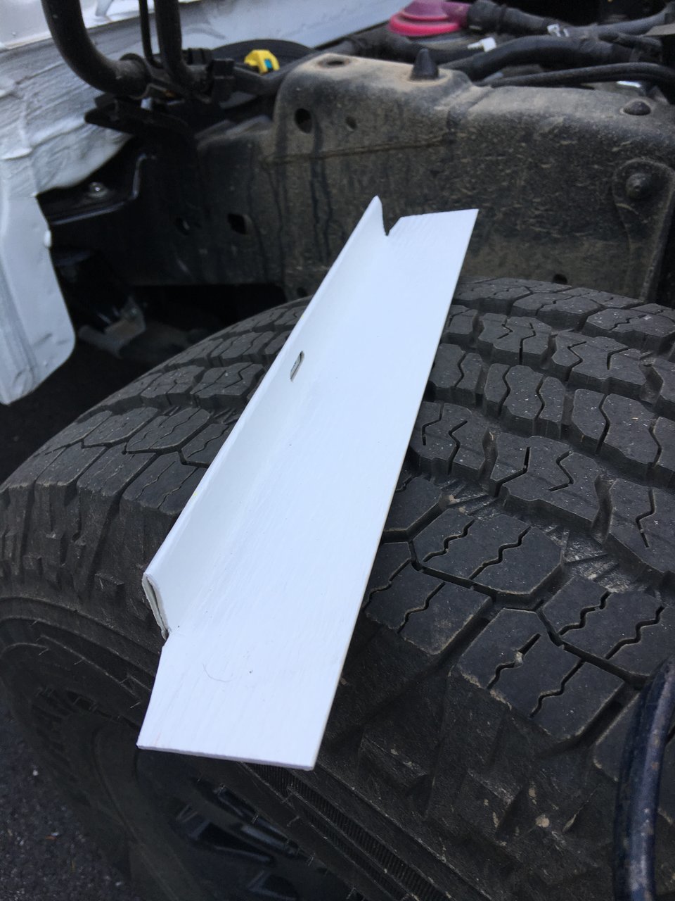

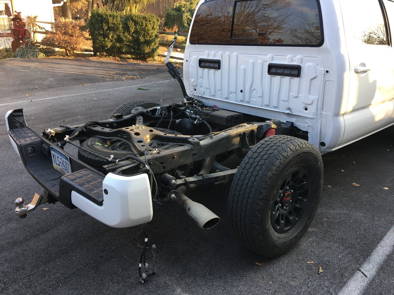

    You sir, are certifiable crazy, can't believe that you would remove your bed to fix a noise problem. How wild & crazy. I may attempt the same procedure.

    True statement! The noise has been reduced but I still have some. My next target would be to place foam around the seat hook openings into the cab (through the rear plastic panels/ bins).
    I would start there before removing bed.
