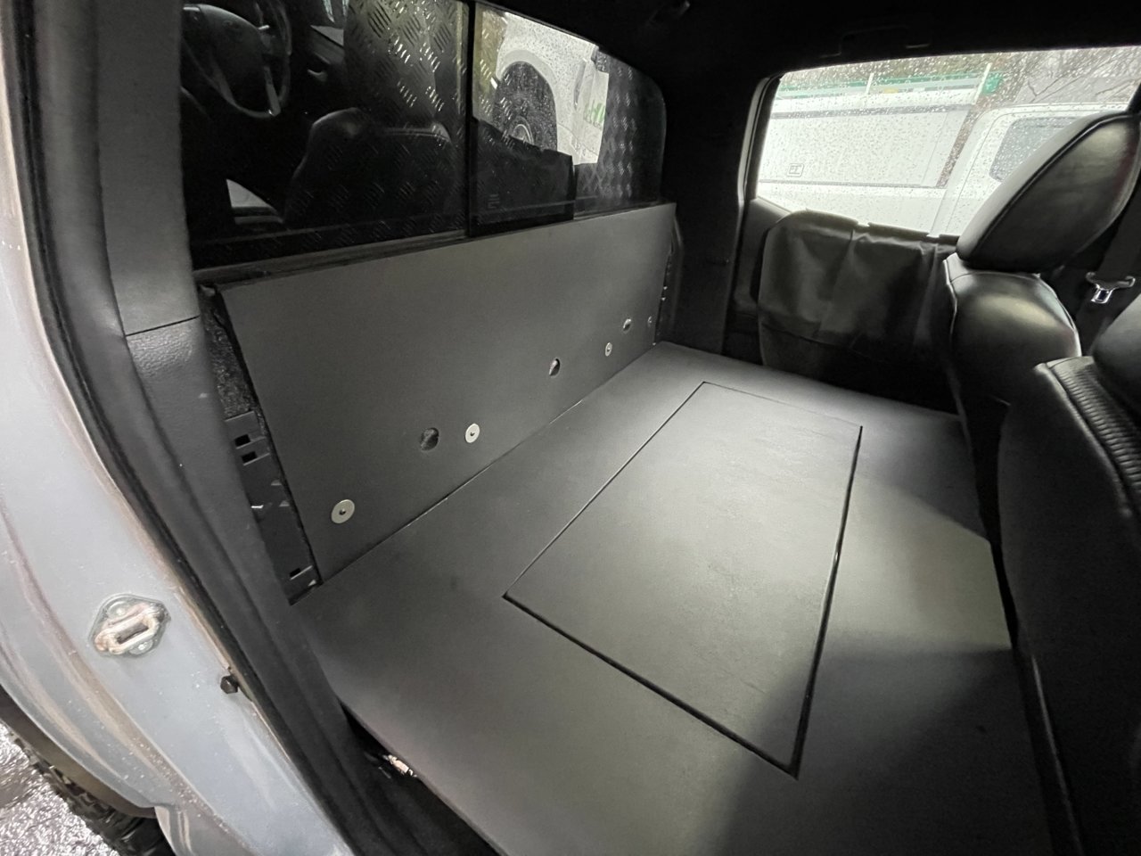

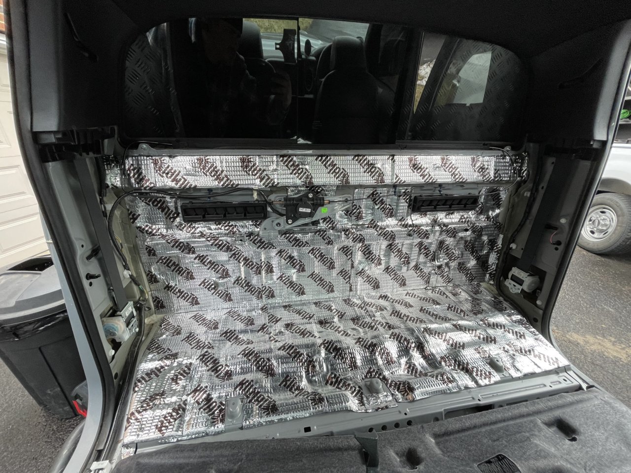

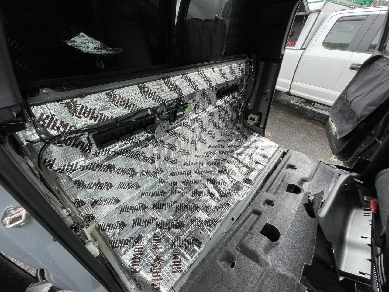

    Now that the snow has thawed and temps were above freezing for the weekend I had time for a much needed truck project.
    I completely covered the rear with 36 sq ft of 80mil Kilmat sound deadening to kill some of the road noise produced by removing my rear seats.
    Also rebuilt the rear seat delete panel for the dogs allowing for better storage underneath and giving the dogs about 8-10” more standing/laying room. Having the panel lifted also allows the dogs to see out the window better making them less car sick and I don’t have to roll the window down as far for them to stick their heads out.
    The panels are 3/4” Birch coated in paint and spray on bed liner.
    On top of the panel there is a easily washable anti-fatigue mat to give the pups some paw traction when things get crazy.
    I also removed the rear window control switches in the rear doors completely to stop the dogs from rolling the window down whenever they feel like it. Yes, they’re smart enough to do that...
