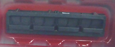

    I decided to go pro a short video. Apologies for it being a bit grainy. However here is what I noticed:
    The vent is divided into 4 channel pairs. A 1/8 (guess) thick piece of rubber hangs freely from the top of the channel.
    When I turned on the fan, the rubber was pushed back into an open position.
    When I turned on the defrost, the rubber opened fully.
    When I closed the door the rubber opened briefly.
    What I did find interesting is that because the rubber is hanging freely, it is affected by inertia.
    When I accelerated, the rubber opened.
    When I hit bumps, the rubber opened.
    When I turned the rubber opened.
    What surprised me most was when I turned on the fan and chose recirculation mode, the rubber was pulled shut. I was impressed with how much quieter the cabin was. I will try ricirc mode as part of my sound testing.
    **Remember I don't have back panels on, so I am assuming that my situation is more dynamic than others. **
    Here is a 1.5 minute video showing the vent in action. Please note that my speaking was only for my notes and not to share. I added some text where needed. https://youtu.be/GKBPycp4di4

    That video explains a lot.
    My 2006 Access cab was so much quieter, but on the 2016, definitely hear tons of road noise from the back, and now we know why. We know why we need this, but looks like Toyota went way overboard with the design.

    I don't notice much difference if any with the recirc on or off in my instance. Or the seats up or down (access cab). Thinking that perhaps the vents do not ever close fully in my situation. Only checking with panel off will tell for sure.

    It makes sense that the flaps would close with the recirculation on. The pressure in the cabin would be static and maybe even slightly negative at that point.

    I have the same issue. What I was thinking of doing is either adding Dynomat to the rubber flaps. This will make them heavier and in theory stay closed easier. This may cause then to be ripped off being heavier.
    Or replace the current thin OEM rubber flaps with a heavier rubber material that would lay flat on the vents just like the OEM ones does. These would also stay closed easier and would open when a door is closed of recirc is turned off.
    Thoughts?

    Il, try a couple more photos of the vent. Interesting you can pull them off from inside the cab. I can't figure out how to remove them. Depending on the distance between the cab and bed, you may be able to inspect/ change from there

    When I was messing with my vents, I tried to remove then from the inside....NO GO..!! Looks like you gotta remove the box..!
    I pushed the tabs and slid the vent to the rear, but could not get it thru the hole to the inside...!!

    I'm sure they were installed at the factory when the bed was off. :(
    I think the heavier material will prevent quick equalization of cabin pressure...when a door it shut, window rolled up or HVAC fan tuned on. Toyota has been using this type of flap material since the stone-age for a reason....it works....albeit a bit noisily in the '16. :thumbsup:
