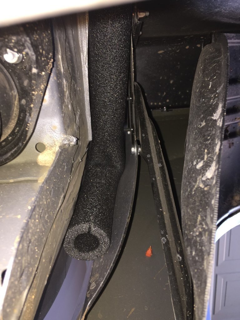

    Hi ; with continuing attemps at noise from vent issue ; I think Zinger asked if anyone tried blocking one of the vents and I tried the drivers side , being I heard most noise over my shoulder towards rear ; I stuff a piece of armaflex black foam pipe insulation on outside between bed and cab covering vent and only short test ride so far ,. seemed to show about a 50% reduction ; I'll observe again in am. on way to work ; cooler temps seem to be louder . John

    Hi Mike, I like this idea because I have road noise also I am trying to get rid of, I looked at my cab and bed and it looks like it has a bigger space, and its hard to tell from your pics but does the foam rest on that ledge? Also will it stay in place ? Also have you done anything with the vents or the inside, I thought about insulating the inside or close the vents off partially but taking the back off behind the seats look likea pain, I can't get those caps off where the bolts are behind. Any ideas on how to get them off without destroying them and nicking them up. Thanks Robert

    Hi, Does the foam stay in place? I want to cover up the vents or something but its a pain to get at them. I wish there was a better way. I just worry about the foam fling away. Thanks Robert

    Couple thing. I put the pipe wrap across the width of the truck at the bottom and at the top, wedged between the cab and truck bed. Used 3/4 foam insulation. Reduces some noise and defiantly won't fall out, it's wedged in good. Pulling the back wall off the truck is real easy so access to the vents is a snap. Best of luck y'all.

    Same, pipe insulation is just stuffed in there.

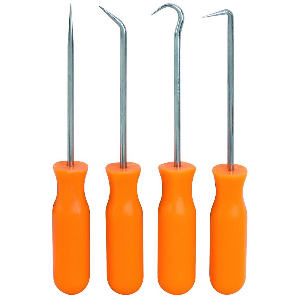

    Thanks, I did see those video's , I have access cab also. How did you get those little panels off that cover up bolts without scratching them up or damaging them, is there a special tool ? I don't want to start prying them off and break or mark them up ?, how did you do it. Thanks Robert
  18. Aug 31, 2017 at 4:37 AM
    #98
    RCrumb
    RCrumb Dumb as Dirt
    Jun 26, 2016
    #190578
    137
    CANADA
    2020 TRD OR Premium-Auto
    I used a mini hook and pick tool bought from Harbour Freight. Here's a pic. Left a tiny mark at the corner of each square cover but IMO it's fine. Your call obviously. I'm sure there are other options.
