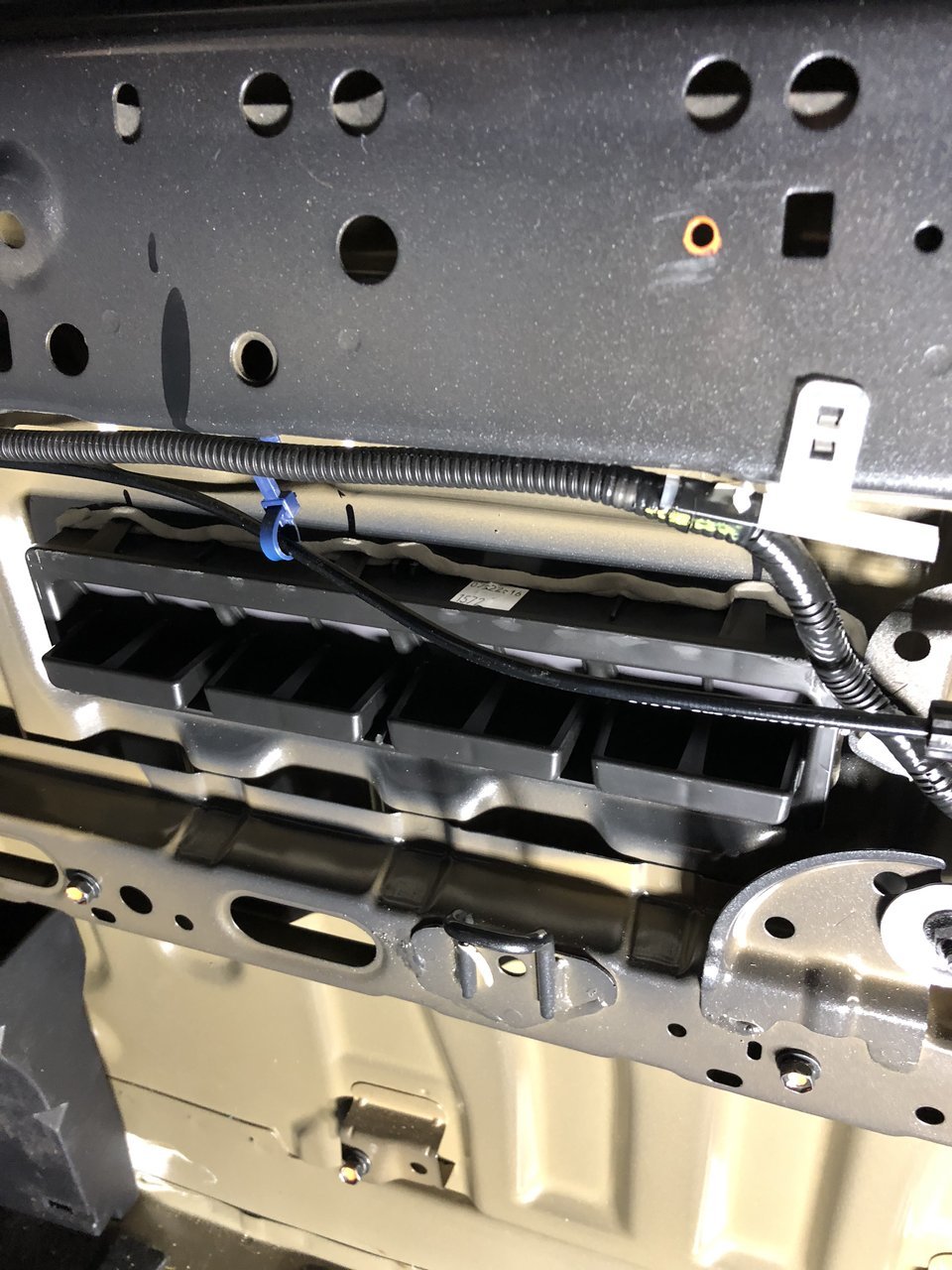

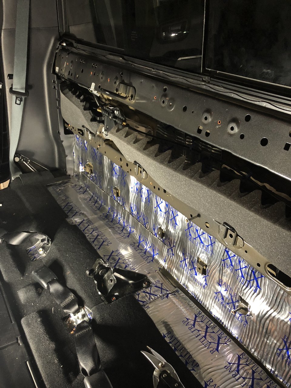

    The foam is great and I think it’s the best option. The stuff I used is flat on one side and has peaks/valleys on the other. I experimented with both orientations towards the vents.
    The flat side towards the vents disrupted air flow and actually did not reduce the noise level - merely changed its pitch.
    With the peak/valley side towards the vents the noise level is decreased by at least 75%. I like to think that the recesses allow enough airflow and that the angles (think stealth technology ) disrupt the sound waves.
    Bottom line is it works perfectly and I have not experienced any negative effects such as increased cabin pressure or fogging. BONUS: my tunes sound better too!

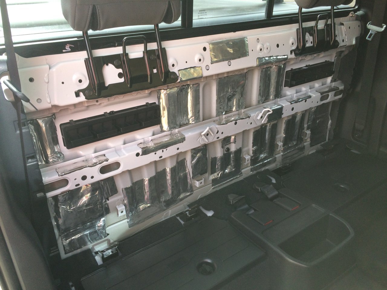

    I added some CLD tiles and Ensolite to the back wall. It made a huge difference.
    TacoPandaTRD and trazerr like this.

    How thick is the Ensolite stuff? That’s the black closed cell foam, correct?
  15. May 3, 2018 at 12:31 PM
    #135
    COdude3
    COdude3 Well-Known Member
    Oct 26, 2016
    #200711
    205
    Colorado
    2017 SR5 Access Cab 4x4
    Pro Grille, Pro Whls, King Shocks, 265/75R16 A/T3
    I believe 1/8" and double layered. I bought it from RaamAudio.com
  16. May 3, 2018 at 12:46 PM
    #136
    trazerr
    trazerr Well-Known Member
    Jan 8, 2015
    #145900
    973
    Oregon
    2024 Tundra Plat 4x4 LB (prev 2018 DCLB SR5 4x4 and 1996 AC LX 4x4 5sp)
    Awesome, thanks. About how many sq ft did you use for the back wall?
  17. May 3, 2018 at 1:20 PM
    #137
    COdude3
    Oct 26, 2016
    #200711
    205
    Colorado
    It comes in 1yd sheets. I bought 2 and had plenty left over.....but I also double layered. If you only single layer, 1yd is plenty.

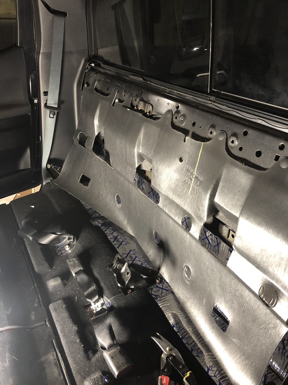

    Awesome, thank you!! Yes, I’m going to put down some 80mil sound deadener first. Then I think I’ll do a layer of Ensolite. I’ll extend the sound deadener down under the rear seats as well as into the c-piller .

    My plan exactly with using MLV in a few days. Glad to hear it would be an effective solution with those vents and won’t lead to pressure issues.
    To confirm before I assume, your saying you went right over the two vents with MLV?
