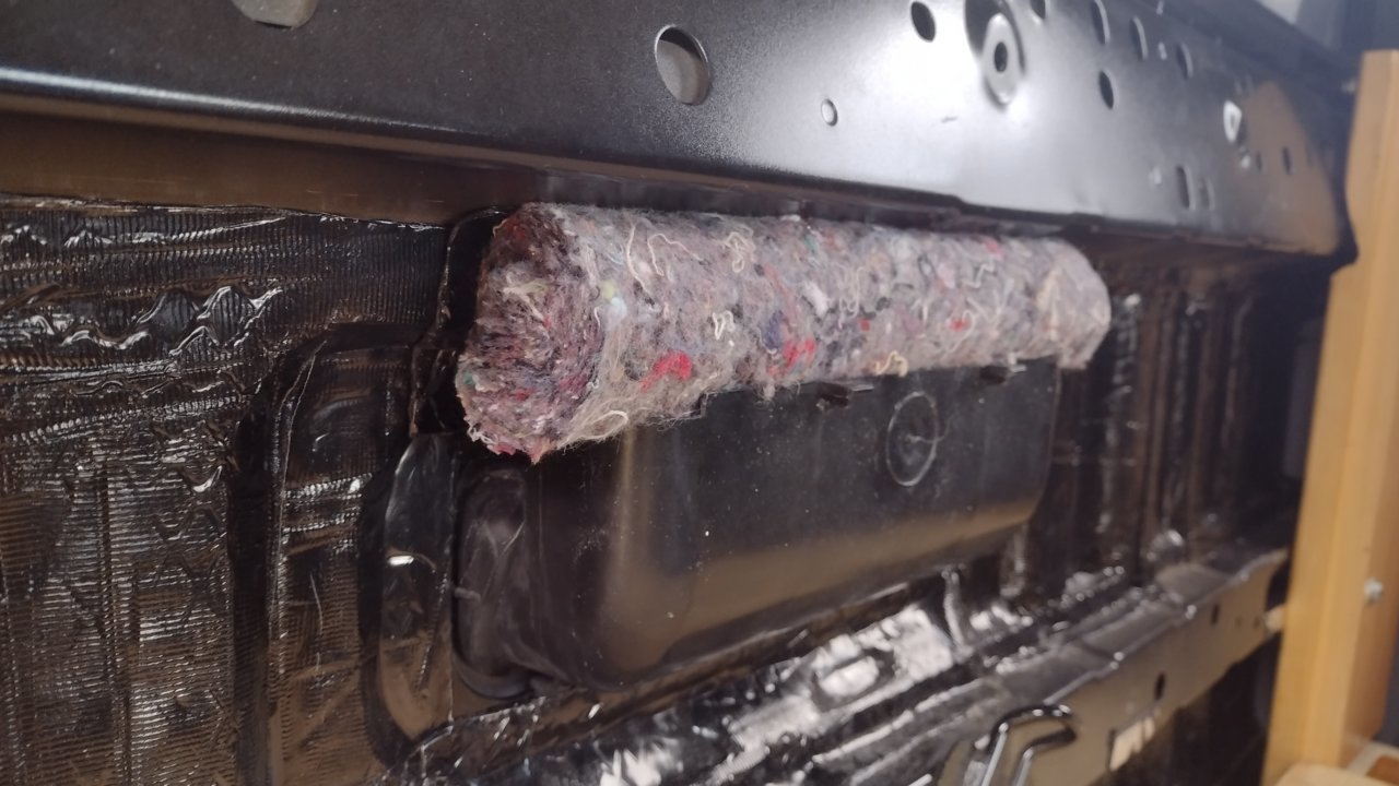

    2.5 gen has a single vent, the factory back panel has a 3/4" jute cloth that wraps around the vent to reduce noise - here's my solution, I cut off a piece of the factory jute cloth and wrapped it around the vent, jute lets air pass but reduces sound, will be taking on the highway tomorrow, I'm pretty optimistic about it. FWIW I'd say a box of sound deadener is worth the investment, you can do the back wall and both doors with a single box.
