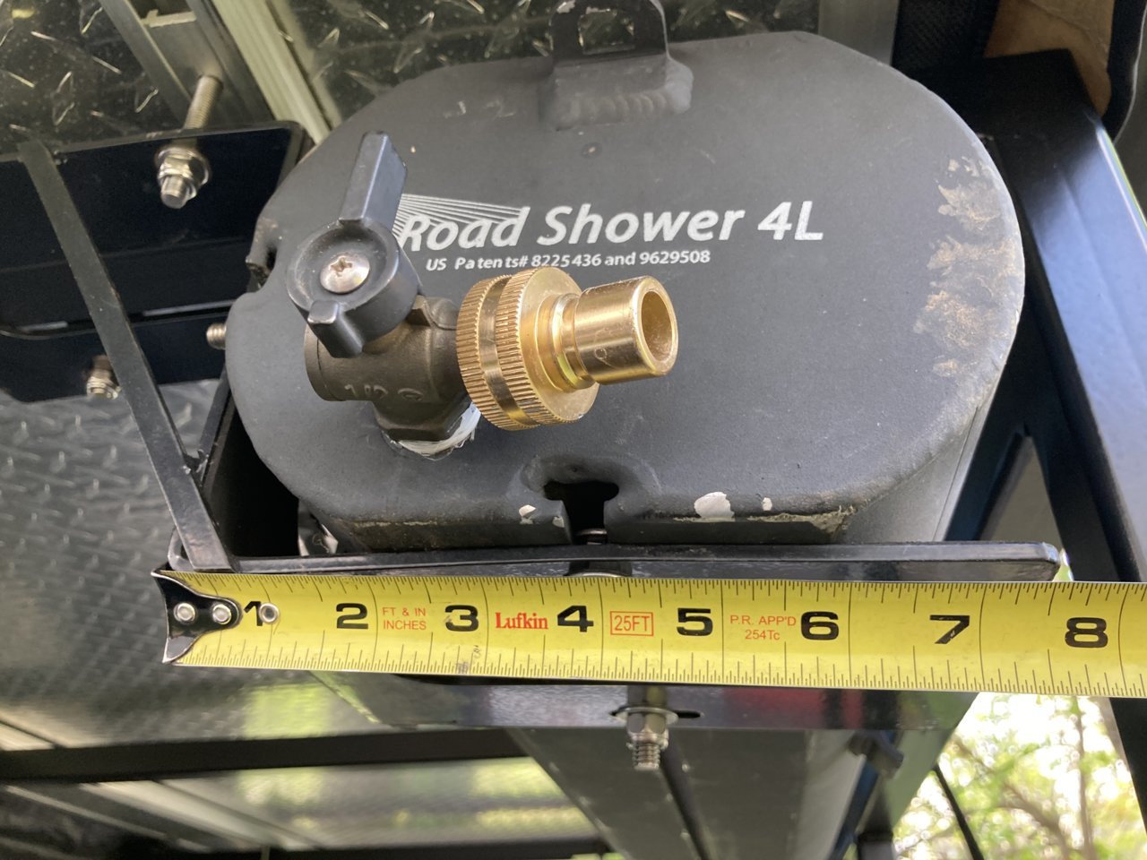

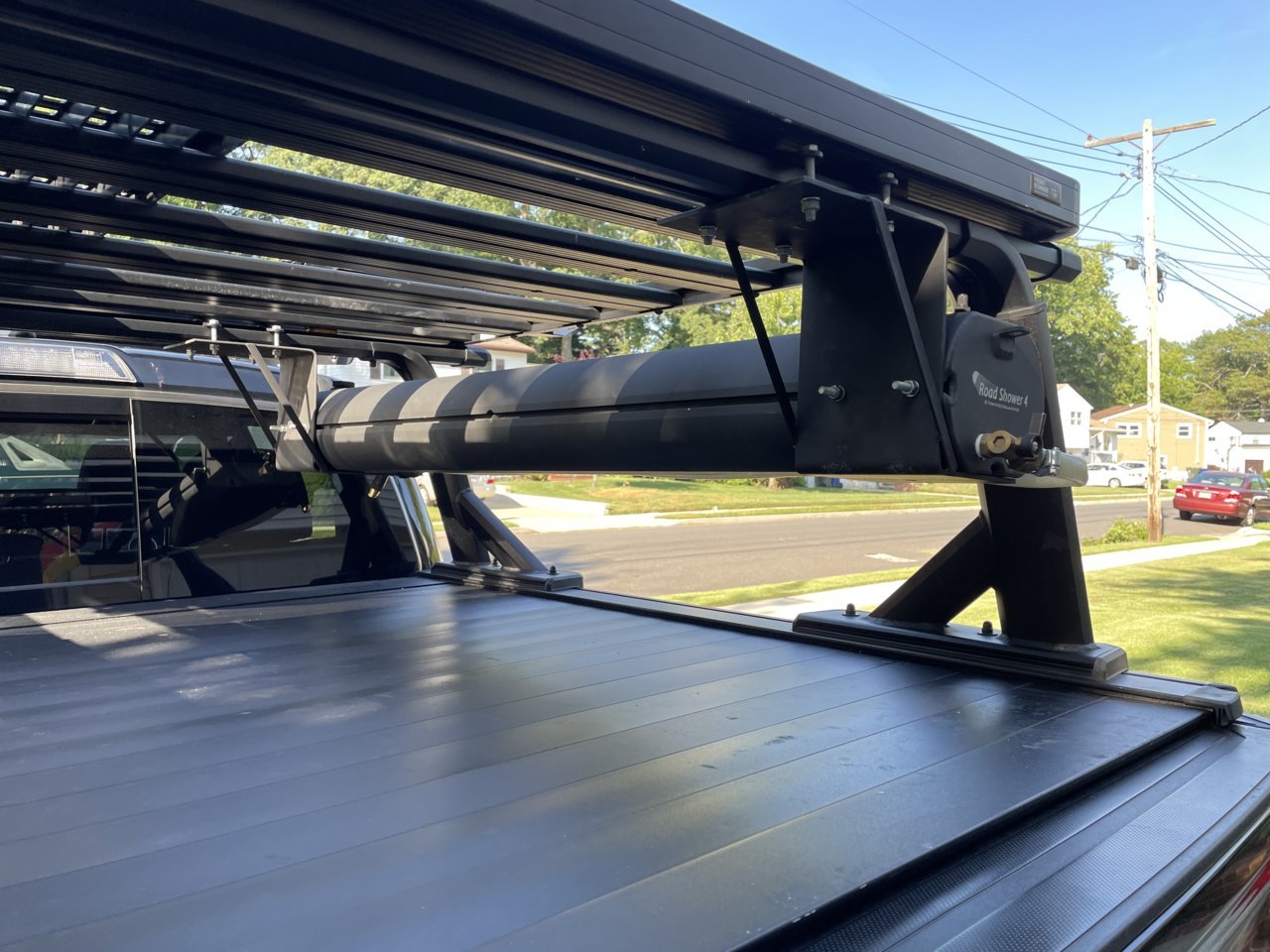

    I appreciate that, but really just some straight on photos would be really great. Can extrapolate from that. Appreciate it if you can get to it!

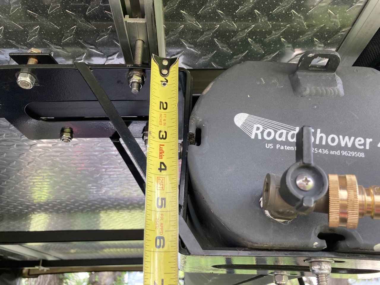

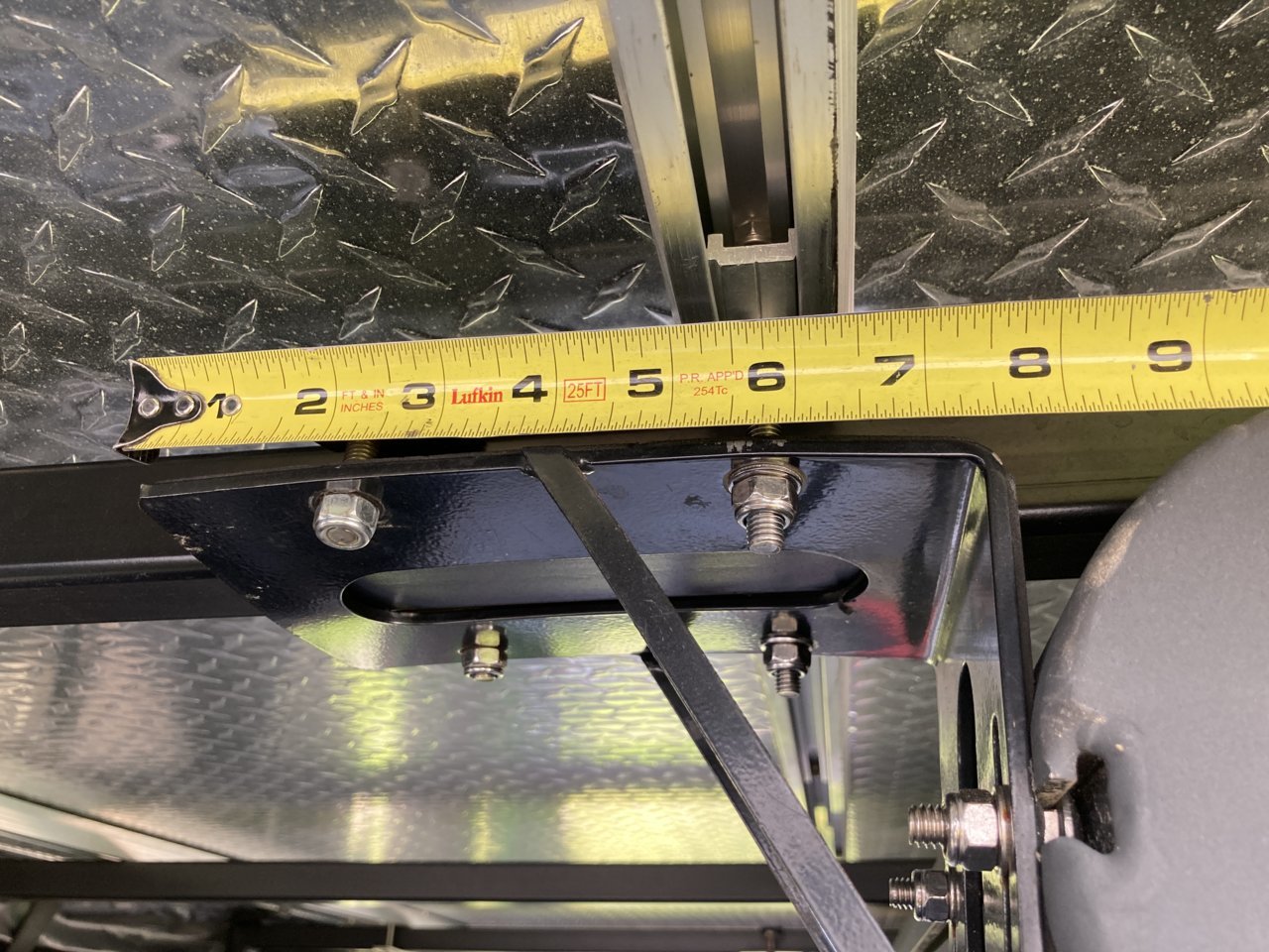

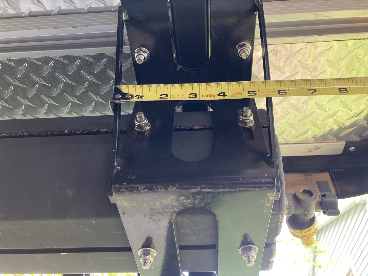

    Hopefully these help.

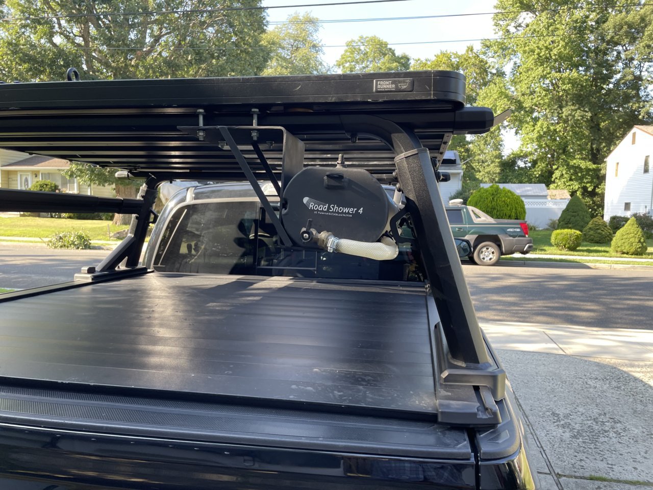

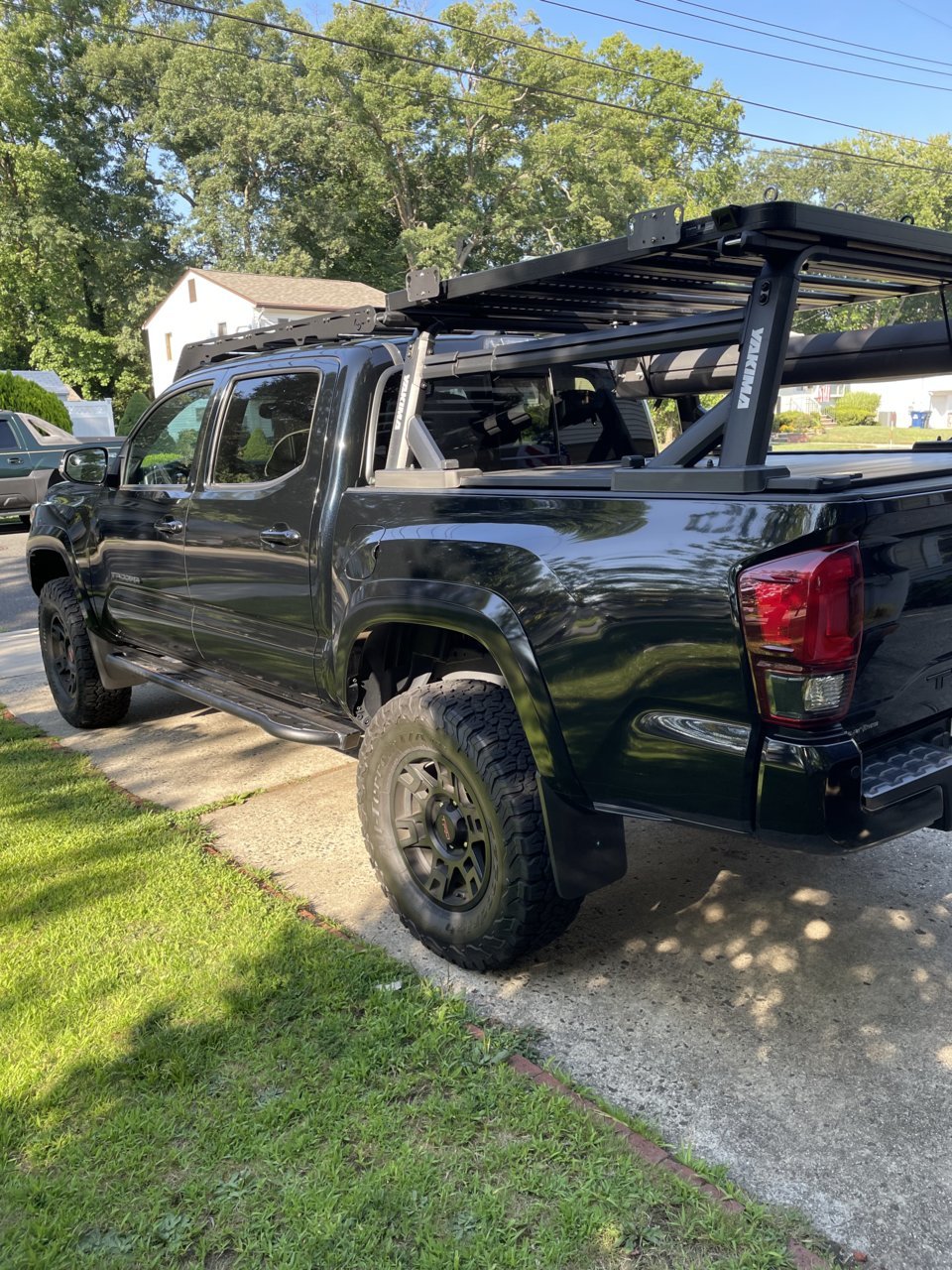

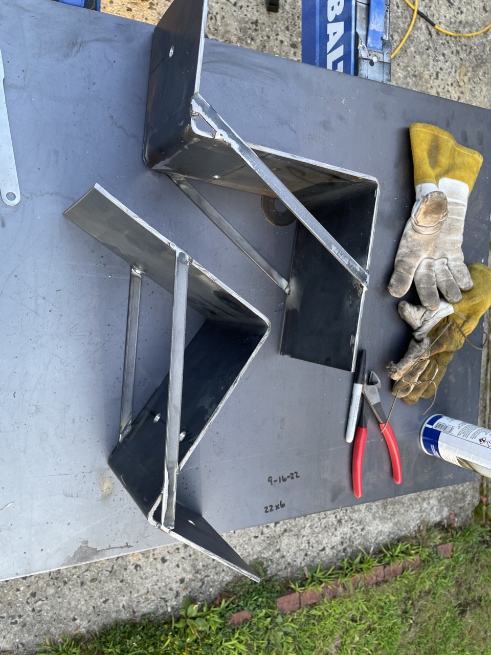

    Yeah made my own. 3/16 sheet and bent. And reinforced like stock one

    looks great! I’ve decided to build my own shower out of 6” pvc and tuck it underneath my tonneau canister.
